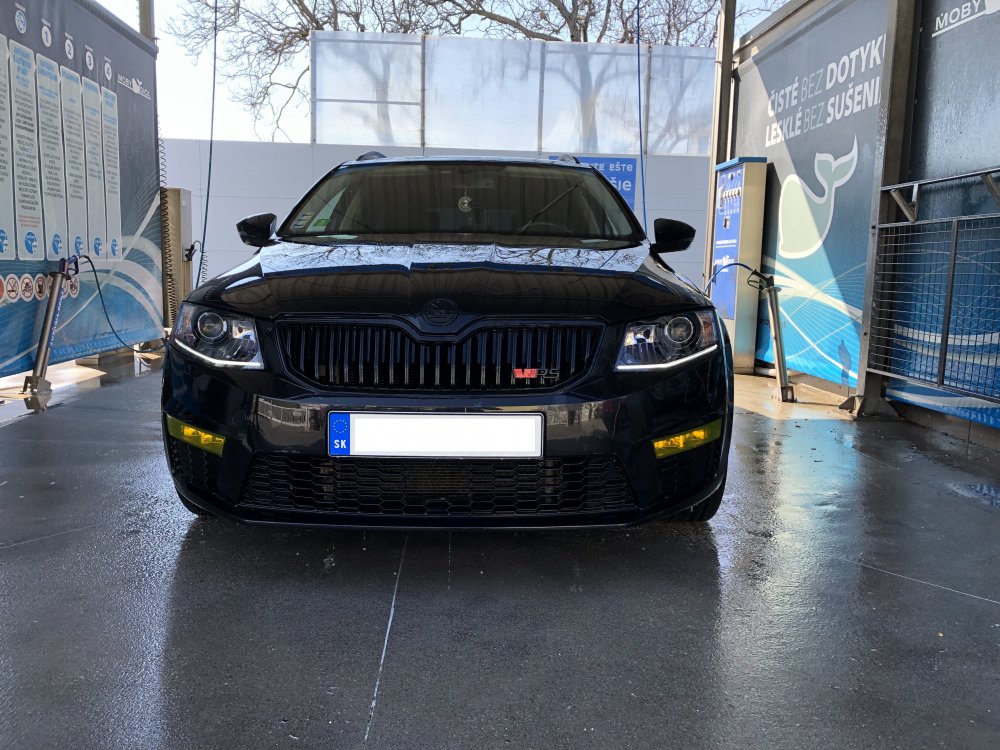

  8. Although what is written in the title is not entirely my case, it should help. So I put an aftermarket headlights into my car and now on the pin where used to be halogen daytime running lights is LED strip. Can somebody please share coding for changing DRLs bulb to LED, so I can get rid off error message on dashboard? Thank you.
