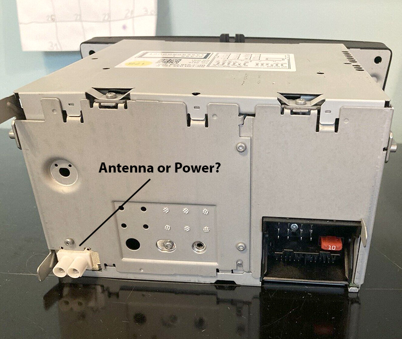

  11. Looking at other threads on BT modules I take it I haven't got one fitted as when I press the Phone button it just mutes? Also is this white connection power or antenna, as I said the Bolero is a double whereas the Stream and my car has only one round connector?
  12. Hi All, Hope I can get some advice on a newly installed Bolero in my Octavia 2008. So how I got here, current Stream was popping, shutting off and on, was making a weird cycling noise when keys were out so I bought a Bolero from eBay, installed, got a code from eBay and working. Problems - The bluetooth is selected on but phone doesn't find it so taking this is only available on later spec cars? The factory fit AUX that worked with the Stream now does not work - the AUX on/off selection button is not in the Media section unlike Youtube videos showing it on the Bolero When I turn ignition off it acts similarly to the Stream as in shutting on/off/glitchy so could I have a bigger problem with say the CanBus? Not so much a problem but when plugging in the wires I noticed the Bolero has 2 round white connections next to each other like a shotgun whereas the cable in my car has only one single round connection? Hope some of you help and how you got past the same problems if you had them. Cheers.
