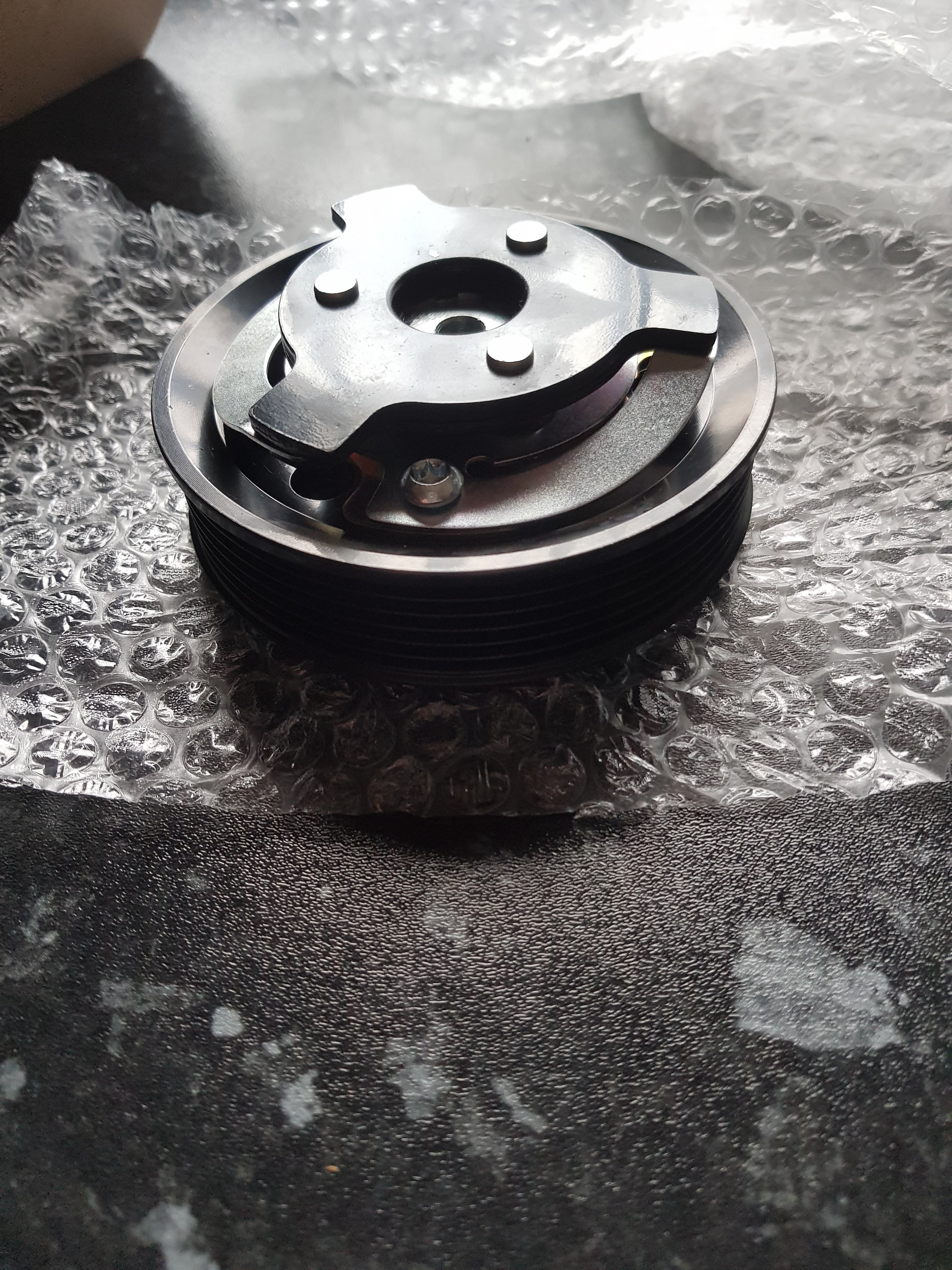

I suspect you are correct...this is what was replaced:
Good advice on a garage...
Yes that is a shear plate, its relatively easy to see if the hub has stripped, run the engine (AC on or off, it does not matter) and with a bright light look down, you will see the shear plate rotating but the centre nut will be stationary, if its turning then it has not stripped.
Another one is cheap, £20 or so and not too hard to fit if you want to give it one last try yourself using loctite.
The noise that you heard is the giveaway, it can be like a tinkling of broken glass and is audible if you stop at traffic lights with a wall or shopfront on that side, more apparent to me driving on the right side of the road but it could be reversing onto your drive etc.

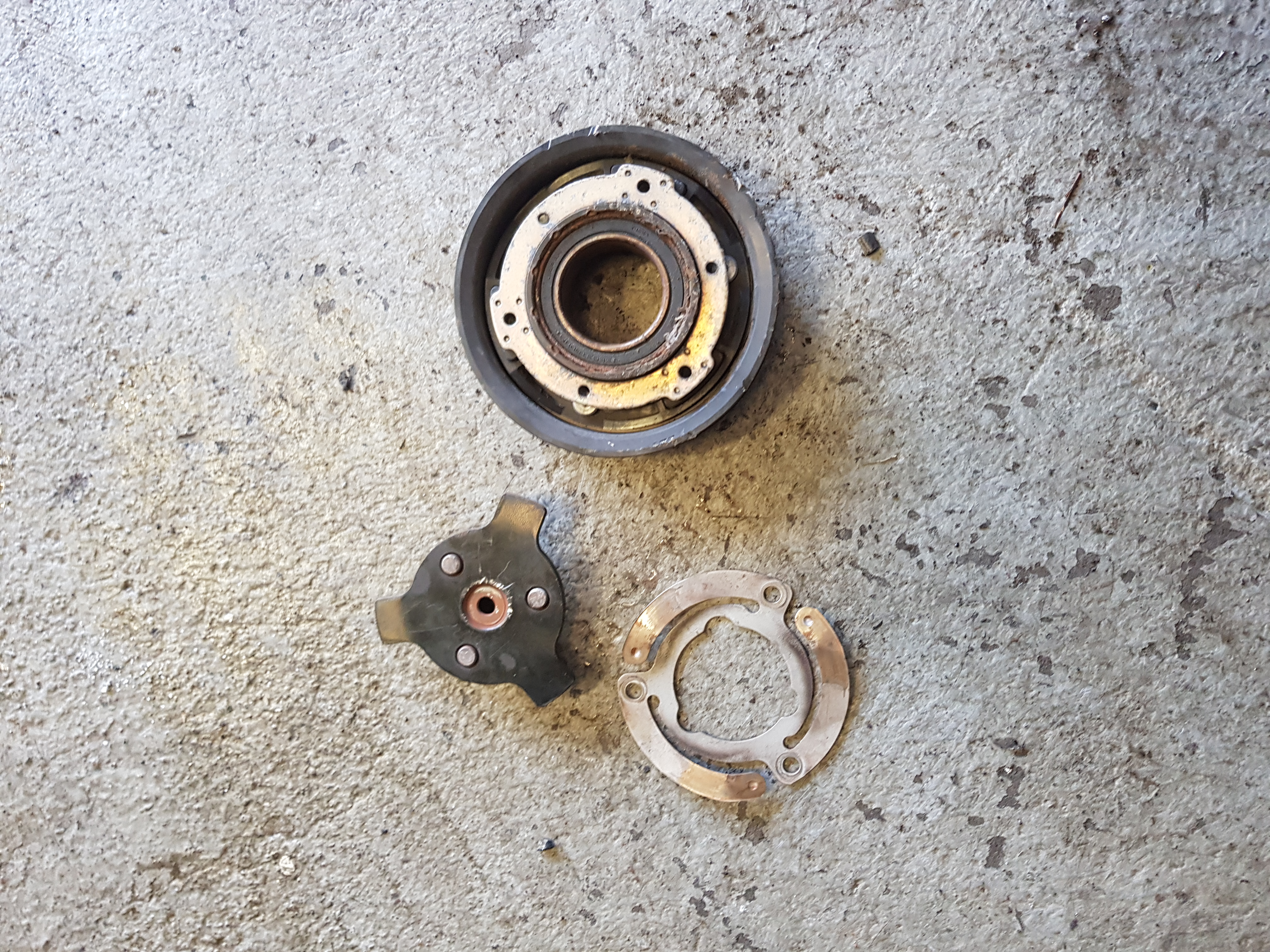

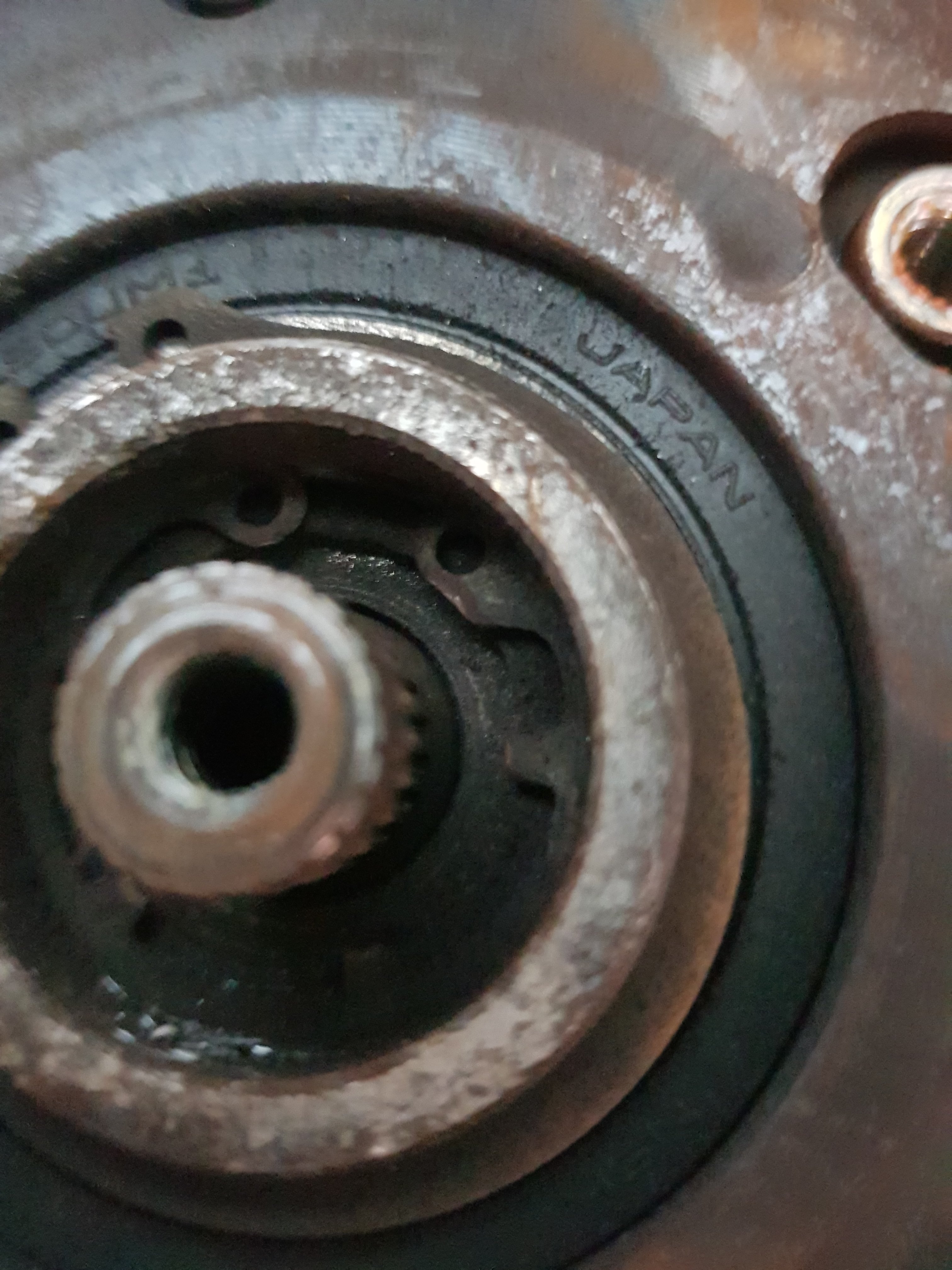

I wanted to update this thread...I finally got a chance to check the compressor and I can confirm that one of the shear plate straps has broken. I attempted to remove the plate and in the process, messed up one of the hex bolt heads :speechless:. I tried using a bolt extractor tool to remove the nut to no avail, there wasn't enough depth in the bolt to get good contact. Its awkward enough working in the driveway using axel stands and my gut tells me that I should bring it to a pro. The new kit I got included a hub..what are my chances of drilling out the bolt, binning the old hub and replacing both the pulley and the shear plate in one go? Is there a circlip holding it in place?
Edited by CJay
I just checked my spare pulleys & hubs, yes you can do what you propose, the hub has to be removed to access the cirlip retaining the pulley & bearing.
First job is to remove the centre hub shaft nut while you still have something to hold onto, hopefully the splines wont be stripped, if they are then its really difficult in situ & with limited tools & once I managed to bend the pump shaft, its a very small diameter.
As long as the pump shaft can turn freely when the hub is removed you have a very good chance of doing an effectve repair, use some bering fit or whatever on the splines as one of my new compressors stripped its hub & the same happened to its replacement which appeared to fit well, probably made of cheese.
