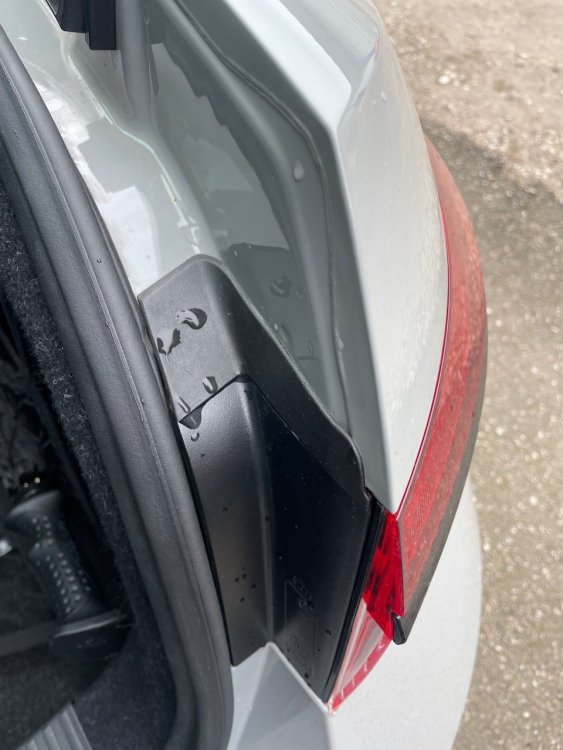

Hi all, Purchased a 22 reg superb hatchback last year. Had a nightmare with a leaky windscreen which was rectified. However I've noticed that my rear windscreen is extremely prone to steaming up, interior of the car is bone dry, no water in the spare wheel well or any wet carpet and or headlining. However I did notice the plastic trim and rubber in the boot gutter area was incorrectly fitted and so there was a gap which water would of been free to flow down (see picture). I've since refitted this and the rubber seal sits nice and flush. But I was curious where that water would have gone?? As I say the boot interior is bone dry, but I'm thinking there's water somewhere that's causing it to steam up still even after sorting out the seal (or there's another issue). Would I be needing to remove the side panels inside the boot to gain access and therefore dry out any water that may be in there, and if so how does that panel come out? Any help appreciated.

Spoke to the dealer this morning and they want the car for a couple of days to investigate. Unfortunately, the earliest they can get it in and offer me a courtesy vehicle is 2 weeks time. As this is our only car and needed daily a courtesy car is essential. Thanks for the part number, found online for around 30 euro so will ask the dealer about supplying one.
Morning all, I purchased a used approved 22 plate Superb Sportline 2 weeks ago but it's not exactly been smooth sailing since. After a few teething issues, admittedly mainly user error, I was starting to really fall in love with the car. Unfortunately, it hasn't lasted. Since having it, I'd noticed that it was prone to steaming up. The dealer applied some form of interior protection product as part of the deal so I was quick to tell myself between that and a mixture of being stood around on the forecourt and short trips with little to no A/C drying and that after a few days of nicely drying out with use it would sort itself out. However, it seemed to be getting worse. The recent dip in temperatures found heavy condensation build up and upon closer inspection while cleaning I found the drivers side carpet quite wet. I previously owned a 17 Octavia Vrs and had a nightmare with a leaking windscreen so I'm quite paranoid about such things now. Anyway, it's wettest around the foot rest/tunnel but when I peeled up the small perforated flap area under the seat I noticed it's wet under there too. So I'm guessing either cursed and I have ANOTHER skoda with a leaky windscreen, or the A/C drain or possible sunroof drains. My question is, my previous Octavia developed this fault outside of warranty so I stumped up for a windscreen replacement (via insurance). But, would this issue be covered, either by the remaining manufacturers warranty or the 12 month used approved warranty? Also, I appear to have lost one of the small black trims from near the fog lights (see pictures) ironically the remaining one I noticed was loose while cleaning and was going to look at fixing better. Does anyone know a part number or at least what it would be called and where would be best to source one? Thanks in advance.
