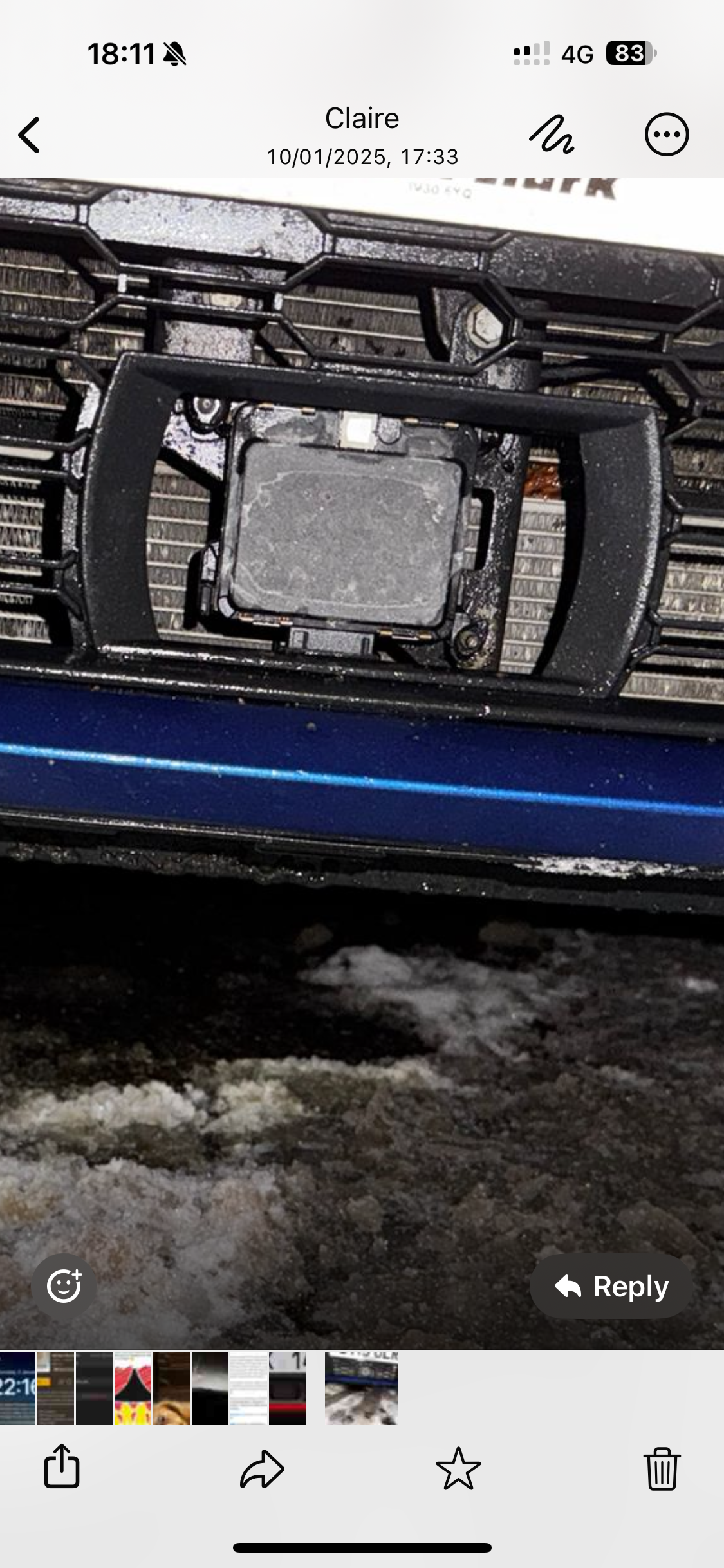

  5. Hi yeah I’ve 2 cars. Still have superb but wife has the Fabia. She hit the deer. I’m not fussed about how difficult it is to calibrate as I’m not needing it to be as accurate as I’d need for ACC. trying to work out the part I need to order to cover the sensor again before I straighten it and calibrate it again.
  6. Thanks for the reply, yes it does look a bit off to the side so likely bracket is bent. Ill know more when I get some time off in daylight and weather improves.
  7. Hi folks. Looking for some help here. Hit a deer last night (it survived!) since that tho there is a warning saying “front assist unavailable” now the car is a Fabia Mk3 colour edition and has not got ACC only front assist is for collision breaking. please can anyone tell me if I’m missing any part of the assembly on the front of my car?

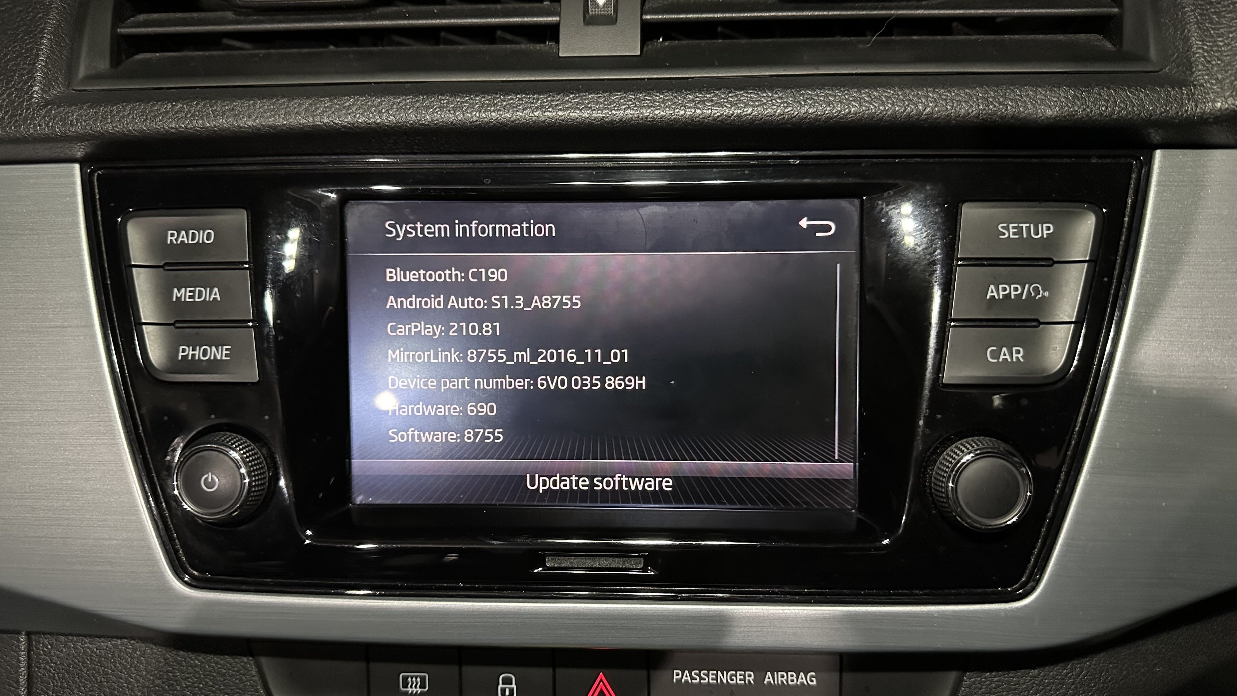

  8. Found the only solution. Bought a cheap wireless carplay adapter to make my connection wire free and its working finally.
  9. Hi, yeah I’ve done every reset imaginable. Plus ŠKODA themselves done a full system reset and FW upgrade. Still not working. 😩
  10. Hello folks Ive got a 1.0TSI Fabia III colour edition 2019 Since buying it second hand I’ve never had the microphone work when connected via Apple CarPlay, having CarPlay is one the reasons I went for such a new car as it’s a work horse. Bought new genuine Apple cables, tired multiple iPhones inc the new iPhone 15 with USB C port. Had it back to ŠKODA for diagnostic and they upgraded the firmware to the latest version but informed me the SD card didn’t work, not an issue as I don’t need it to work but could be a contributing factor with my head unit issue. When using basic Bluetooth connection to head unit the stereo works fine with no microphone issue. So fail to see this being a hardware issue. When leaving ŠKODA after diagnostic they told me it was as far as they could take it and they couldn’t find a fault but witnessed that the microphone was still not working. I went back to the dealer I purchased from who have been great in customer service, I asked them what the next steps were. Due to life issues some months lapsed and I couldn’t tolerate the no mic issue anymore. I contacted the dealer and they arranged for it to go back to ŠKODA for diagnostics even after last time not finding any issue with car. A couple of days later it’s back from ŠKODA and still they find no fault even after I prove time and time again the mic doesn’t work while using CarPlay. I'm at my wits end with it and looking for help. Can anyone relate to this issue and have a fix? I’ve attached image of head unit with details on screen. Any help would be greatly appreciated thanks for reading.
