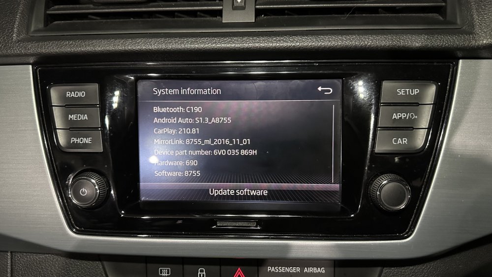

  4. https://a.aliexpress.com/_EI9Wmbq i just got this one off AliExpress but literally any of these CarPlay wireless adapters will do as they have their own firmware so it’s not relying on the car head unit anymore which is where the mic issue seems to come from for me. You can also find them on Amazon by searching wireless CarPlay adapter.

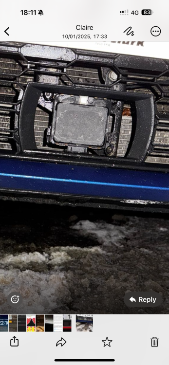

  5. Hi yeah I’ve 2 cars. Still have superb but wife has the Fabia. She hit the deer. I’m not fussed about how difficult it is to calibrate as I’m not needing it to be as accurate as I’d need for ACC. trying to work out the part I need to order to cover the sensor again before I straighten it and calibrate it again.
  6. Thanks for the reply, yes it does look a bit off to the side so likely bracket is bent. Ill know more when I get some time off in daylight and weather improves.
  7. Hi folks. Looking for some help here. Hit a deer last night (it survived!) since that tho there is a warning saying “front assist unavailable” now the car is a Fabia Mk3 colour edition and has not got ACC only front assist is for collision breaking. please can anyone tell me if I’m missing any part of the assembly on the front of my car?
  8. Found the only solution. Bought a cheap wireless carplay adapter to make my connection wire free and its working finally.
  9. Hi, yeah I’ve done every reset imaginable. Plus ŠKODA themselves done a full system reset and FW upgrade. Still not working. 😩
