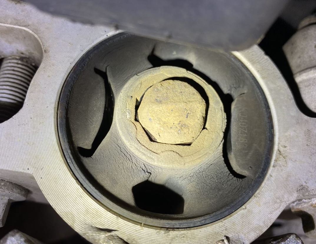

  4. @MicMac One top mount is from 2017, the other was replaced a few months ago to see if it helped - No change. @PipH Both replaced last year in a previous episode of find the knock, no change, and they are mighty tight. Ive had a loose joint on a drop link before, this is a different noise. @Me-109 Ill need to price up my options, polybush sounds good though, the cars got 122k miles on it, sadly theres probably a lot of it needs freshened up :( Whatever it is its only able to knock under free wheel or very light braking, when Im accelerating or braking hard it tends to be ok, which is why I suspected it was likely the arm bushings. I strapped the camera to my other halfs Scirocco yesterday and drove it in the same way, I cant say theres any real difference in what I can see there, just no knock on hers! This is the bush on one side, both are similar, I can see it looks a little tired with some cracking, but is this done? Car is jacked up and wheel off the ground.
  5. Between 20 and 30 seconds I was rolling slowly and lightly tapping the brakes, as I can hear the knock when doing this! Would you think the front bush is tired? Is that a lot of movement in it? I am tempted to just replace the whole arm-bushes-ball joint but sadly it’s reasonably expensive so want to be reasonably sure one of these things are my problem! my other half has a scirocco with the same sort of suspension setup, may strap the camera to it today and see how it compares being driven the same way
