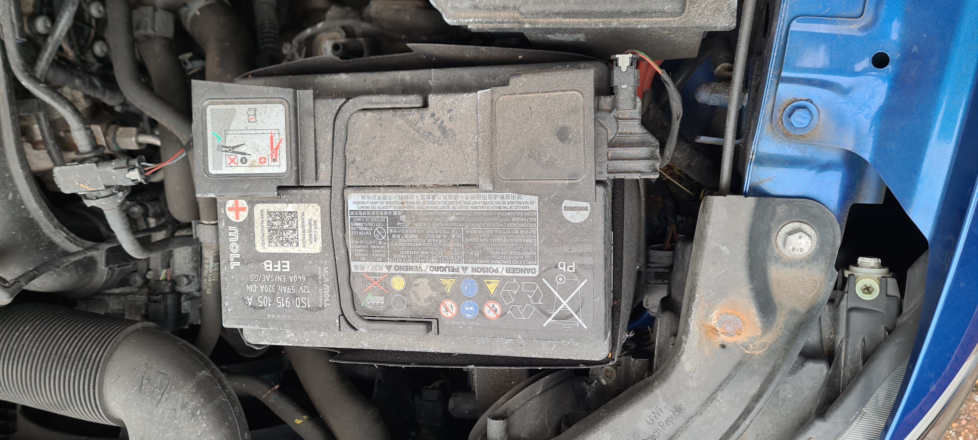

Battery changed today. Starts no issues. Can't road test today as the drive is being repaved. Should be OK tomorrow. I may look up a member to code the battery just for peace of mind. DIY option of buying Kit and using App looks to be same cost £40ish)

Hi Thanks for the reply. Up to two days ago never had any issues with starting or battery. Start\stop has been active with no issues. Drove 2000 miles to France a few weeks back and a 500 mile weekend trip a week ago. Mrs goes local shopping (10 mile round trip) every day or so, as usual Wife came back from shopping I put car into garage hour later. Odd that the car did not start, turned over once. Tried again, same. Tried third time, OK. Error came up saying Battery low, drive to charge. Car overnight in gararge. Not cold here in Camridgeshire. Took three attempts to start, similar as above. No errors this time. Assumed as it is 8 years old the battery is not holding charge. Had no plans to go far the next few days so ran idle for 1/2 hr, drove to town, let idle then drove home. 1hour total. Today, start was even worse. Clicking sounds no turn over. Third attempt OK. Not sure what "error" I have made here or how I "got it so low" just been normal driving with no sudden drain of battery power that I am aware of. So Maybe I'm wrong with the battery diagnosis, just thought that after 8 years and "battery low" warning that would be the first step? Replacement battery is 60Ah, EFB same physical size. Thanks for the link to the Manual and the tips re heater blower

Hi Thanks for the quick reply. I was the intended battery fittter, hence the question as I 've no idea how to "adapt (code) the battery" 😎 I was intending replacing lke for like.

My car suddenly fails to start for a few attempts. Warning comes up the Batterty is Low and needs to drive to charge. I let it idle for 30 mins and then did a shortish run to town, not turning off for about 1 hr in the hope that it at least gave it a bit of charge. Managed Ok later when I went to the gym for an hour or so. Haven't done it yet but suspect today it will be back to error again. As this is the original battery (ie 8 years old), time for a new one, I believe. Read that a new one from an On-line store would need "coding" Q1 How do I do that? Or do I have to go to "Halfords or the like for it to be done ? Q2 Any other "gotchas" (Radio needs a code when reconnect to car)?? Thanks
