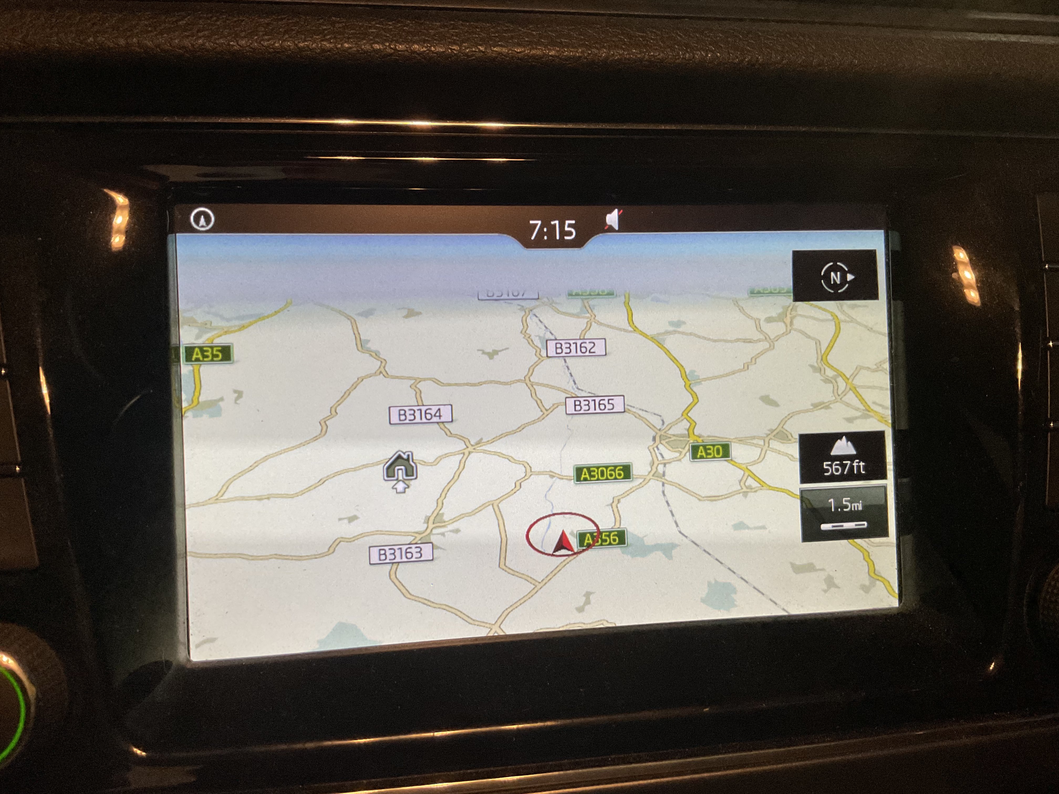

  12. Thanks @varooom. That’s two things to try. No, did not update maps for 2 years, 😌 R-
  13. Thanks, but it’s never looked like that before. The blue area at the top creating the impression we are near the sea is new and a fault. I will try the 2D view though I am not hopeful. R-
  14. On a long trip on Friday in horrendous rain the navigation screen developed a partial loss of the viewable area, as per the attached image. All other functions are normal and a power cycle does not reset it. Am I looking at a big bill for replacement- or is there something else I could try? Thanks, R-
