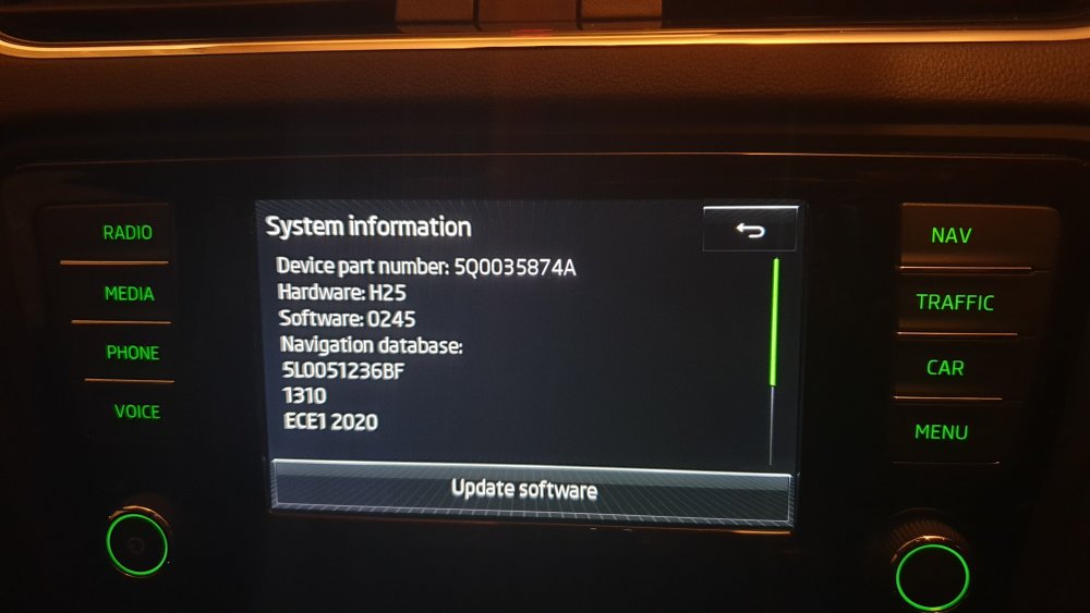

  24. How do I find out if its Amundsen or Columbus? And how do I know if its MIB1 or MIB2? Here's a pic of what I've got:
