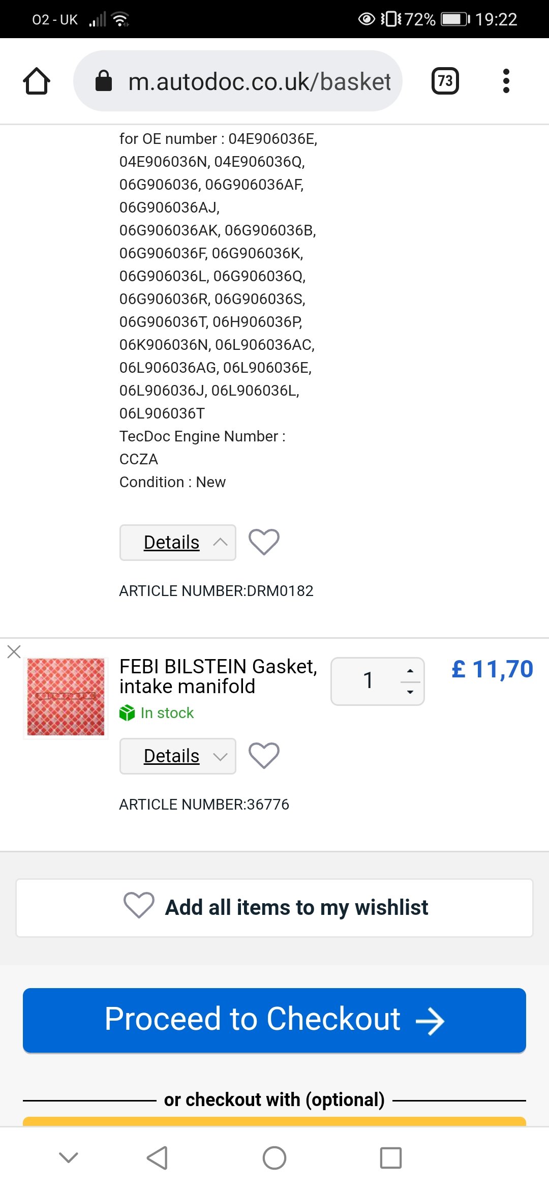

  5. Hi guys.Looking to buy inyector seals but been struggling to find them for my Octavia Vrs.Have managed to find some now which looks same but last letter of part number is different.How big role does it play? My injector part nr is 06H906036G.Would the seals from this image fit?

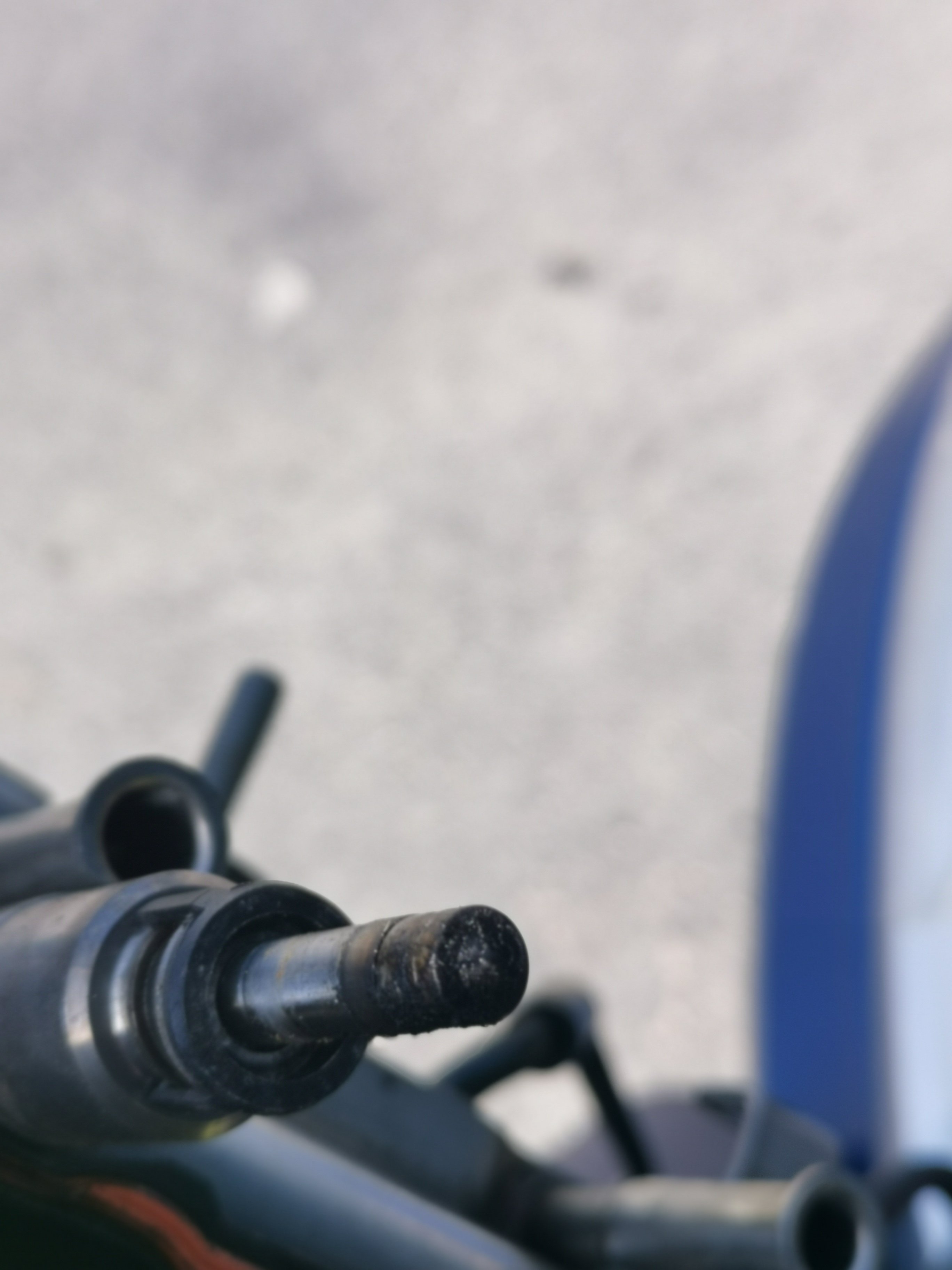

  6. I had slight judder on idle and couple of time misfire in one cilder.Cleaned injectors myself and on had very bad spray pattern that I suppose was causing misfire.Well now all clean just waiting for injectors seals and will see how it goes

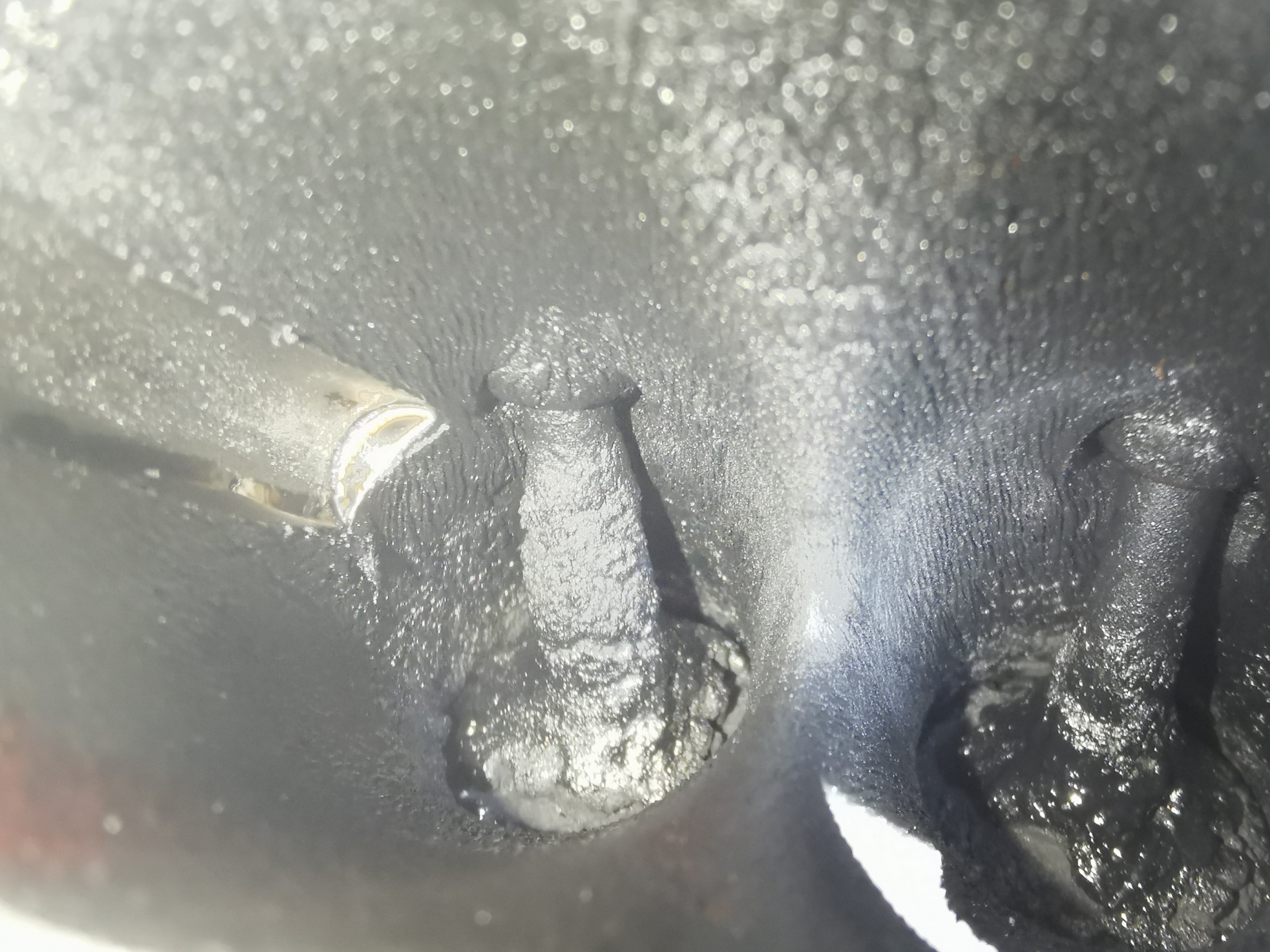

  7. I ve bought car with 77k on clock since than premium oil premium petrol and regular servicing.Seen somewhere that cleaning should be done every 60k
  8. Now no wonder why i had a slight engine judder on idle.Injector nozles all clogged up too

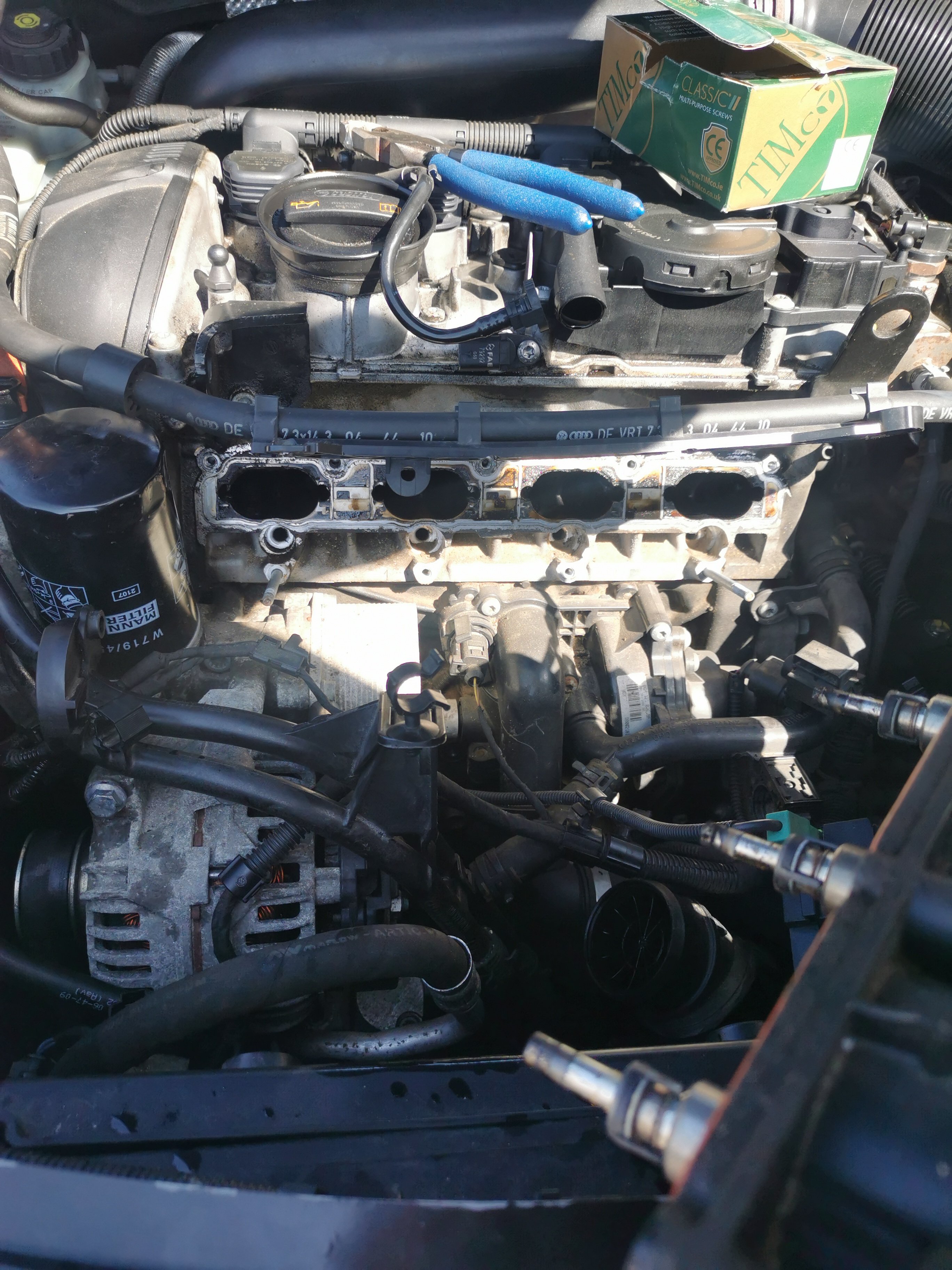

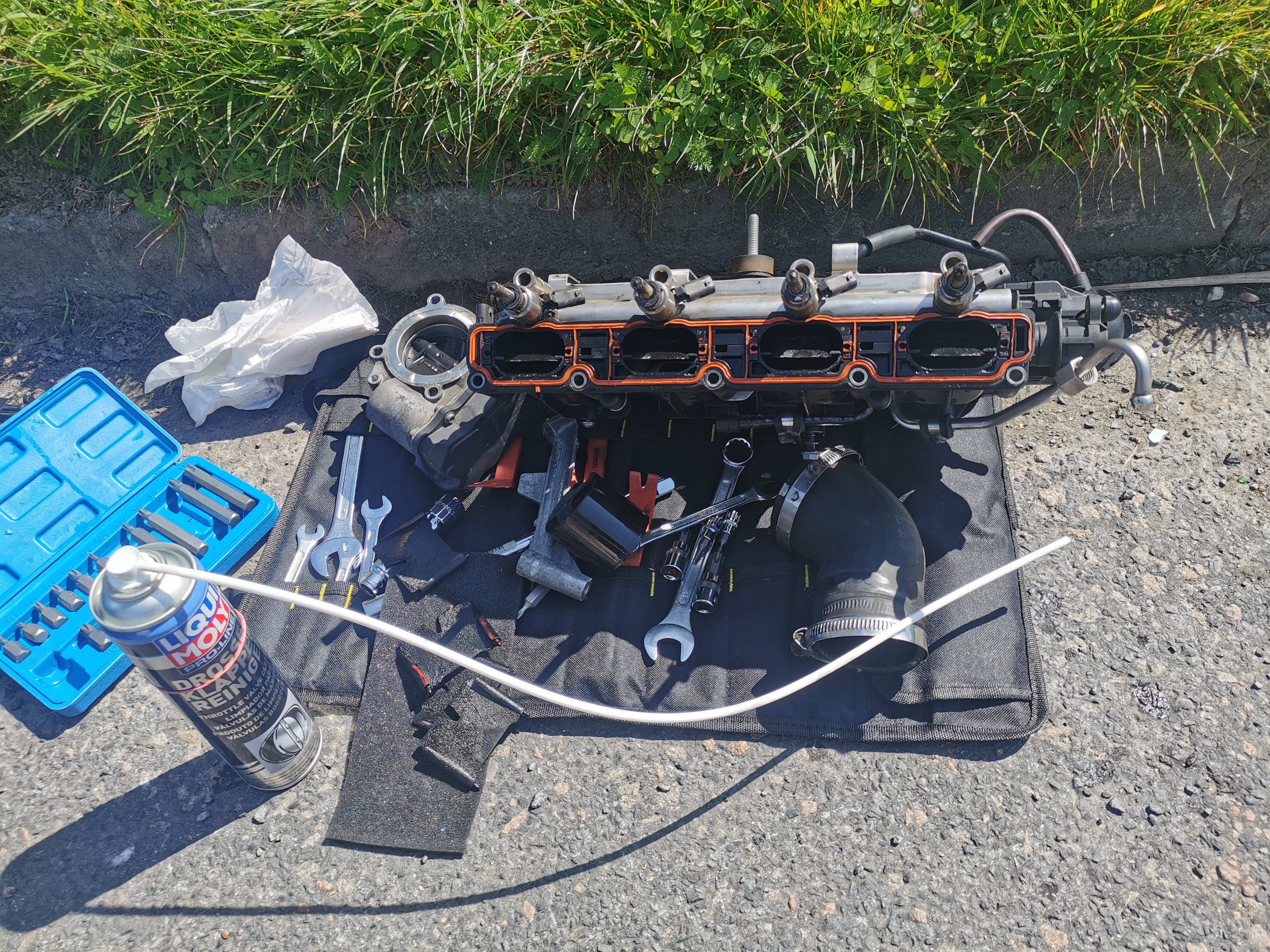

  9. Bank holiday weekend and a joy of owning direct injecton engine car. 100000 miles on my vrs

  11. Let me know when you do it.I am not in rush.Just planning to do carbon clean soon so will take out and clean all injectors too
