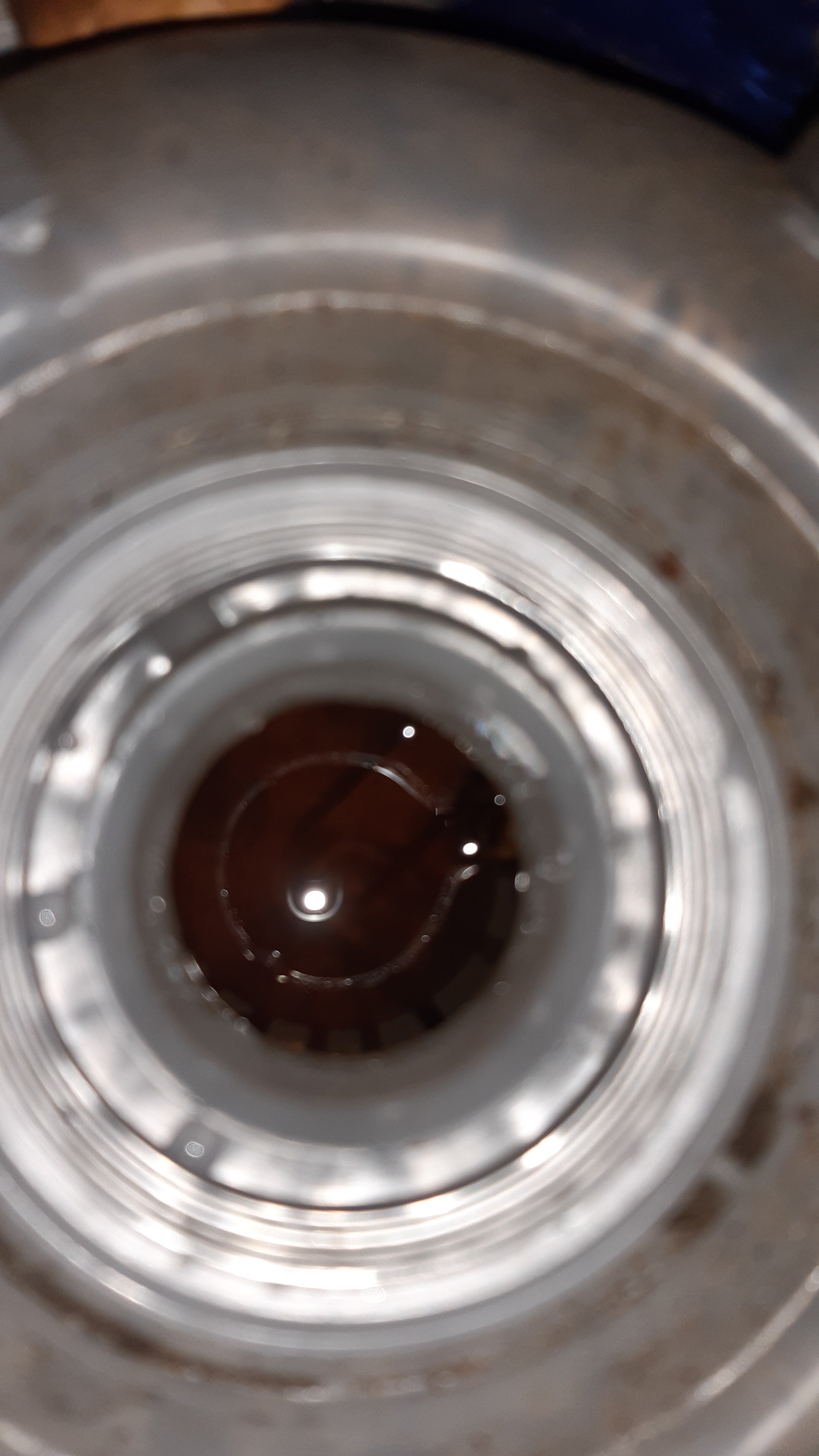

  9. Hi all, I'm beginning to hate this car... Its getting chilly so of course the heating on the car kicks in to warm up the cabin - apart from the divers side - the side that is always occupied of course. cold air blows onto my feet and from both dashboard air vents, the passenger side is nice and toasty but as I don't sit in the passenger seat when I'm driving I'm not a happy bunny. I've tried the flap resets a few times and it all goes through the motions and you can hear/feel it but nope - I'm still dying of hypothermia when I drive this coffin. Just took a pic (in the dark) of the expansion tank, like rusty water in there. I bet this is going to cost a pretty penny? Any ideas guys? Its an Octy mkiii 2016 2.0l diesel estate? Many thanks in advance! Mark
