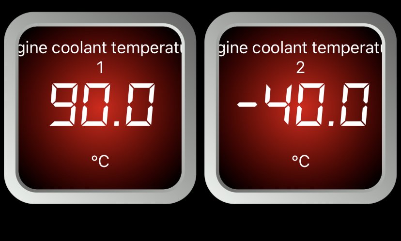

  1. Hi Guys, I have read that there is a one main sensor for ECU, but I have read that there is another sensor for gauges. I am not sure whether it is true but from some reason two different apps are detecting two sensors. From other side I need to agreed that app softwares have limitation and cannot be fully trust. Regards

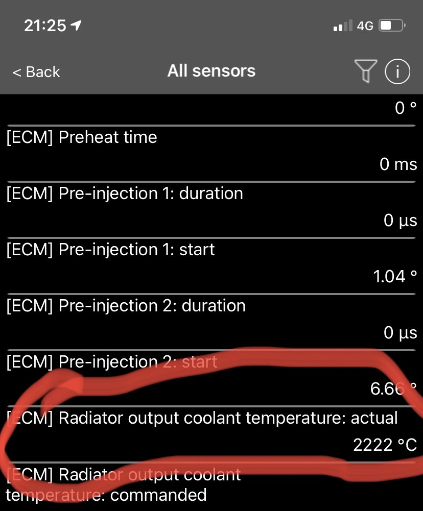

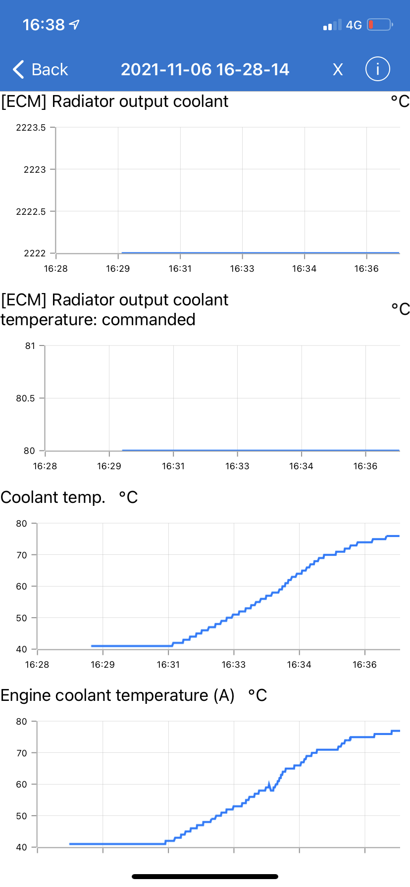

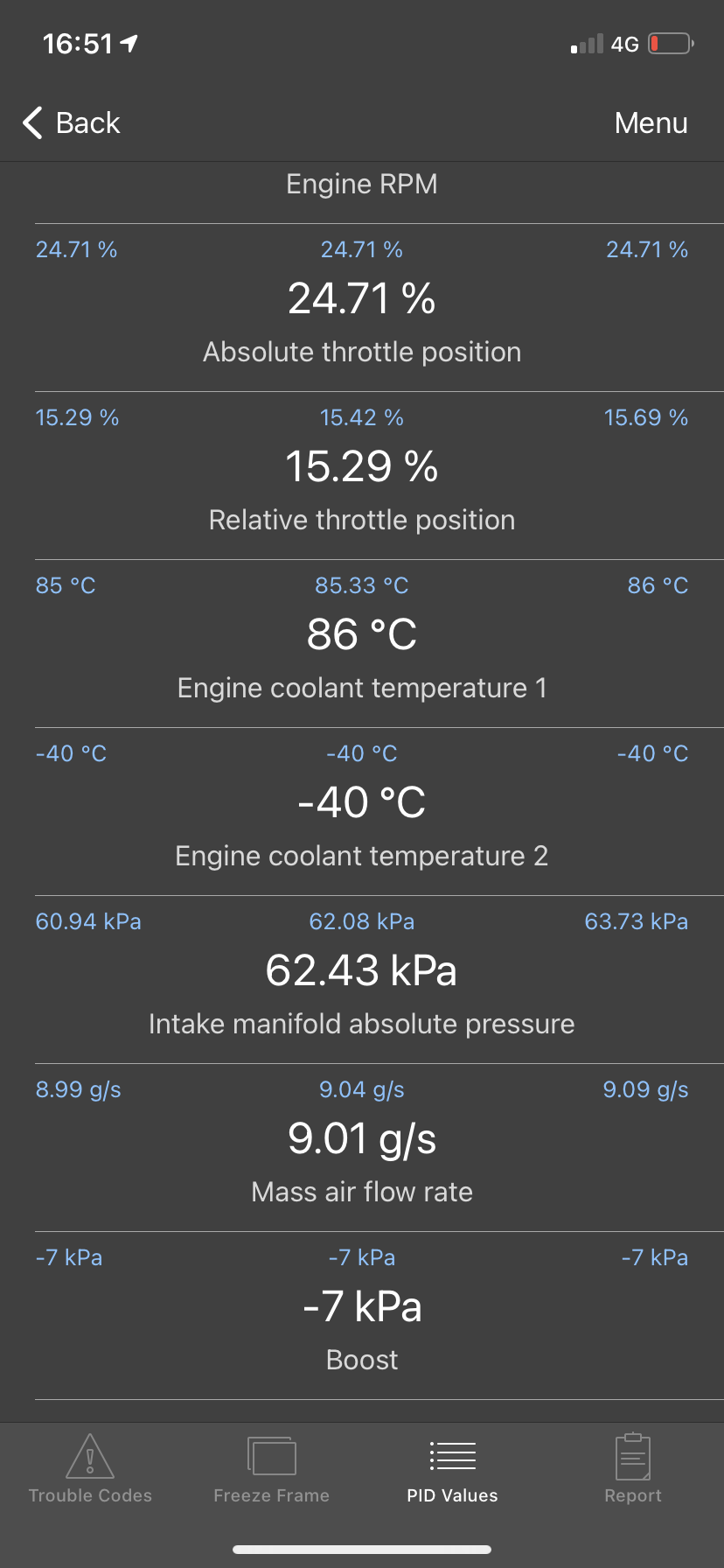

  2. Hello, I have recently look to my Octavia mk3 2.0 TDI (engine code: CRMB) 17MY and I have noticed that readings of the engine coolant temparature sensors are stange. Depend of the app which I have used I can see two sensors: Engine coolant temperature 1 and Engine coolant temperature 2. The redings for engine coolant temperature 2 showing conatantly -40 deg. Questions: 1. Does it mean that my engine has a 2 sensors? 2. What impact to engine it might be? 3. Where the sensor 2 is placed in the engine? I was googling, but it showing me place of the main coolant temperature sensor. To complicate this I have checked on other app (carscanner) and it showing me bit different results and the name of the sensors is different. The carscanner showing me "[ECM] Radiator output coolant temparature: actual" and "[ECM] Radiator output coolant temparature: commanded" Readings for actual is 2222 deg. where comanded is 80 deg. Questions: 4. Is the "[ECM] Radiator output coolant temparature" sensor the same as "Engine coolant temperature 2"? One of them showing -40 deg. second 2222 deg. Both values are insane. 5. If not the same what is it? I am bit lost in those readings and I will be appreciate for any help. Just to mention that I am trying to find a reason why my car has higher fuel consumption and what I have been learned those sensors might have something to do with my issue. Regards Florian.
  3. Hello Guys, Thanks for feedback No it was not, rpm were about 750. The oil and oil filter has been changed at 1st July. I have been in Skoda so I am assuming that they have put correct one. The readings showing that DPF is OK, I have done small sesion to capture few parameters to see how they are behave during stop and drive, I have combined three pictures of different parametes with reflect to rpm. Part 1 is showing air temp and MAF, from some strange reason readings has stoped recording. It might be that I have clicked someting during short breake. Part 2, air/fuel ratio normally should be about 14.7. What I can see it is about 4 and sohastically going up when rpm increasing. Does it should be conversely? I am not sure this variability, it does not look good for me. Part 3, readings of O2 sensor (lambda sensors). What I have read is that the mA should be around 0 mA otherwise fuel mixture is rich or lean. What I do not like again is this vairability. O2S1 looks like have higher values constantly where O2S2 has proper values on the begining, but the end is rubish. Basically when I was googling I have found information that so high increase consumption of the fuel is matching with lambda sensor failure (up to 50% higher consumption and less power during acceleration). There is just one problem, there is no DTC error. Any ideas what it might be? Sympthoms are muching to lambda sensoer failure, but there is no error. I have been today to do MOT and surprisedly I have passed MOT. After my findings I was pretty much sure that I will fail MOT, but I did not. In the service they have explained to me that for diesel they are not doing the same emmision test like for petrol engine. Anyway they have ignored me when I started talking about my readings. For them there is no error so there is no problem. I will be much appriciated if somone can have a look on my readings and advice what I should do next. I would prefer to take some more measuremnts from the car to better understand what is happening rather that replacing bit by bit.
