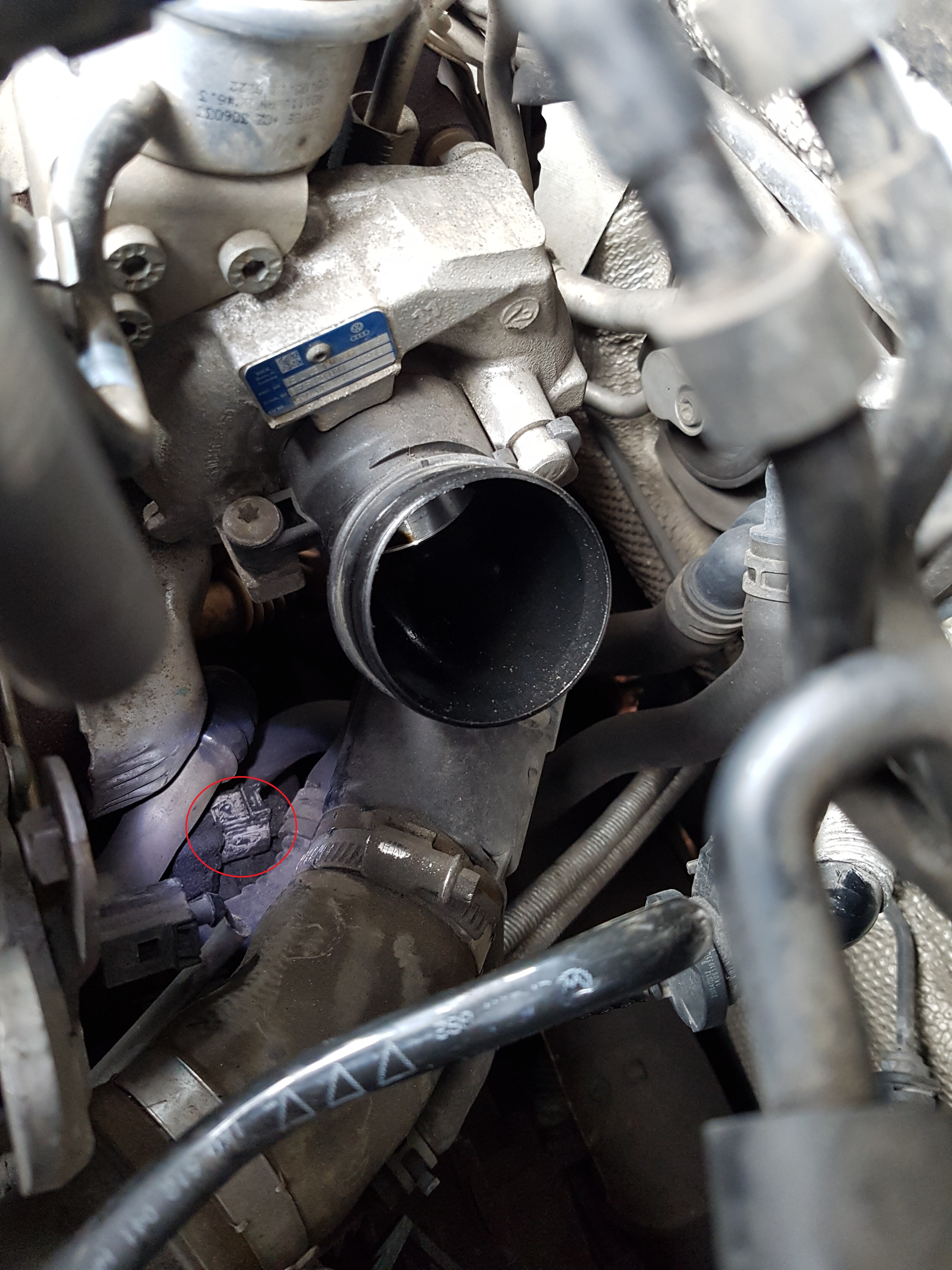

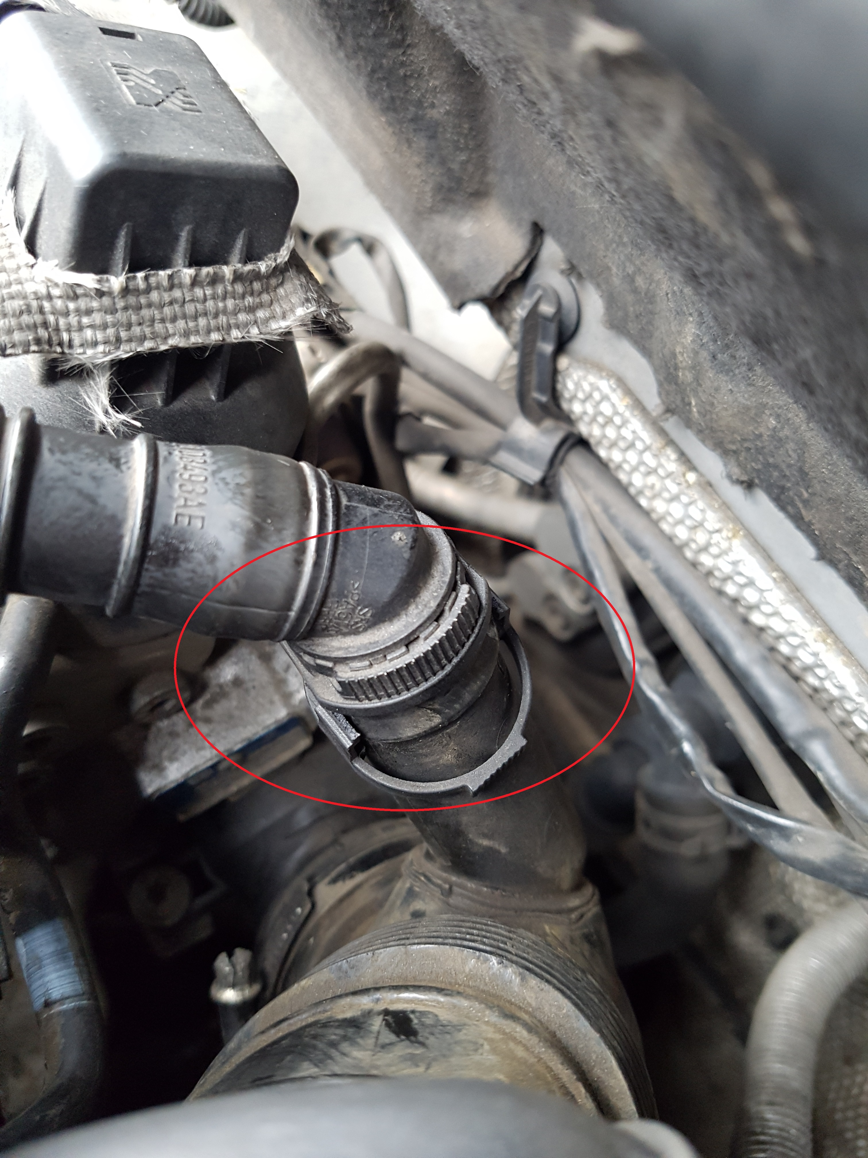

  2. Yep...id rather be safe than sorry too lol well it arrived today and just fitted it. quite easy to do 1) remove the engine cover 2) undo the clamp on the big air pipe. undo the jubilee clip on the air pipe (turbo end) and remove it. the Little breather pipe was a bit tricky to get off by squeezing the clip and i ended up breaking the clip when i pulled it off lol but it should still hold? (pic attached) i used a torch and long screw driver to see the plug for the egr connector it was covered in dirt and i couldnt find it at first but picture shows it in red circle once it was removed it was easy to connect the simulator..1) plug into the EGR connector (leaving the egr disconnected of course) 1 plug of the simulator into the MAF and the other into the car ECU connector for the MAF and re fit pipes etc re scanned codes and nothing present so i will drive it today to work in a bit hopefully makes it lol and update after a couple days EMU 11 EN (1).pdf
