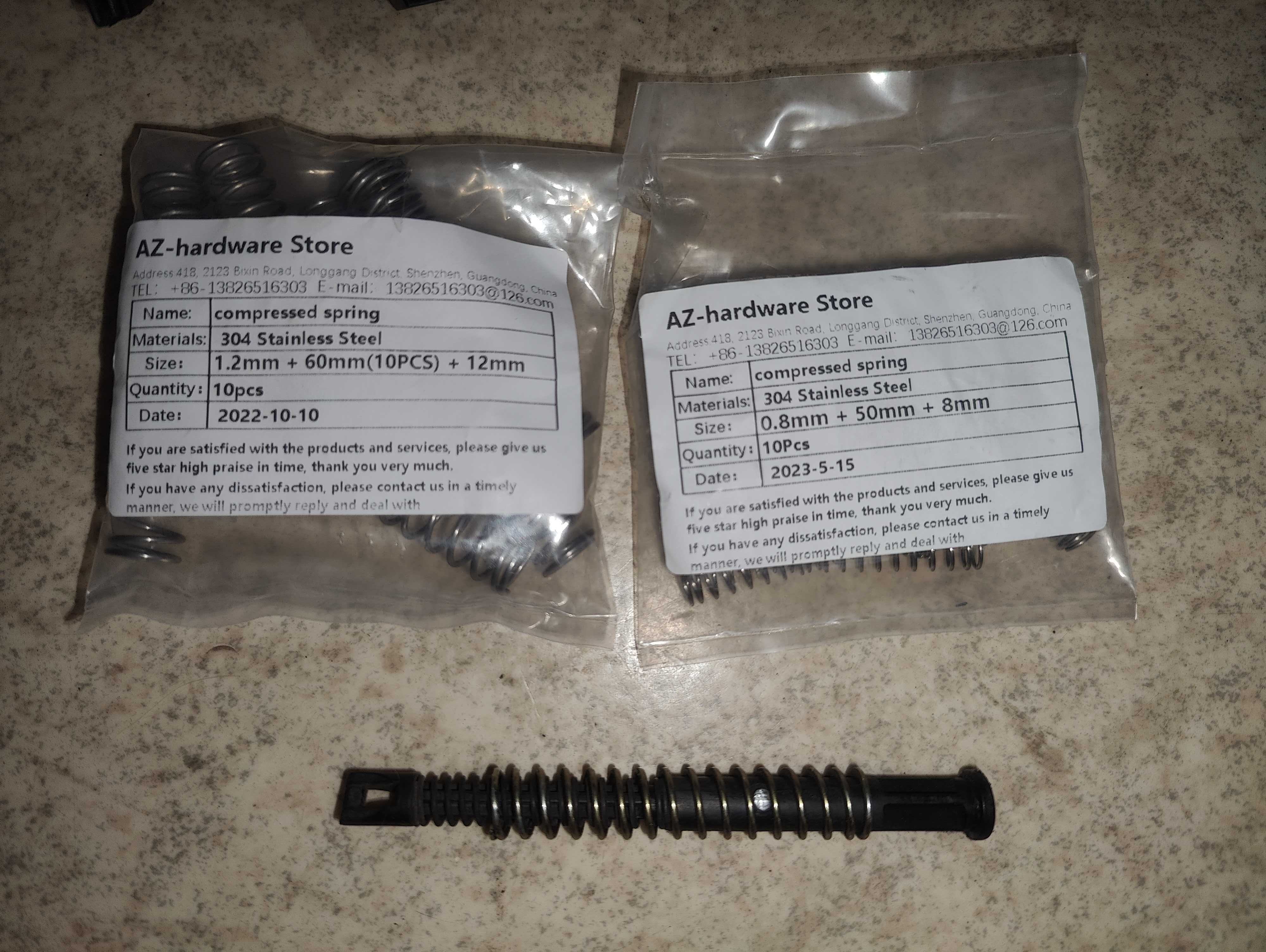

  1. I just realized last week that the flap was stuck half open again. Knowing that the springs were really strong in there, I was experimenting with replacement springs. Now I put another volvo thermostat and I changed the springs with softer ones. Now the thermostat is able to push against the spring easier to close the hot air port. Stainless steel springs seem to be softer in general. Let's get back to this in a few years
