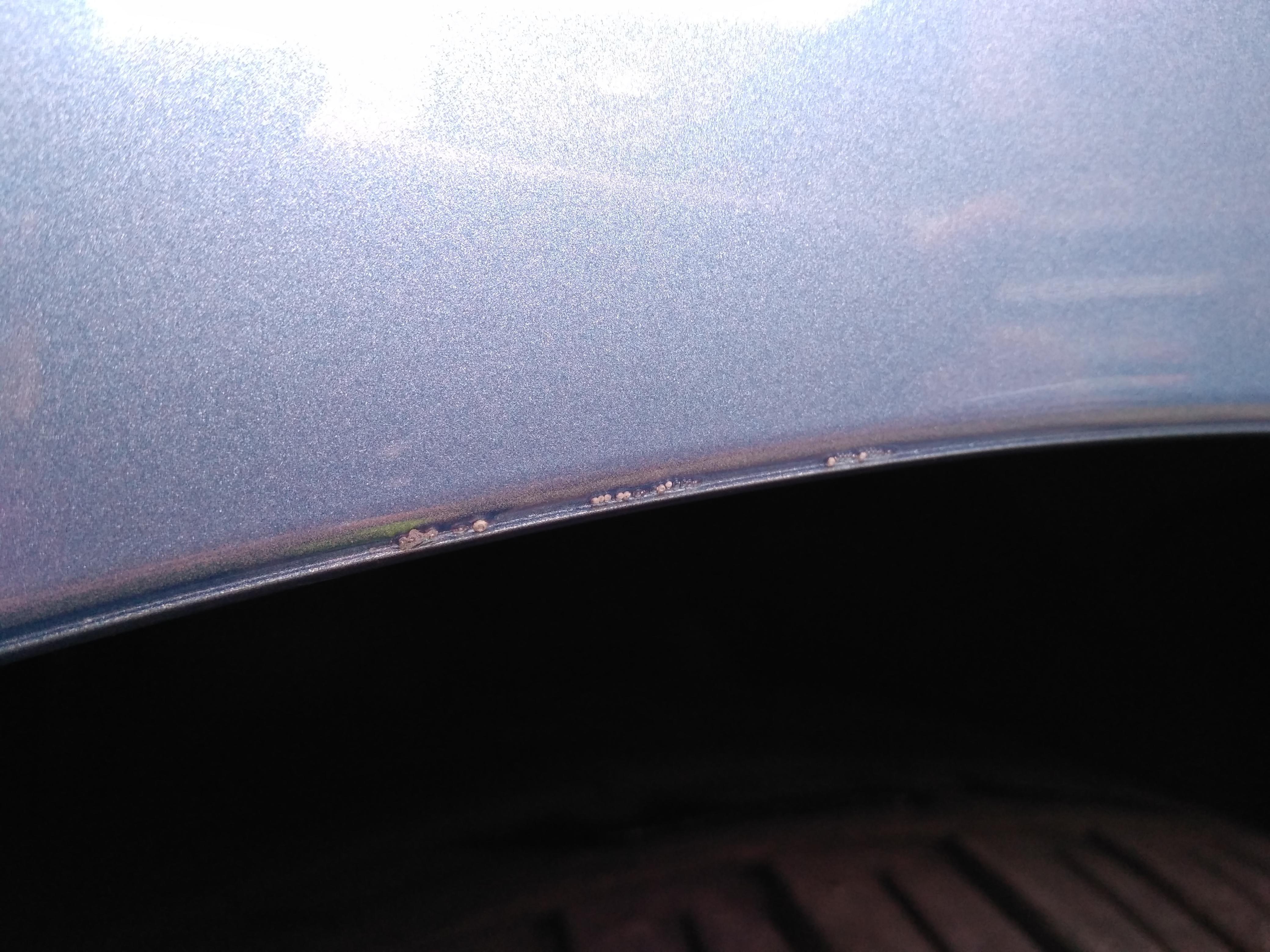

  2. Hi 👋 Update 2 years later. I managed to get Skoda to acknowledge it was a factory defect (Skoda initially claimed I had had the car repainted!). At the same time they informed me that those bubble were not caused by rust, so it would not get worse with time. Needless to say, they refused to fix it. At this point I decided to stop wasting time with them. Two years later I can confirm it has not got any worse, so most likely those bubbles were there from day 1. The lesson learnt is to check very careful the day you pick a new car from the dealer's salon, as there may be hidden surprises. Some detailing workshops will agree to accompany you and inspect the car for you for small fee or for free if you purchase some of their services, like wax or ceramic coating. Cheers

  4. Hey, good for you.. Problem is, it's my original dealer where I initially went with my warranty claim, and they dismissed it claiming I had had the car repainted Thin chance they will agree to pay a bill after pulling that...
  5. Hi, Another update after a long time My claim to Skoda's Customer Services in Poland was pretty much ignored. Initially they wrote back they would contact me back within 14 days.. After a few months of waiting, I contacted them to remind them, and they told me the only way to submit a warranty claim was through some authorized center. So I was back to the starting point :/ So I did that, I found a different authorized center not far away from my home and started the claim process from zero. Initially, it went pretty well. The people who checked those "bubbles" were surprised that my original authorized center rejected my warranty claim. They prepared all the documentation and sent it to Skoda in order to accept the costs for the repair. The new warranty claim process took a very long time. Skoda would take long time to respond, and rejected the documentation several times based on different technicalities about the documentation format, so I had to go back several times to have new photos taken etc. In the end, once Skoda had no more arguments to reject the documentation, they decided that the bubbles were not caused due to corrosion. Instead, they claim they are made of some sort of air/gas bubbles trapped while applying some sort of bitumen protection layer in the factory. They claim these are completely harmless and, needless to say, the warranty claim was rejected. Those bubbles are to stay as they are :| Due to the amount of time, effort and stress put so far, I'm really temted to just let it go and just cover the eventual repair. I guess that is their plan anyway.. sad. What else can I do? Cheers, Juan
  6. Hi, Today I noticed some suspicious bubbles while cleaning my 2 years old Octavia. They don't seem to be caused by rust (they are hard) but they seem suspicious nonetheless. Thoughts?
