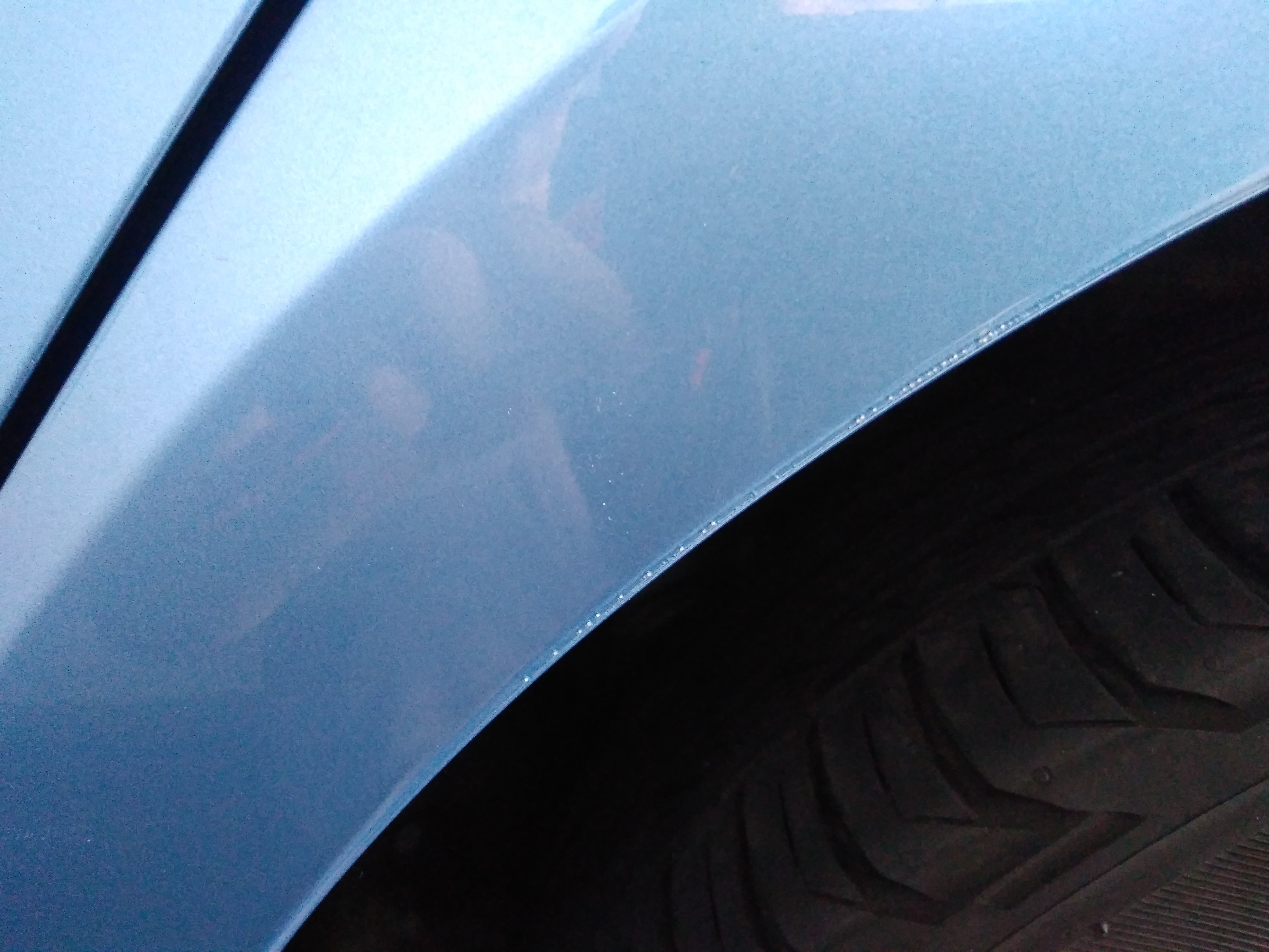

Hi,
Today I noticed some suspicious bubbles while cleaning my 2 years old Octavia.
They don't seem to be caused by rust (they are hard) but they seem suspicious nonetheless.
Thoughts?

After closer inspection, it seems like same problem is on both rear fenders. It definitely seems like some kind of production defect. I'm wondering if any other Octavia owners have had the same problem on recent models (>2017)
Today I was at the dealer and it was not as bad as I expected. They acknowledged there is a problem and took some photos under the microscope for further investigation. They said they should contact me in about one week with the results.

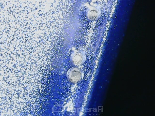

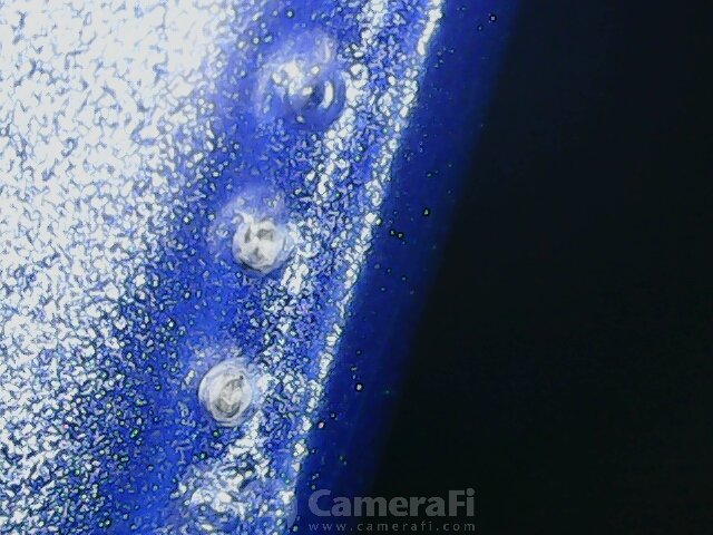

Some close-up pictures
That almost looks like welding
Good god, that’s terrible.
It looks like poor welding to me too.
My thoughts exactly. Those bubbles extend across the whole 2 rear fenders.

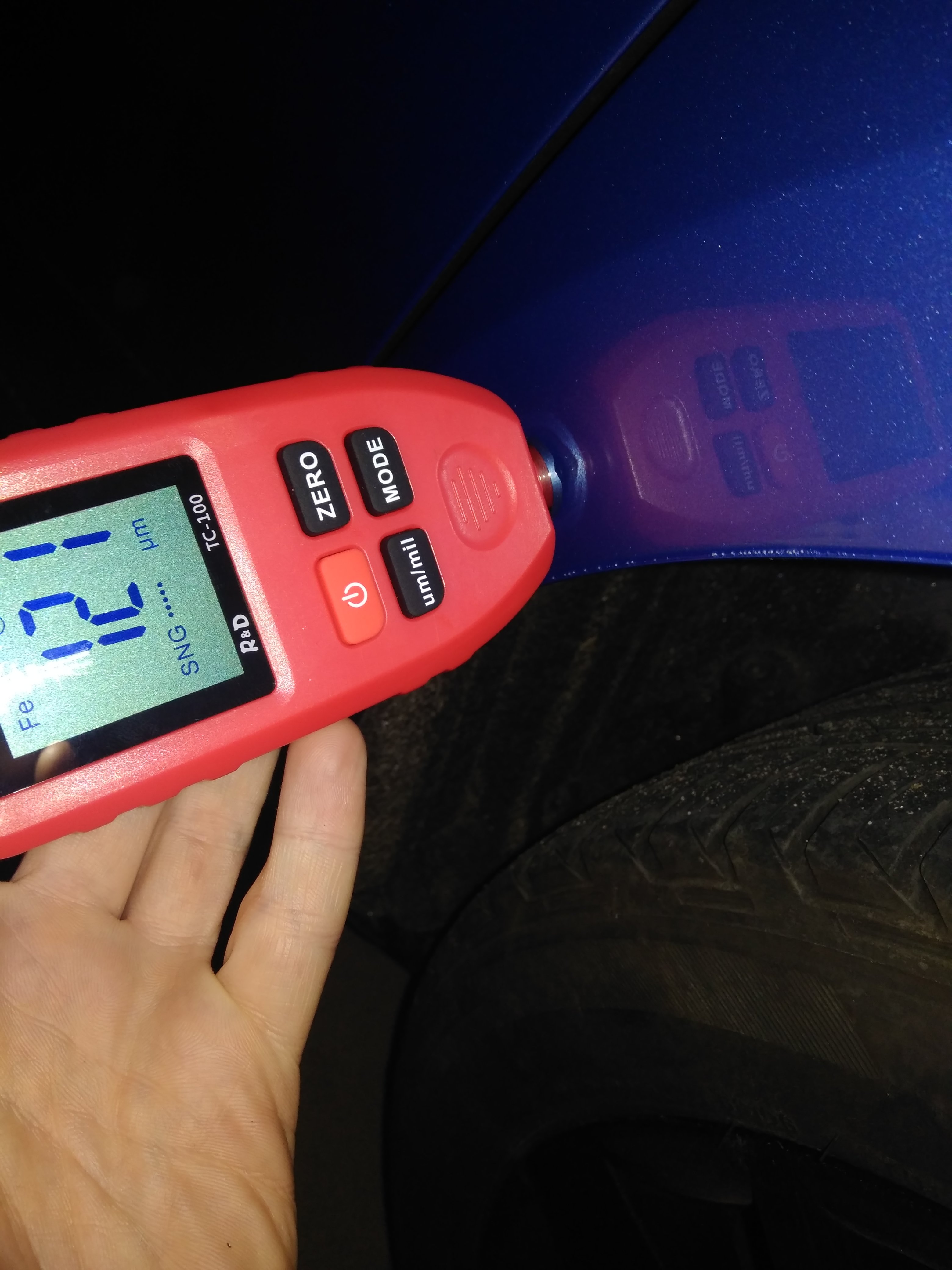

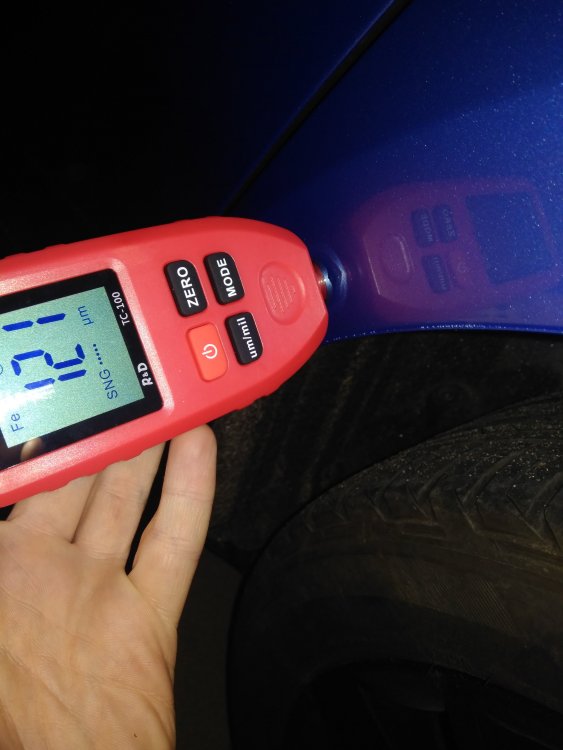

So I just went to a local car detailing just to have a second opinion. They closely examined the area using the paint thickness gauge and a special inspection lamp.
The PTG confirmed that the thickness is inside the nominal range (it's about 130um at most), whilst the close inspection under the lamp confirms the absence of any residues or trapped particles which are common to find after paint jobs even if performed in a closed chamber.
Long story short, it's very unlikely that this car has ever received a paint job outside the factory, but we will see what they have to say next week :)
You will want them to give you the PTG readings on the area and the area around it, plus some a distance away.
If you can show the car is approx 130um over most of the car, they don't really have a leg to stand on.
Anything you can get in writing before is a bonus, even if you have to pay a little to get it.
I've heard of people given the run around using this exact excuse on the forum before, so if you can find the threads in search, it will help to see what others claim to have had happen to them.
