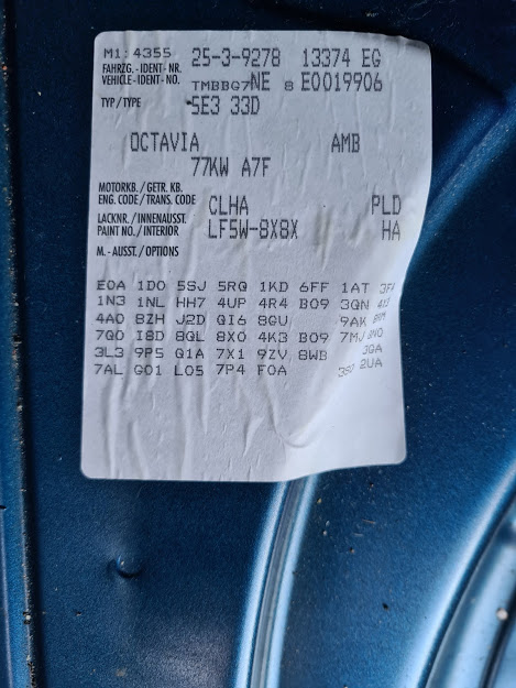

Thanks ill move it there. Not sure on the options. As far as im aware its bog standard. Is there a way to find out what extras are on like a plate somewhere or sticker? Thanks- Skoda Octavia 3 5e full autoscan wanted
Hi all, a couple of years ago i mucked up coding my front fog lights. It has left me with a light stuck on on the drivers side rear. Ive changed pcs a few times since so no log to view. The only way i can see of fixing this (without skoda) is an autoscan from an identical car. I can then scroll down page by page until i find the culprit. Would anyone be willing to share an auto scan of a 2013 5e model please?- VCDS Rod file missing (SK37)
