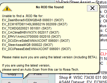

hi, i have contacted Ross-Tech and "apparently" my cable is a fake. Probably so as it cost me about £80, but it has always done everything else in the past. They say if i buy a genuine cable this will correct the problem. (I doubt it as i checked ROD folder from the install and there is no file that it is looking for). Any Ideas? -

Ive just joined their forum. So i could raise a ticket. Ive also just tried my original install (17). This was missing them also. -
just done an autoscan and noticed that VCDS has stopped showing a few things. Error Missing Rod file. Would have thought a mk3 octy would still be listed in the updates. Ive re installed and also installed to a different location to check that its not an install error. Has anyone got any ideas (or a copy of the ROD files needed)? Thanks Log-TMBBG7NE8E0019906-156670km-97350mi.txt
