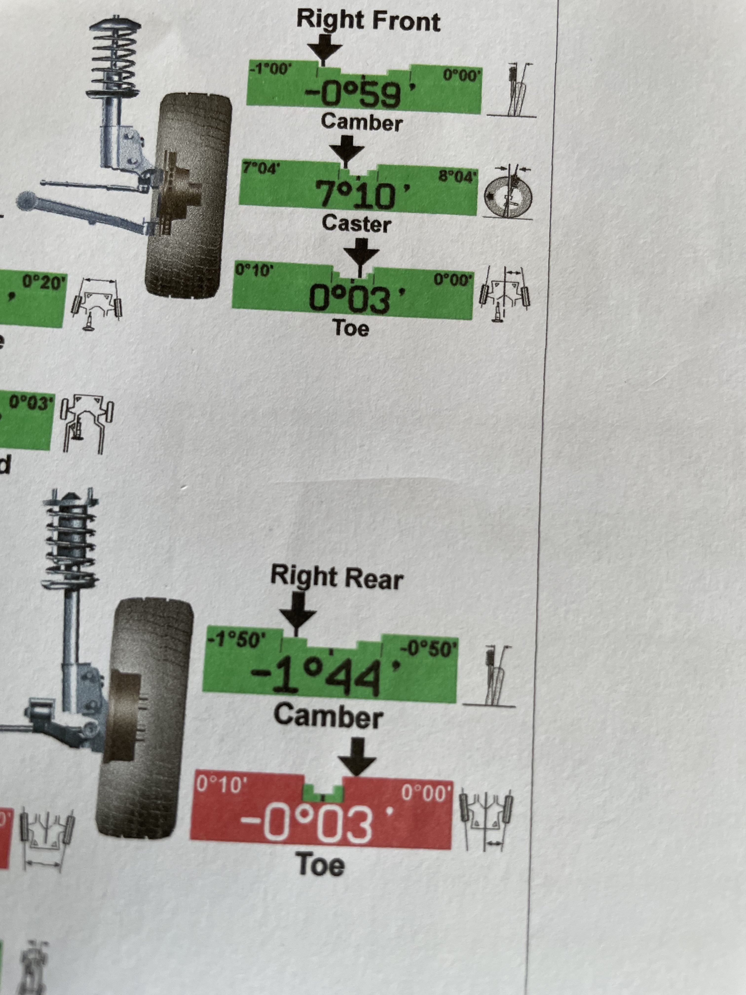

  6. Every where I look, negative toe is toe out. The rear is only toe-out by as much as the front is toe-in, with the front being within acceptable. The printout shows where it's up to. Looking closely at where the arrow is above the the red block thing, it looks like it's possibly only 1 minute outside acceptable (and roughly equates to being 1 metre off course (to the side of straight ahead) after 3.4km. I'll take that. I have a spare set of wheels with some old, but still OK, tyres on, albeit summer ones. I may swap them over soon and sacrifice them as a tyre wear experiment. Handles and responds fine. I think tyre wear will be the only issue.
  7. Update.... Today I went to a local highly regarded motorsport garage and had a full 4-wheel alignment done. The replacement lower control arms that I fitted were Moog items, a brand I always held to be pretty good. Anyway, not so it would appear. The garage ran out of adjustment on one side, at -0:03' (minus 3 minutes) which is toe out, which is not good. The other side could be adjusted to zero, but they had to have that at -0:03' too, otherwise the back would want to go sideways. I may well get tyre wear on the inside edges. The nice chap recommended to always use genuine manufacturer parts for these sort of parts, as the tolerances are usually tighter than most aftermarket. I believe that Lemforder are the people that make the original VAG parts anyway, so I guess getting a pair of them would be good (at half the cost of some VAG/Skoda-stickered ones from a dealer, and a lot cheaper than a pair of tyres every few months!!)?)

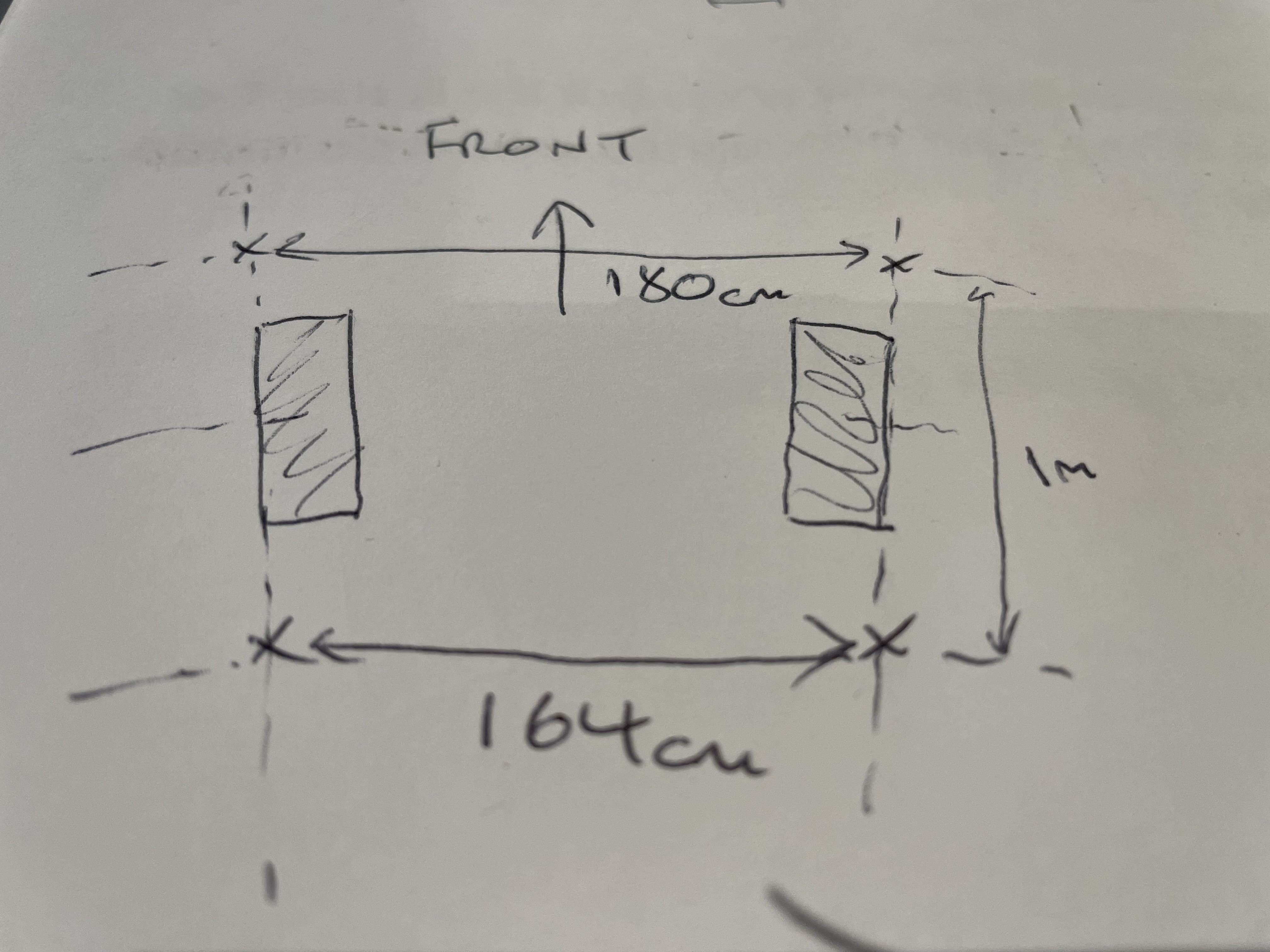

  8. I worked out the above toe angle to be 4.5 degrees each side, toe out. Blimey! 😳 I put the car on some slidy cardboard so the tyres didn't grip the floor too much and got back underneath (it's a tight fit for sure!). Turned those eccentric bolts until the two dimensions above were the same and not 16cm apart, therefore the toe angle is now zero. There could be some 'thrust' i.e. both wheels pointing either left or right together (I'm on a steep leaning curve here - everyday is a school day), but I was careful that the bolts were, to the eye, rotated the same on each side. Out for a test drive: My road (30mph) - all good, next couple of roads (up to 50mph) - all good, dual carriageway (up to around 70mph) all good. Handles great, no sideways, steering central and arrow straight. I'll be booking it in for a proper laser-beam alignment tomorrow. Massive thanks to J.R. for steering me in the right direction (pun totally intended!) 🥰
  9. Well I guess this a bit outside what the rear toe should be!! J.R. you're a star! No more pelvic floor exercises for me!
  10. The camber angle seems to be about right at 1.5 degrees. Whilst I do know the difference between toe and camber and castor, I was thinking that the eccentric bolt at the inner end of the lower control arm, adjusted camber (as it looks like it moves the arm in or out and thus the bottom of the wheel). That however, is the toe adjustment, so that could well be out. I'm glad the camber seems OK as the bolt that adjusts that is right up in the sub-frame and will no doubt be a nightmare to do. I didn't know it was there, as it wasn't involved in the replacing of the LCAs and rear springs. So, J.R, you're suggestion of toe being wrong is very possibly correct, as I did undo that bolt, and now it all makes sense. Me thinking that was the camber adjustment has put me all sideways let alone the car! I'll go and see now...
  11. Aha! Having now consulted the workshop manual after J.R.'s comment (which I didn't do to replace the rear control arms, as it seemed to be a simple two bolts on each side job, and I had no idea the camber could be adjusted at the back), there is a table which says that if the lower controls arms are replaced, then a wheel alignment must be carried out. Luckily none of the other new parts necessitate a wheel alignment. I measured the dimensions of the new v old lower control arms and they are bang on identical. I'll do a very basic measurement with a plumb line and ruler tomorrow and adjust if necessary, (being mindful that I'll need to do the triangle maths and convert decimal degrees into degrees and minutes), if I can just about squeeze under the car to do it. I'll still get it booked into my highly regarded garage for a 4-wheel alignment asap. When the new rear shocks turn up that I'd ordered anyway, I'll put them on regardless.
