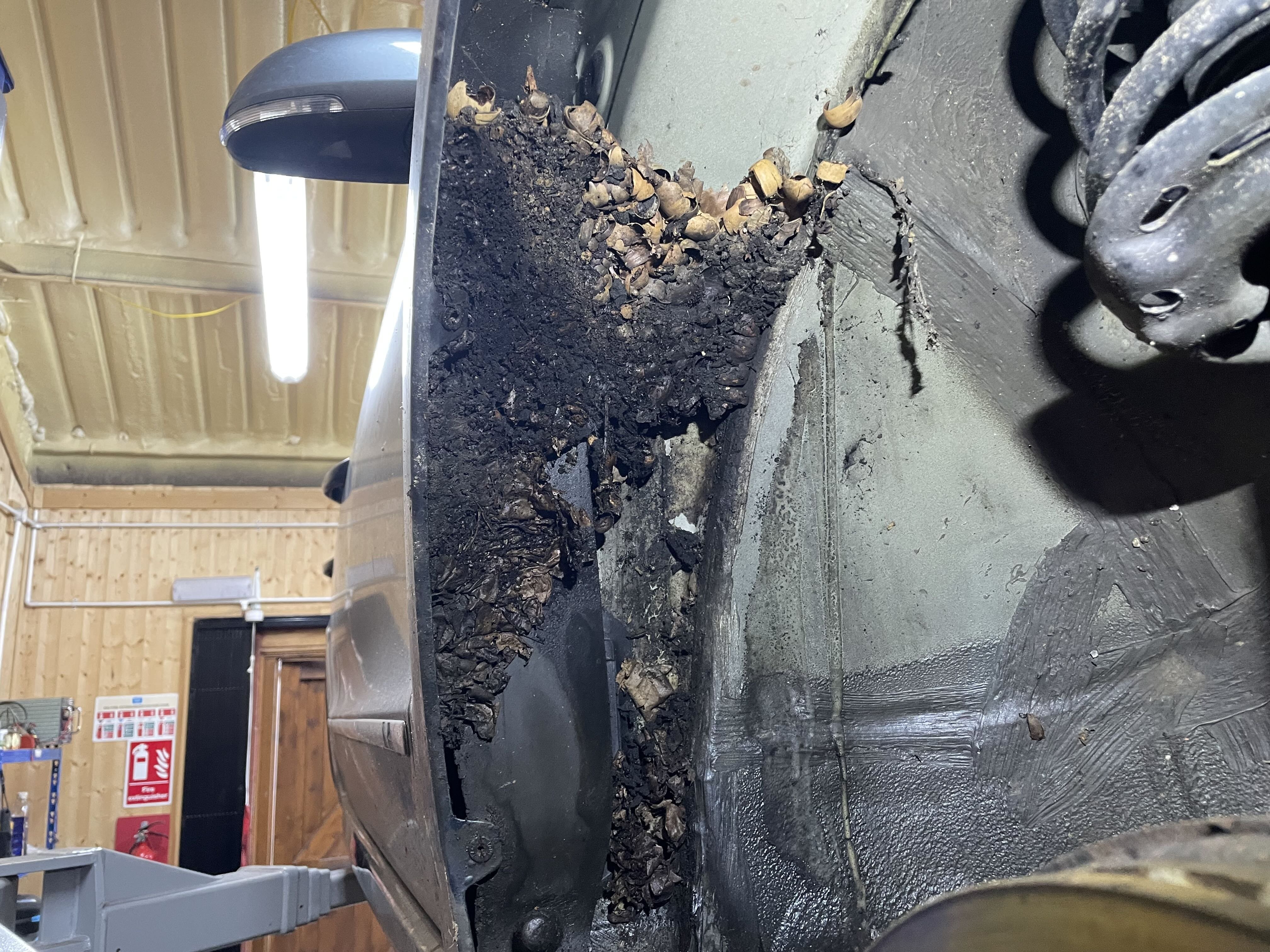

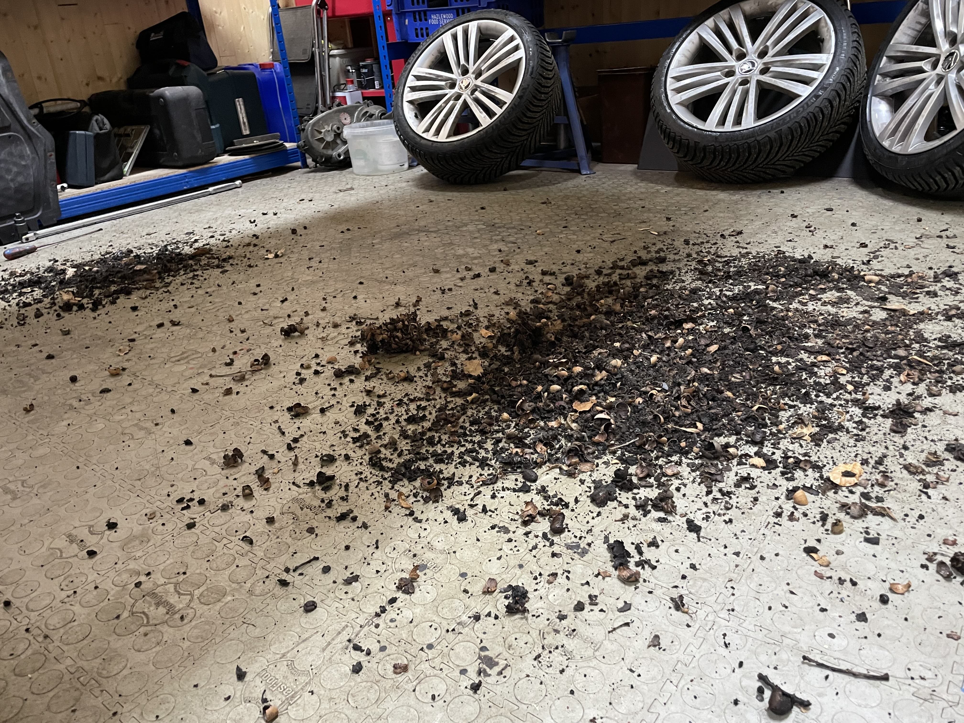

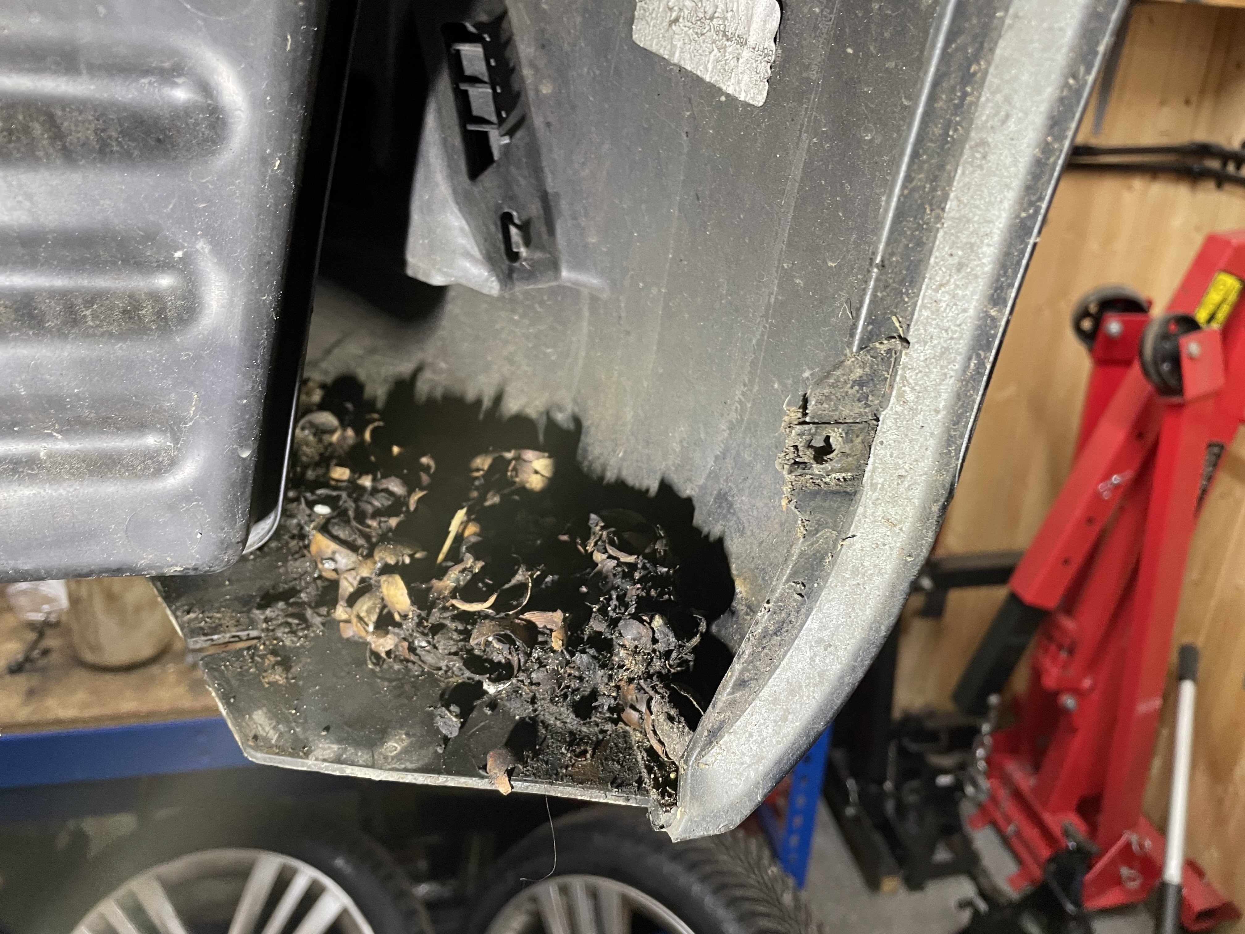

This is why it's a good idea to remove your wheel arch liners once in a while...  Some small rodent type thing/s had clearly spent a comfortable time in the snug spaces.
But, there was also a lot of wet and damp dirt/mud low down in the places where rust could start at the front ends of the sills.
I'll be washing it all out and then sloshing Waxoyl everywhere, before putting the liners back in with a recipe for squirrel pie as a deterrent for any future would-be dwellers.

Yes this should be part of your yearly service routine if you want your car to last 10-15 years without rotting

Absolutely, it is that simple. Buuuut, depending on how old and how much exposed to British roads your car is/has been, you may need a handful of spare screws and the U-clip things they go into in case they are rusted out. I needed about six new clips.
To get the front ones off, you also have to remove the middle/front undertray, which is as easy (three big bolts at the back of it aswell).
