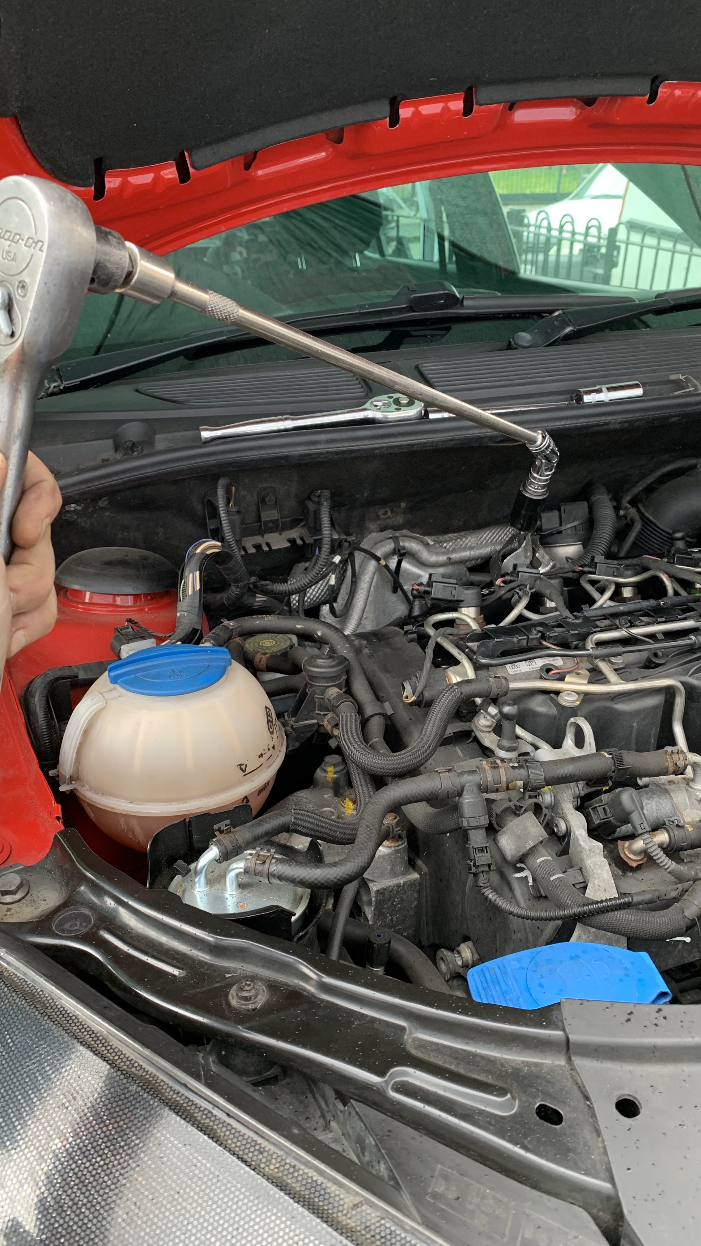

Woohoo. Got it off with a long ratchet extension and a lot of force after cutting the pipe. Nearly went flying when it cracked the first time. Then used a ratchet spanner to get the rest off. The plug on the end was slightly different, had a plastic nub in a different place but cut that off and went in fine. Hopefully I can clear the error and somehow force a regen otherwise looks like I’m gonna have to go the garage.

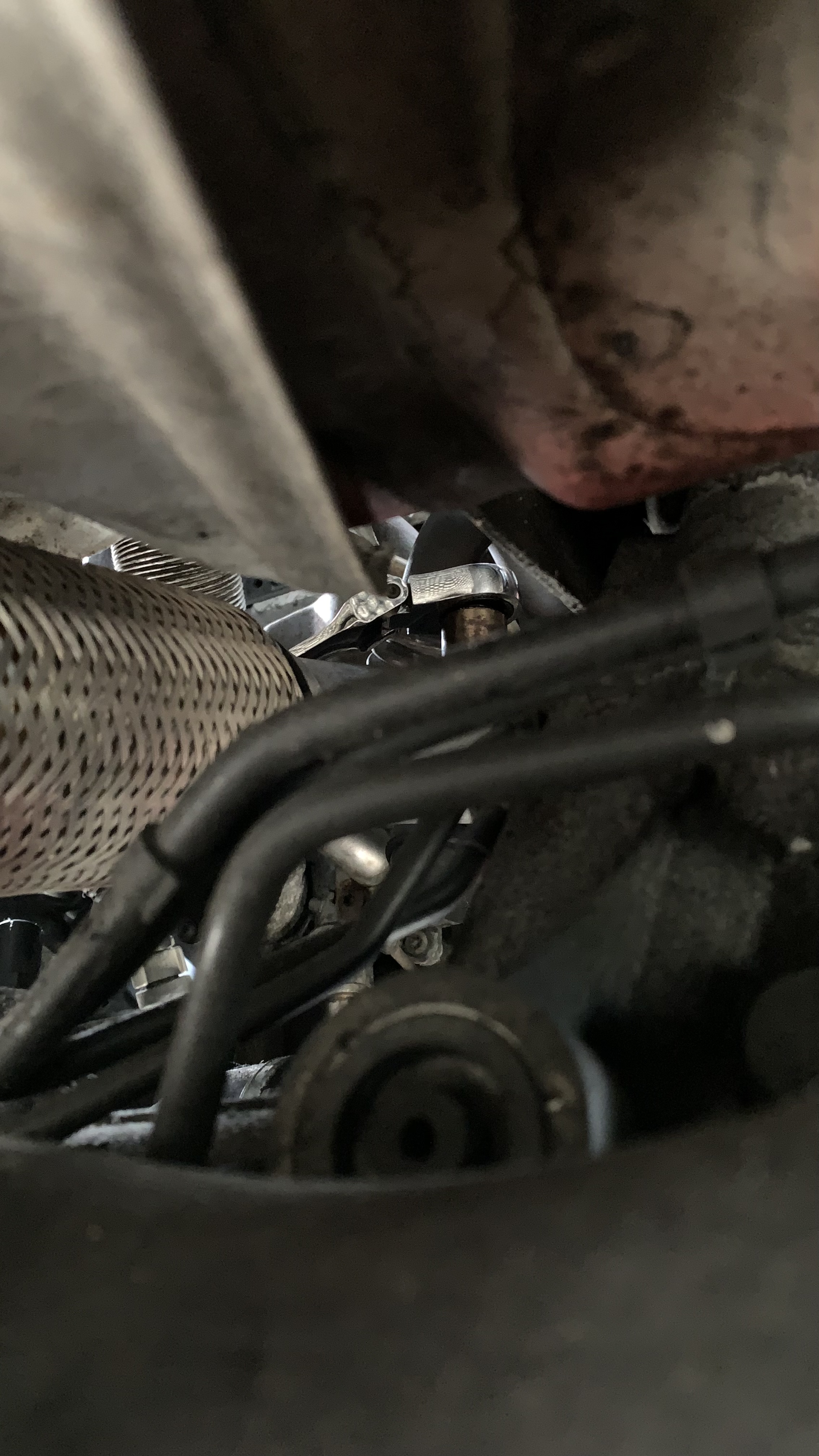

Hey. Thanks for the update. according to a person on my post bank 1 sensor 3 is under the Cat and not the ones we’ve took photos of. They provided a diagram but I’m still not 100% sure exactly where it is cos the diagram had a few sensors on it.
Glow plug flashing/exhaust light P242B Code - Fabia Mk2 1.6 Diesel
I can’t see any wires or plugs in that area. Got any pics of where it is? On mine I can only see 2 plugs/wires. One that’s goes to the sensor that you can see on top and the one I circled.
Is that the one circled in my previous photo?
