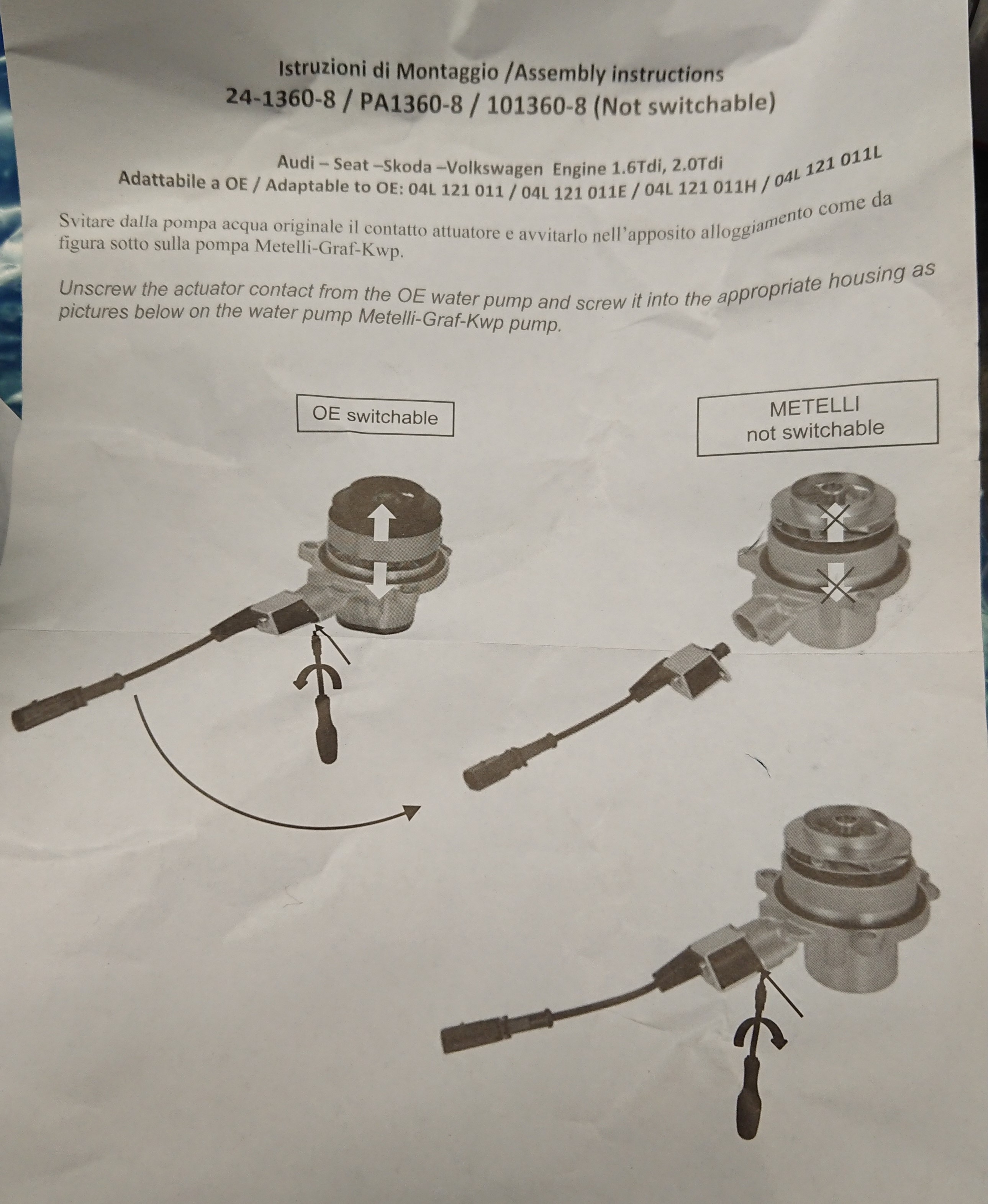

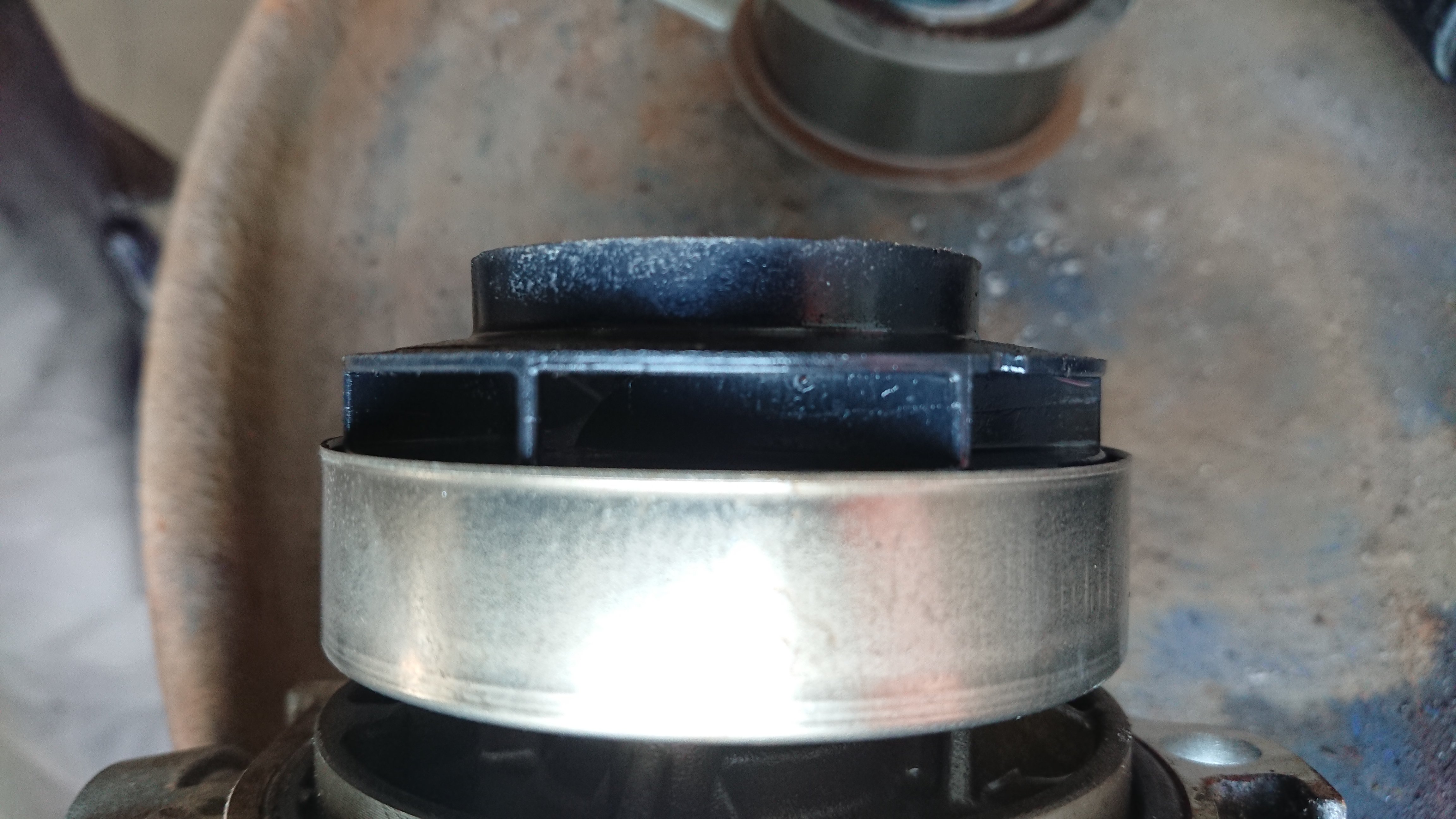

  9. Thanks for the insight. I've only been guided by my mechanic and by TPS offering him the `revised` version. Hopefully it will be fine.
