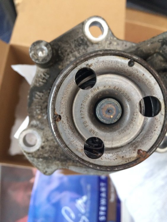

I got the failed part back, I'll add photo of the failed waterpump later. It came in the new waterpump box, so I'll also give the newly installed part number. Work was done September 2017.
Feb 2014, TDI vRS, first noticed at ~95k km, Dealer is AMAG Suisse, diagnosed fault in 5mins, immediately offered 50% contribution to repair costs.
The code on the new water pump that was installed to my car Sep 2017 is 04L 121 011 L.
I beleive the last letter is the revision number.
Attached is the photo of my old water pump. You can see the shredded insides.
