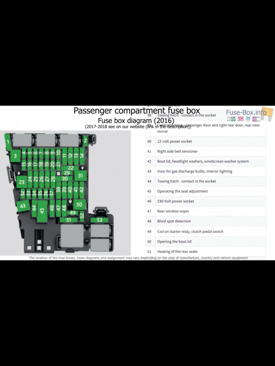

  8. ....forgot to add the fuse box diagram.

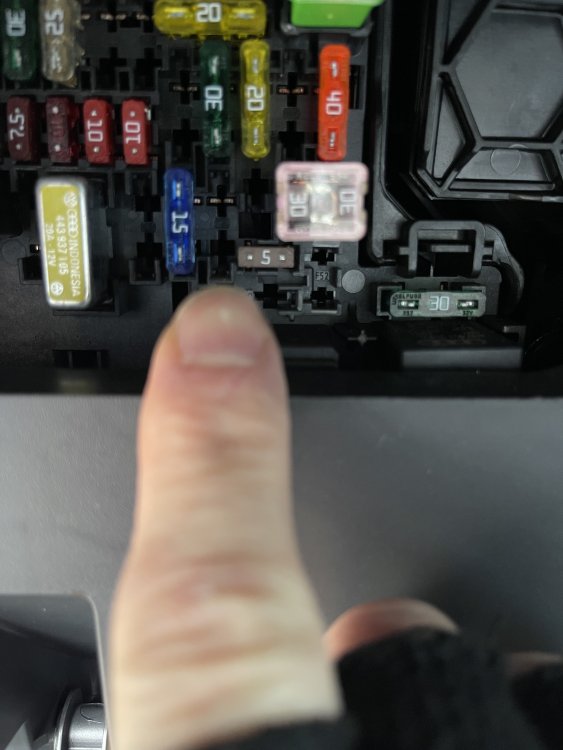

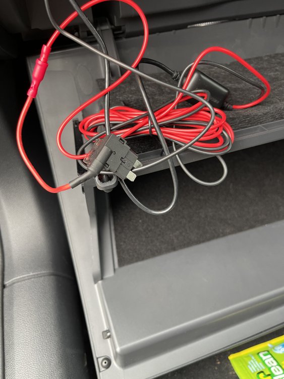

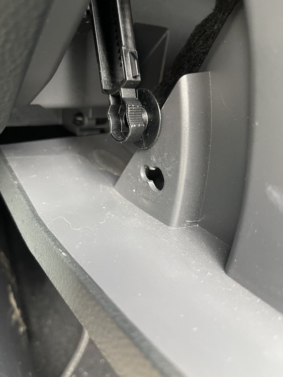

  9. Hi, not sure if you have sorted this yet but this is what I did. I used blind spot detection fuse number 48. It’s a 2amp one. (See photo 1 below) I used a Nextbase dash am hardwire kit. (£20 ish off Amazon etc). (I tried a cheaper Halfords one but the piggyback fuse wasn’t physically large enough so that was a waste of £10.) 1). Open the glove box and detach the left side arm where it meets the glovebox by unclipping the arm. (Photo 1 below) 2). Put fuse 48 into the dashcam hardwire piggyback (photo 2 and 3) 3). Earth to a bolt on body next to fuse board. Tuck the excess wires out of the way and that’s it.
