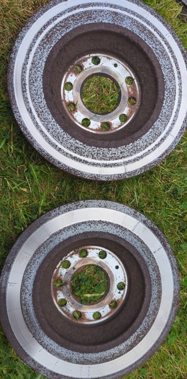

  2. Main difference with ours is the carrier bolts are recessed triple square unlike those shown in the video. Luckily they don't need to be removed to get the disc off. As I said, access is tight and the bolts didn't want to move for me anyway. Luckily I just had a go at moving the disc and it came out.
  3. Yeah I did, it wasn't too bad tbh. I didn't need to take the carrier off the hub only the piston part of the brake as the disc can fit in and out without removing it which is good as access for the bolts is a pig. Make sure you have the ability to turn of the electric parking brake. I have an OBD11 so wasn't an issue for me.
  4. Ive changed to some other discs and pads now so hopefully will do better. I'm not sure if they were changed before my ownership but I'm on 90k miles now. I do know I asked for them to be looked at before I bought the car but not certain they changed the discs or just the pads. Mines just hit 90k. But not sure they've been done before hand or not. They were awful. The matched the wear pattern seen there. The outboard faces had lips and areas that weren't swept too but nothing like the inboard faces.
  5. Should I expect this every time or will different brand change things now I've done them? Wasn't a bad job but don't want them to eat pads 😅
  6. What started as a nearside rear bearing replacement (aborted due to only having XZN 16 and not an 18) turned out to be a brake job. I've been having a bit of rumbling for a while so probably need it done still. I've never seen wear like this, outsides were a bit lipped but the insides were heavily lapped. New discs and pads hopefully will sort a bit of the rumbling!
