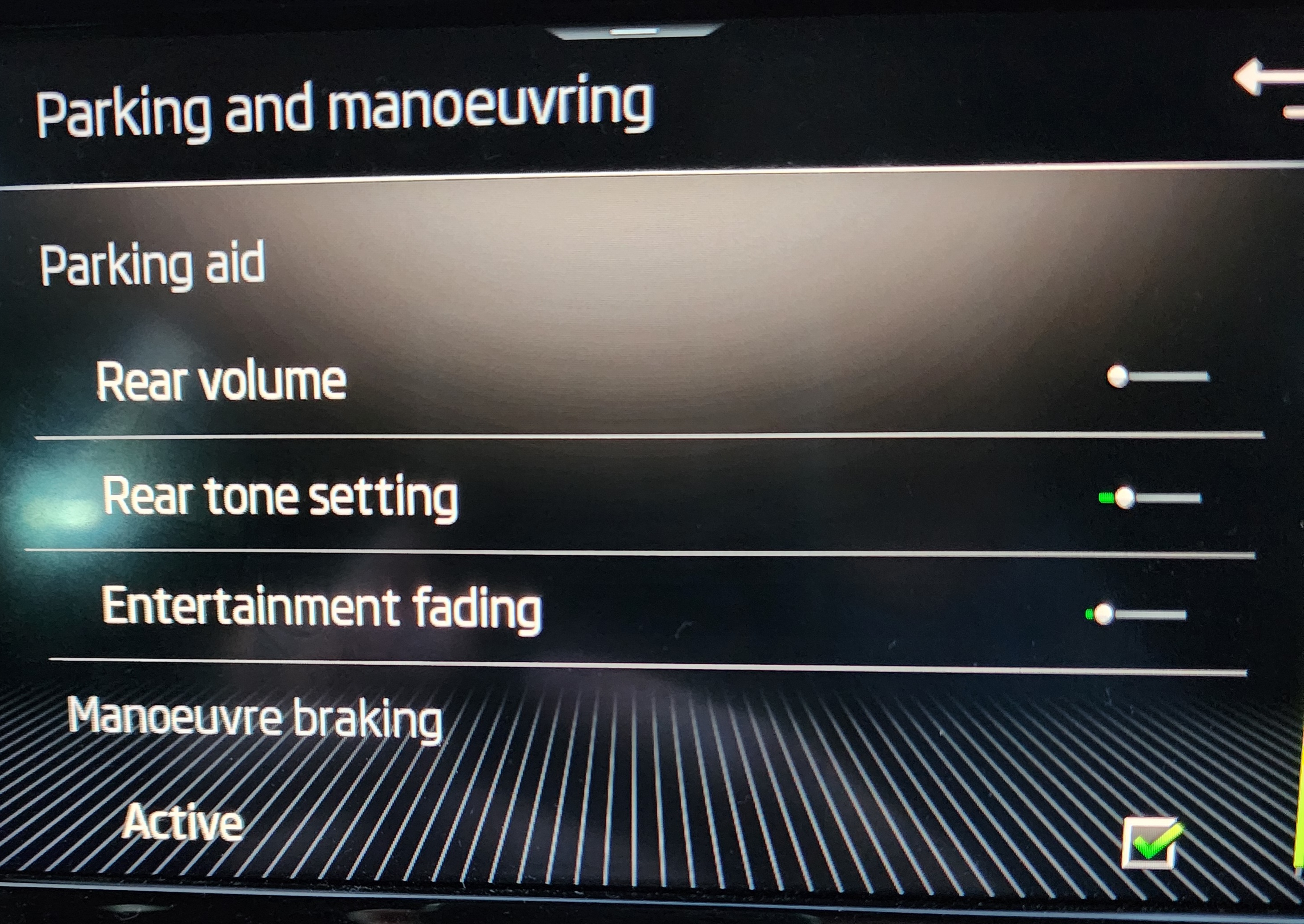

Reversing Icon
Reversing Icon
Yes it's auto breaking if it thinks you are about to hit something. Its done it to me several times and can miss read the object. You can't turn off the rear one as far as I can see in my car.
