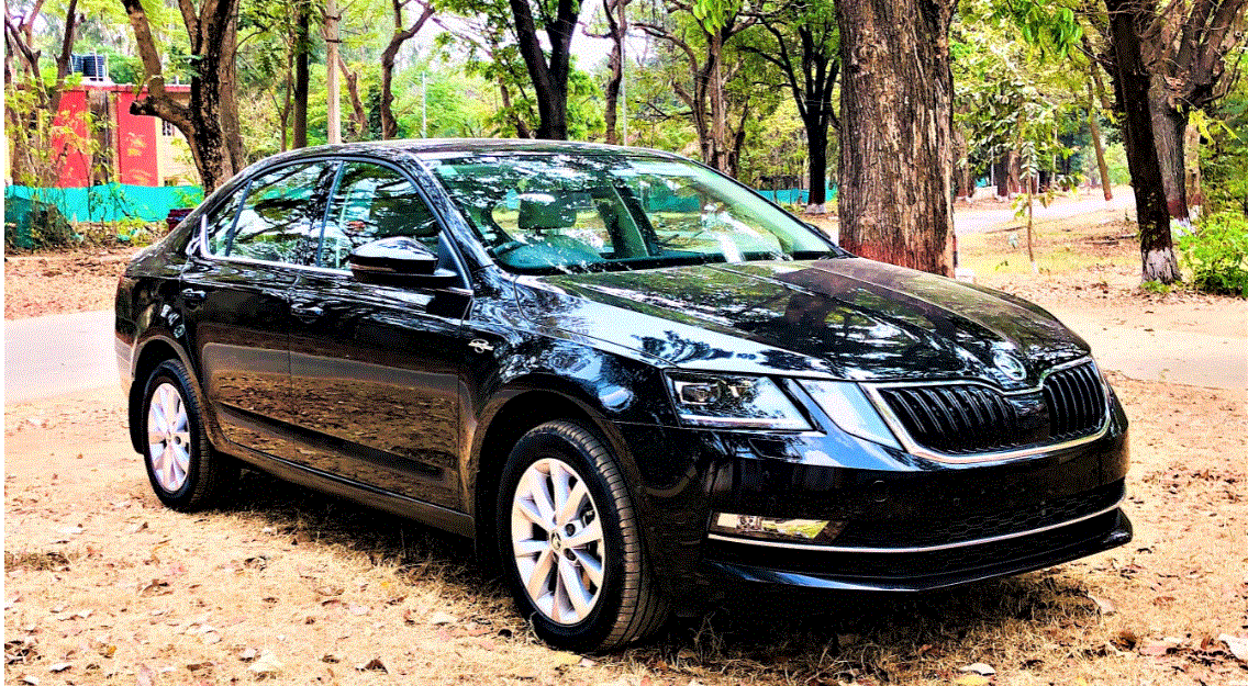

  1. The reason I ended up with a front 340x30 mm kit is that I got it from my friend who upgraded to an APR big brake kit. Now, with the 340x30 mm rotors lying around, the sensible way forward is to either get a 310 mm rear or get 312 mm fronts from the Kodiaq or 1.8 TSI Octavia and stick with the existing 253 mm rears. Rim size is not an issue as I'm on 17" Stratos alloys. Now considering that I have a pair of 340mm front with me, which option should I go with?
  2. Mine is a 2019 Octavia 2.0 TDi notchback with F288m and R253mm. I have a set of sparingly used F340mm from my friend's VRS245, this has been lying with me for over a month now and hasn't been swapped yet. I was thinking of getting a new R310mm assembly to go along with F340mm, after reading all these responses wanted a suggestion does it make sense to get both front and rear swapped or will F340mm do the job well with my existing R253mm?
