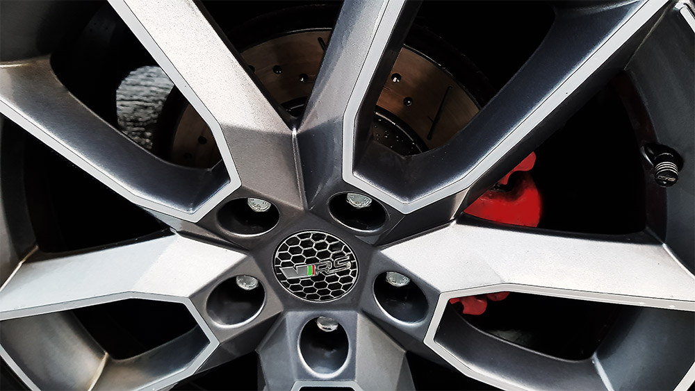

Thanks for the replies. FYI I have the 340x30 fronts (it's a TSI RS).
To be honest, it's 85% aesthetic and 15% performance motivated. So the performance benefit is not really a big deciding factor. I know the rear brakes don't do a lot because I've almost done 70k kms, and my rear rotors and pads pretty well look unused :D
I just don't know if there are any cheaper options for shrinking that gap between rotor and wheel. Honestly, if the front brakes weren't so wheel-filling it probably wouldn't bother me haha.

So I did eventually go to the 310 rears from the RS245 but needed the dust shield from a GTI PP since the 245 has the different track and different "wheel bearing housing"/knuckle, so the RS245 dust shield doesn't actually fit. I think the ABS module or something had to be re-routed too. I then went to ATE ceramic pads / ATE plain discs front and rears.
What I did want to mention is that a) like I thought, the stopping power doesn't feel drastically different, although I figure the ceramic pads are less 'bitey' than the stock pads; and b) the brake bias is noticeably different with the 340/310 setup. The car feels more balanced on the brakes, rather than being nose-down with the 340/272 setup - although I can imagine this could actually be beneficial in terms of shifting weight to the front axle.
