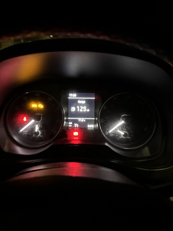

  5. Its the cruise control. I was just using it before I stopped. I use it a lot so it something gets left on.

  7. Hi, Last night for the first time since I bought the car just over a year ago I noticed that it said SAFE on the Maxidot screen where it would normally show the trip miles. Does anyone know what it means?

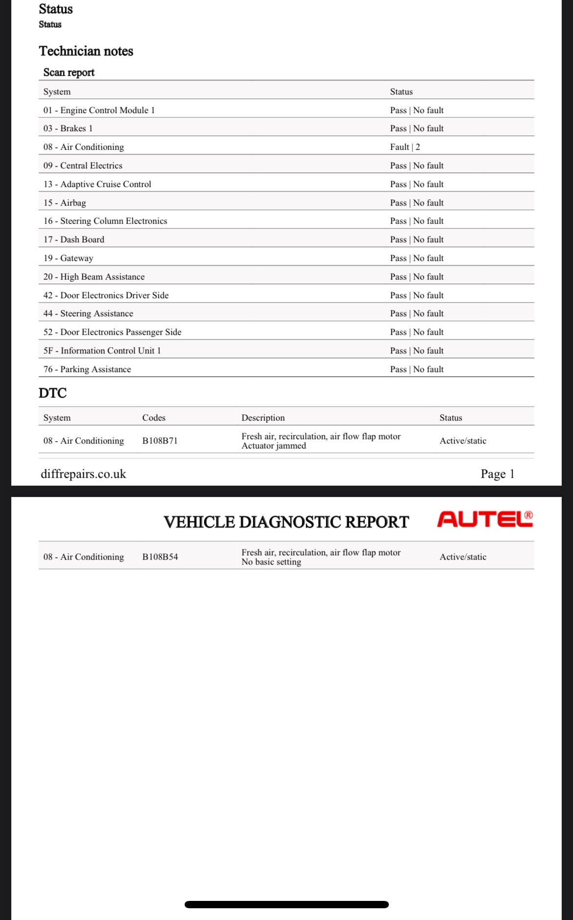

  9. After much money it is now fixed. They also updated the software that fixed a light fault message.
  10. Well, turns out it's the cheaper option as the motor is the one they have in stock. Should be done tomorrow. Got a brand new Fabia DSG as a courtesy car so i'm not in a rush. 😀
  11. Well, I finally got a quote. £470 to replace the flap motor. I guess its quite a lot of disassembly to get access to it. I was also told that Skoda used two different types of motor and they won't know what one is in my car until they take it apart. Also only one type of motor is currently in stock. Why did they have to make it so difficult? 😕
  12. I rearranged everything and found out that if you take the screen out, the main unit will fit behind it quite nicely as there is a lot of space.
  13. It’s booked in for a service on the 22 September so i might just get them to do it if I can’t get to it. Thanks for the help. 👍
  14. Ok, I was able to find someone with a fancy code reader. It would seem there were a number of fault codes related to the air flaps. After resetting them all, this is what’s left. Looks like it is possibly a motor fault?
