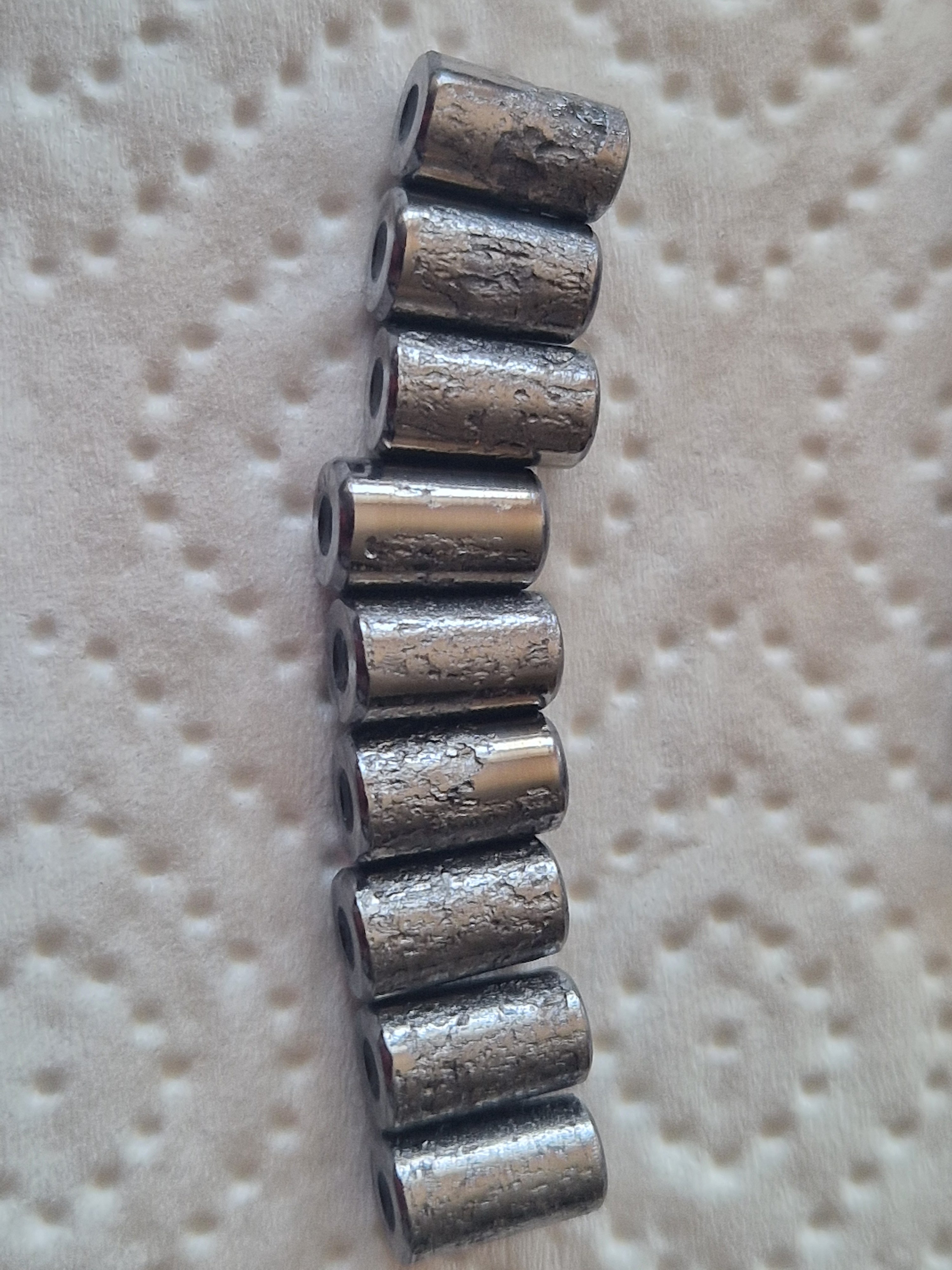

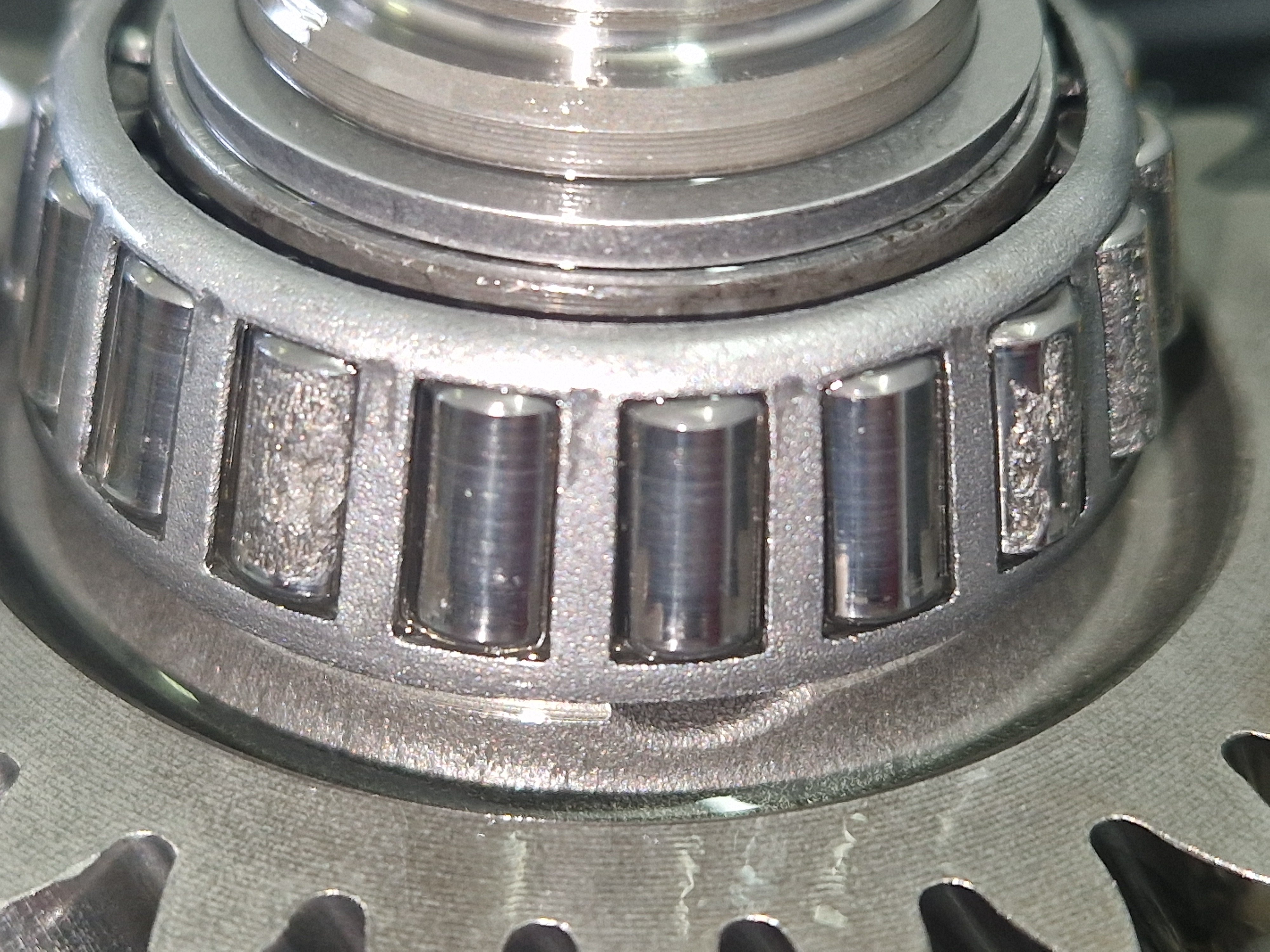

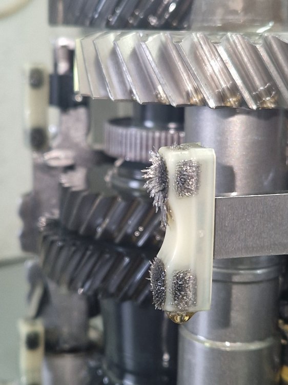

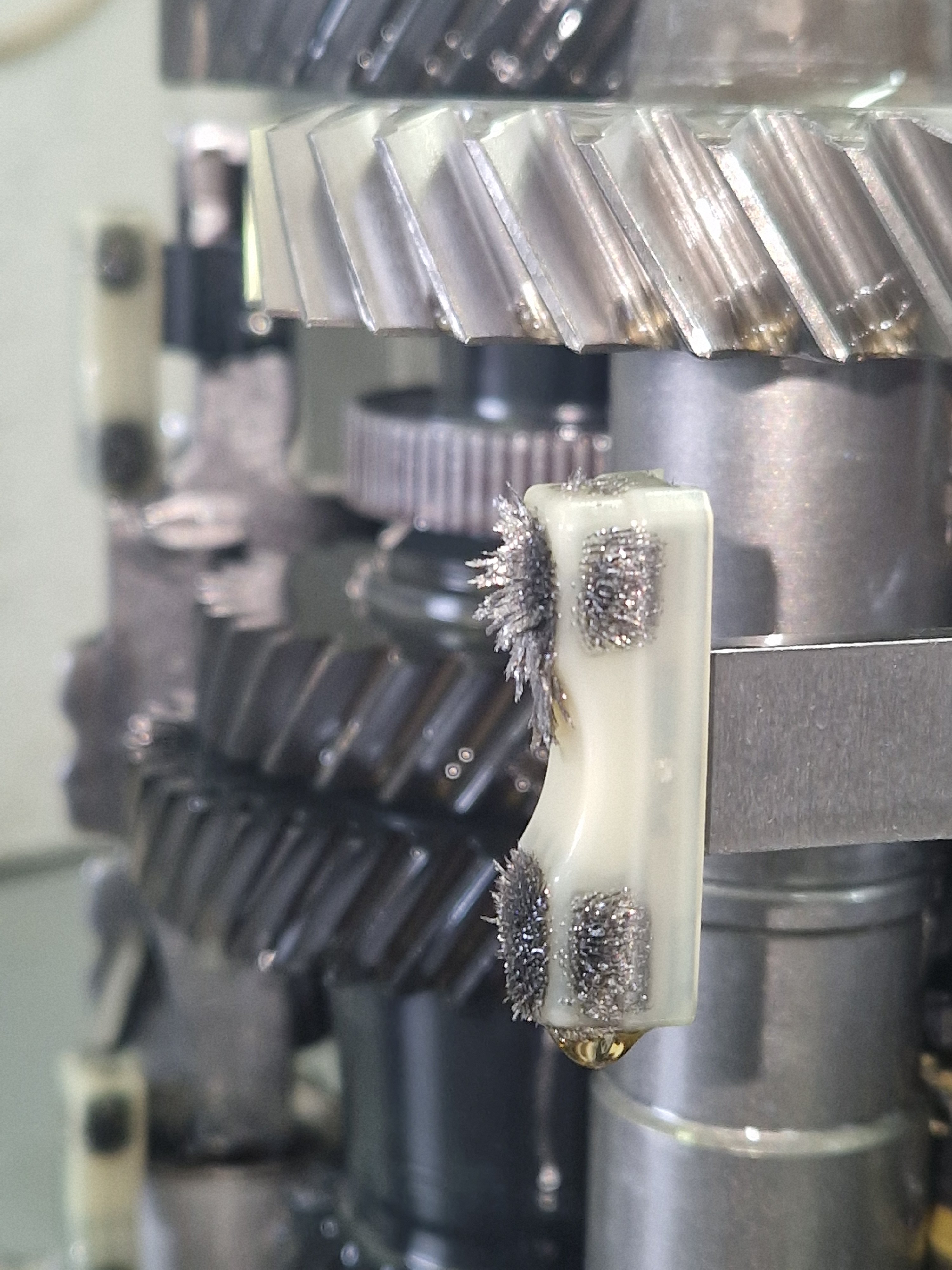

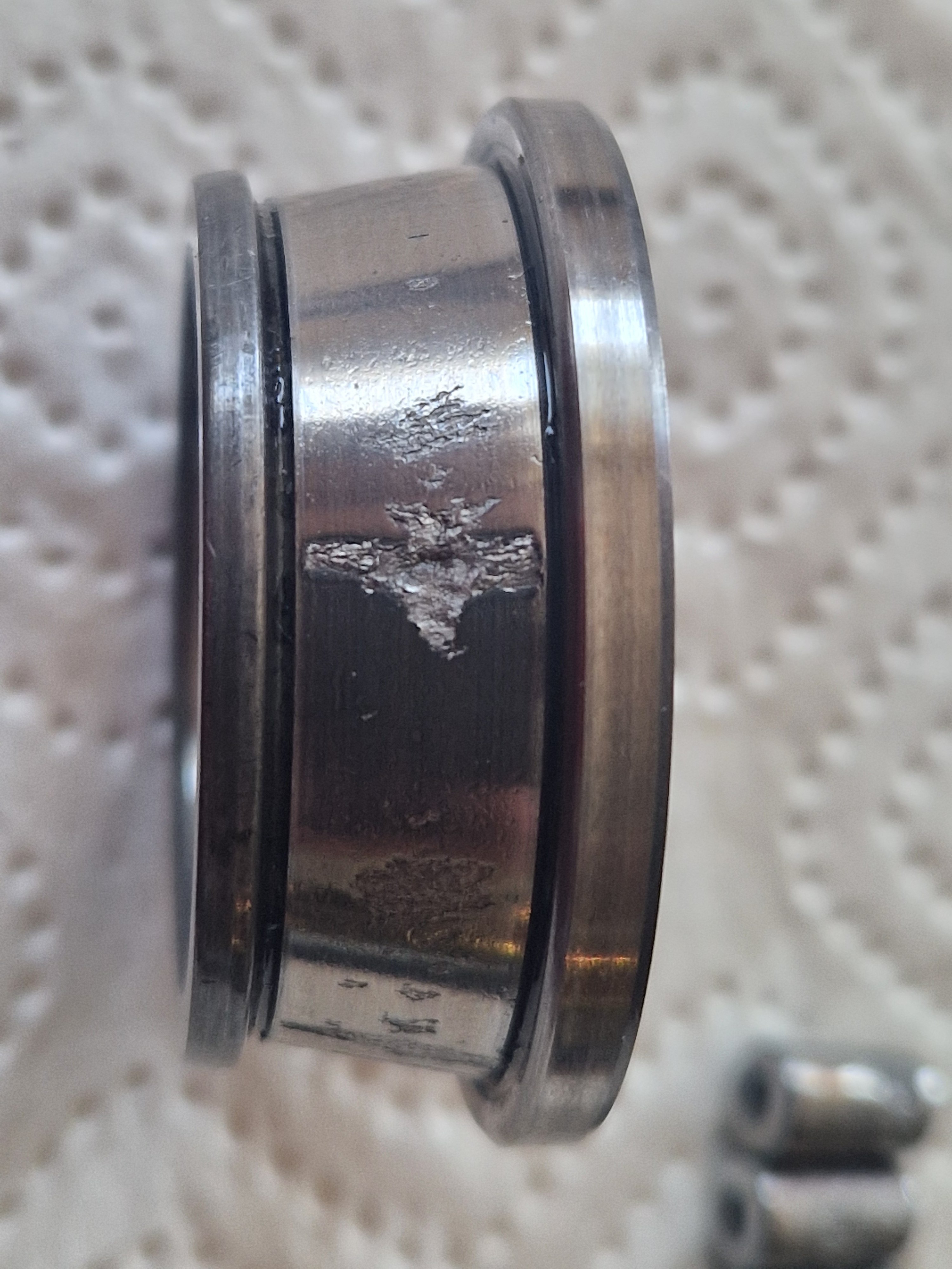

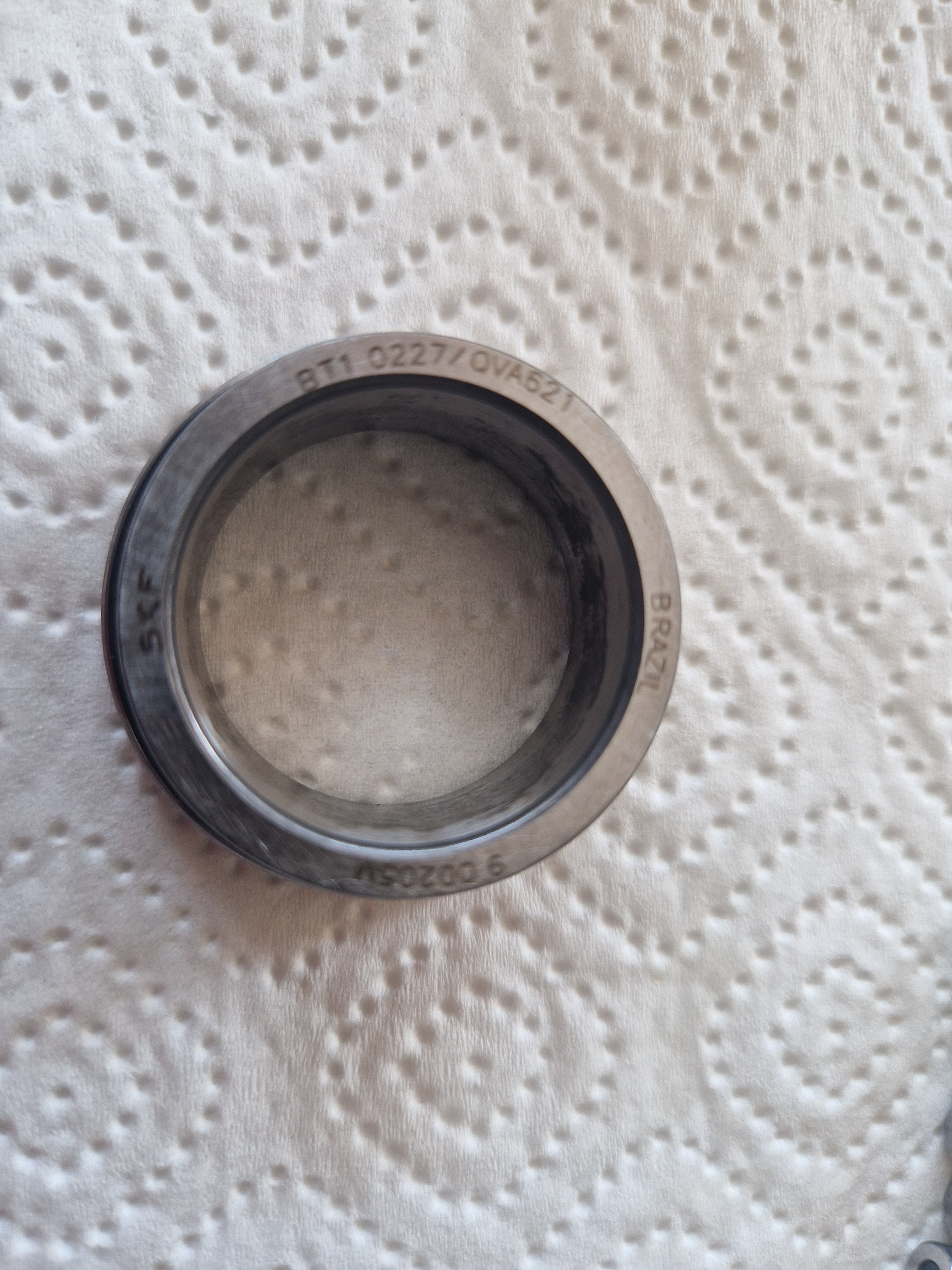

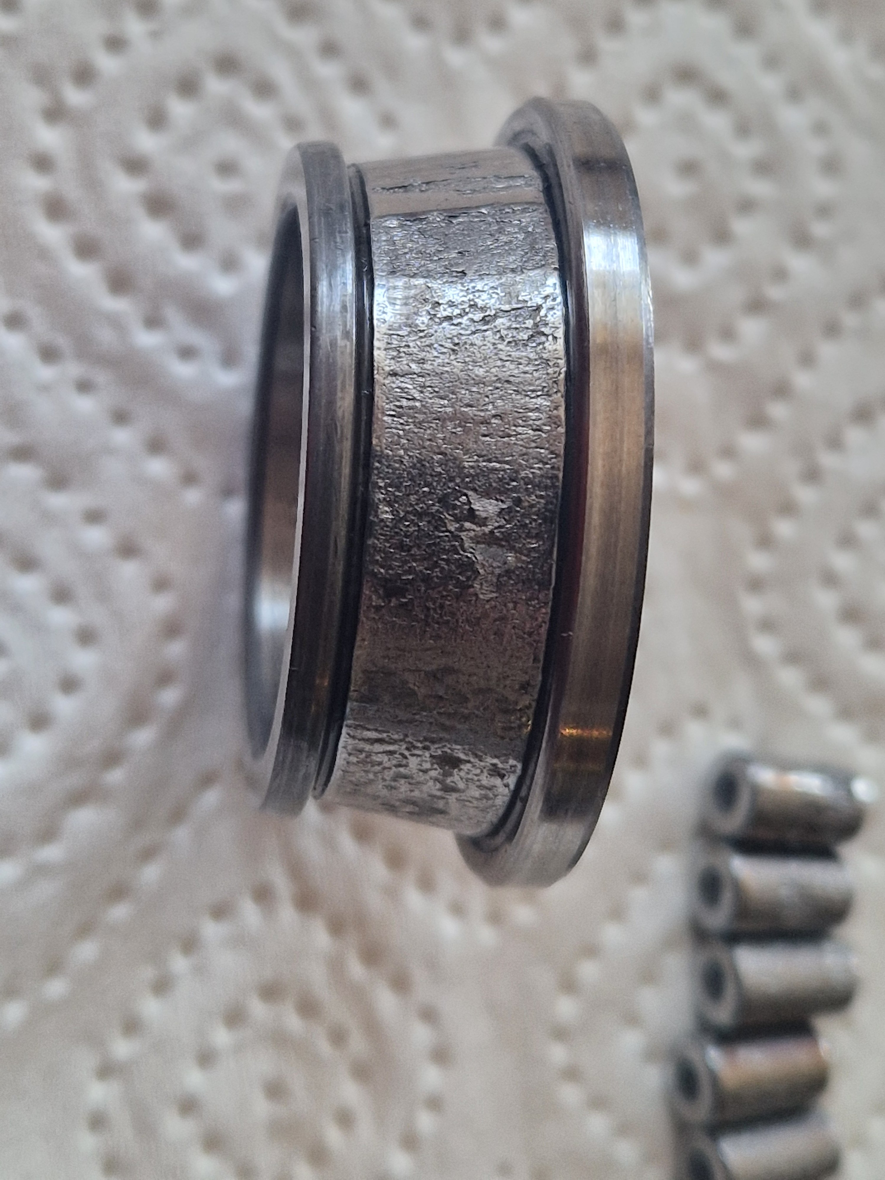

  7. Hi Im from Croatia so this info wont be of much use for you as I'm guessing you are located in UK? The price of repairs was 1.2k euros, the parts (bearing, filters new oil and other bits and bobs that you do "because you are already there) were not expensive, but the labor was (800€ to be exact). The repair was done by a DCT expert that worked at official repair shop for over a decade before he opened his own shop. I guess if i went to official dealer the price would likely double if not triple. If you have the same issue, it would be really great if you could also take photos of the bearing. This could be a bad batch from SKF. I hope you get your car sorted. Good luck.

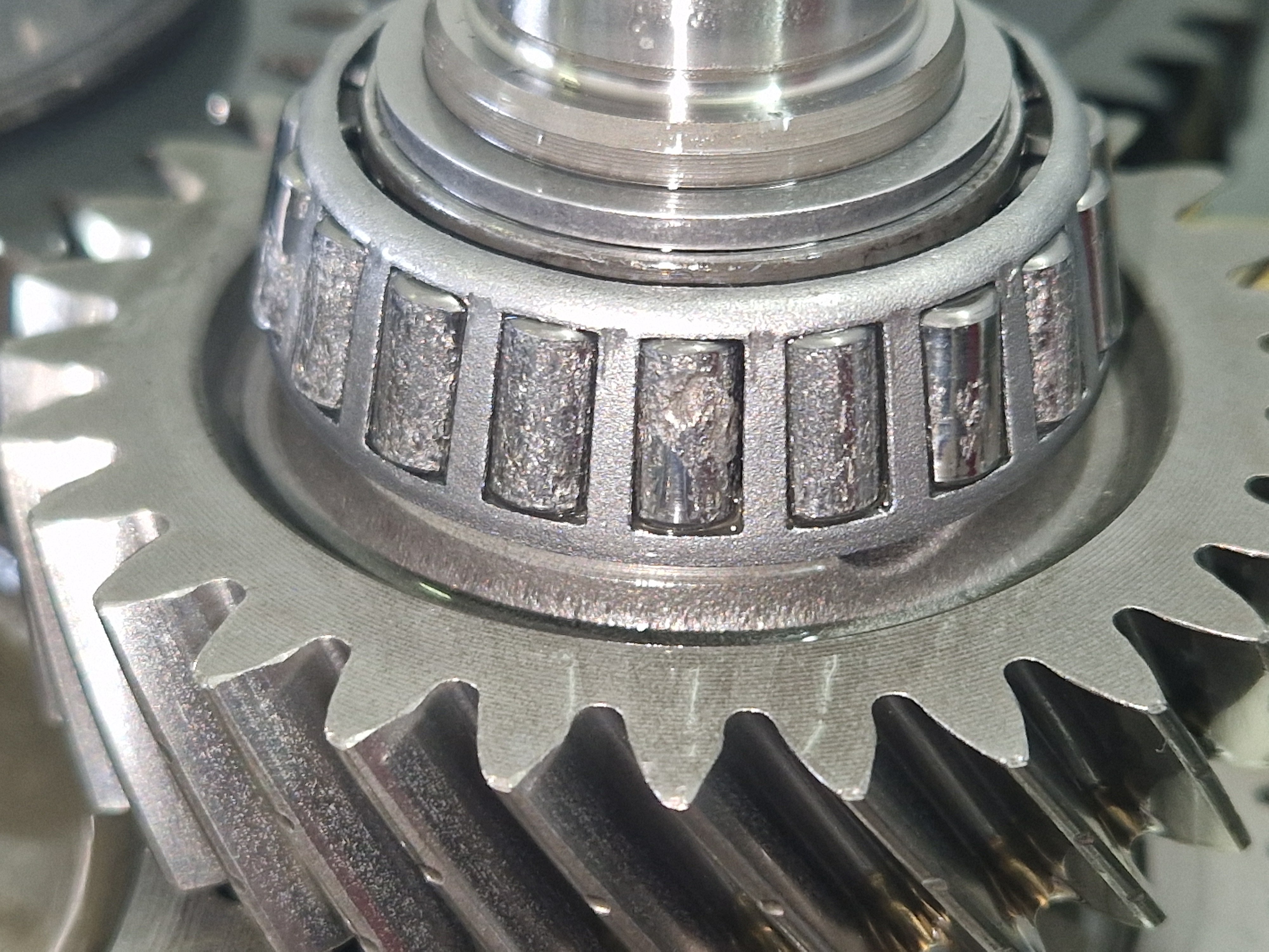

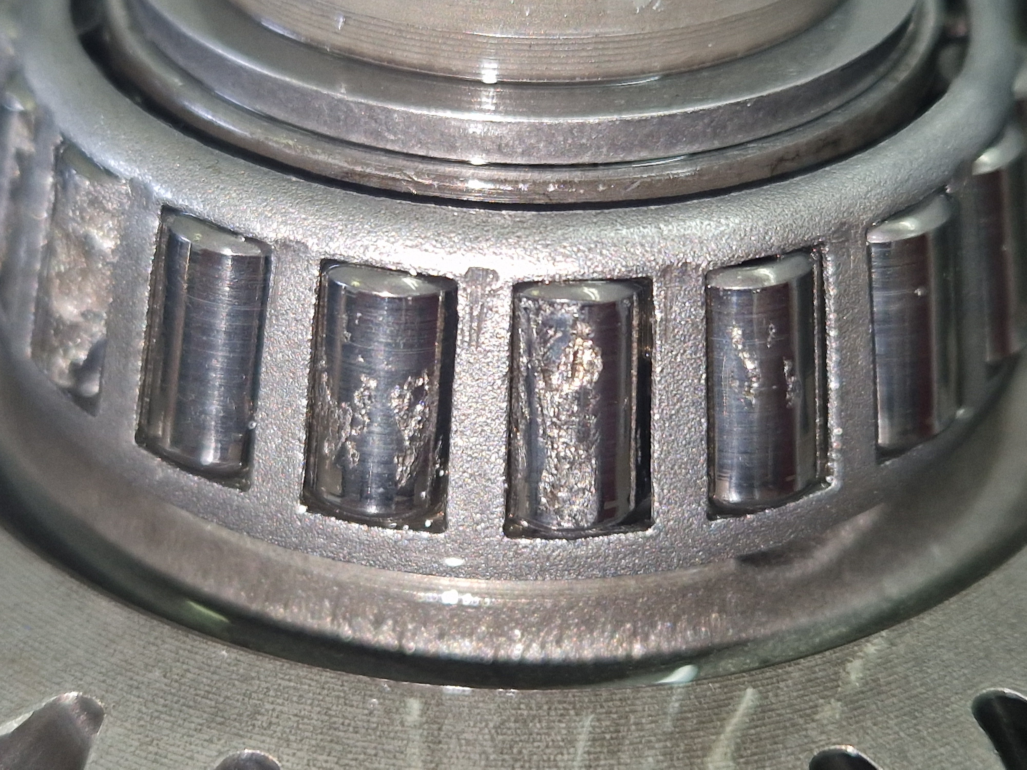

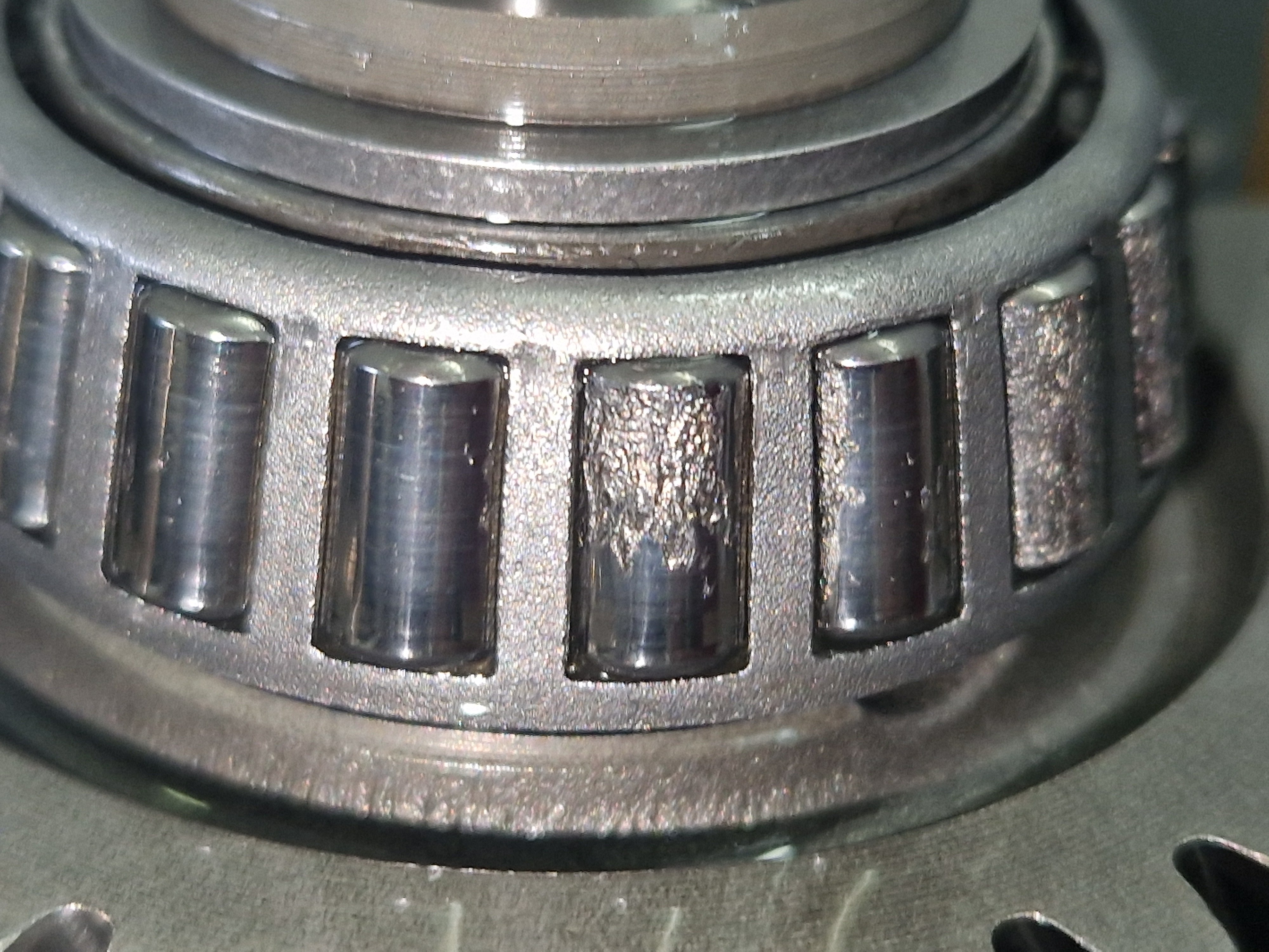

  8. Yes, several people, with knowledge of material sciences, and the gearbox specialist, all commented the same thing. They all said that carburizing (i believe that's the English term) failed and thats probably a manufacturing defect. No one happier than me :)
  9. Well, the gearbox is repaired and the car is back at converting gasoline to happiness. 🤩 Except the bearing, nothing else was damaged, but several other items were replaced, the list is as follows: Clutch pack cover/gasket Pump gasket Gearbox casing gasket Cover gasket Inner filter Outer filter Output bearing of the main pyramid In retrospect, there might have been very subtle sounds that signaled to something going wrong, but i would have never guessed its the gearbox problem. Another interesting fact, the bearing is made by SKF in Brazil. Anyway, here are some more pictures.
  10. What is odd is that it failed "at once". Usually these bearings fail progressively, first producing some humming, whistling sound that gets worse over time. This went from no sound to "what is that horrible noise" in one 150 km drive. Granted, it was a spirited drive on the highway, but still...
  11. The bearing got pounded hard it seems. Lack of lubrication would be the main suspect, but the gearbox was not low on oil... could be just bad luck or the car sat at side incline (this did happen) before being driven. More teardown will happen, and I will post final verdict.
