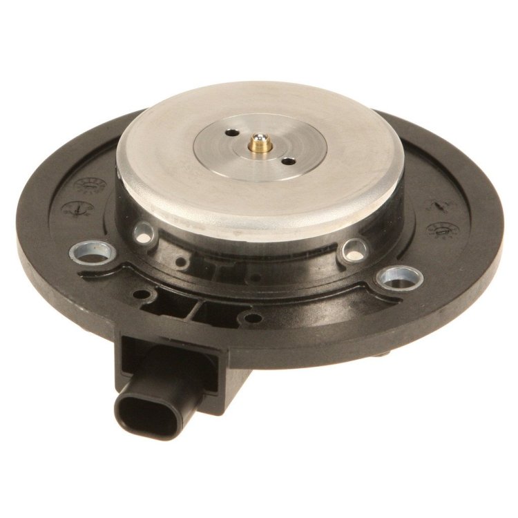

The part on my car is: 06L 109 259 A, see attached picture
When you search for replacement parts one of the choices you get is INA 427 0034 10 which has a part number on it 06L 109 259 E
Now i know that parts get updated over time (hence A, B, C... variants), but the issue here is that construction is not the same.
INA part i doesn't have a full metal disc, but rather a metal disc surrounded by plastic. Also it doesn't have two holes in front like the original does. I presume the holes are for oil, but i have no idea what purpose the oil has in a magnet actuator.

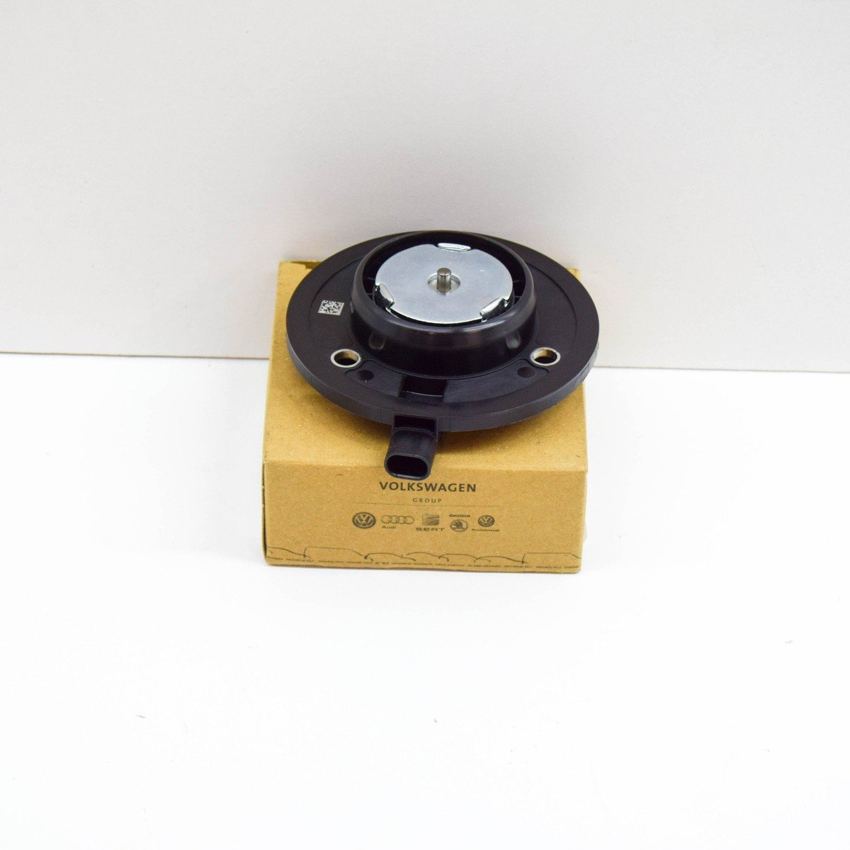

Anyway, check out the second image of the E variant.

- Will the new revision function correctly? I'm sure the magnet does the same thing, but the lack of oil holes is somewhat concerning (why would there be holes if they are not needed).
- Could it be that the revision removed the holes because it gunked up the actuator and made more issues than it fixed? Is this why they fail?

Reassuringly, if I search partslink24 for 06L109259A for a 2015 Octavia, it shows as being dropped on Apr 1, 2018 and superseded by 06L109259E.
£58.60 + VAT each at Skoda.
AfIk ina is the oem supplier. The oem and genuine part should align in design, perhaps with some delay.
I,ve replaced both my electro magnets, with Ina items. About 3 or 4 years ago, at that point, the oem ina item and oem were the same form and design, with a large metal chamber and two holes.
One word of caution, what exactly is your error code, as it sound more like the variable lift system rather than variable timing advance.

I got the same info, but what i cant confirm is if the E is physically different from A. When googling the E part both designs pop up, so im just trying to get confirmation that the E is indeed a newer design that is different from A.
If it wasn't different in some way, it would not have a different part number.
