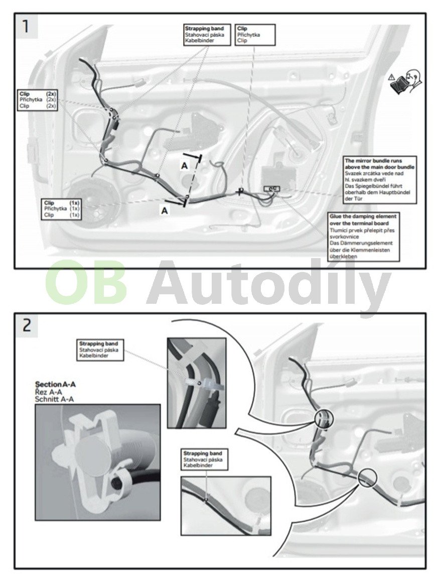

  3. Yes, this I recieved complete mirror with cable. Only carefully you car must have dimming back mirror (I don't know exact name in english) inside car. This mirror sending info to door mirrors + correct equipment, side assist or area view. Exactly what you have now on car, because connector could be diferent :) But I think on LHD, your driver mirror have dimming function.

  5. Hi, Same tupid feeling I had in my Scout 23. In Skoda I ordered original complete mirror without cover. In my country cost cca 220€ (3V0072538A without area view). Change was for 1 hour original Skoda service. It is simply plug and play. But car is in warranty.
