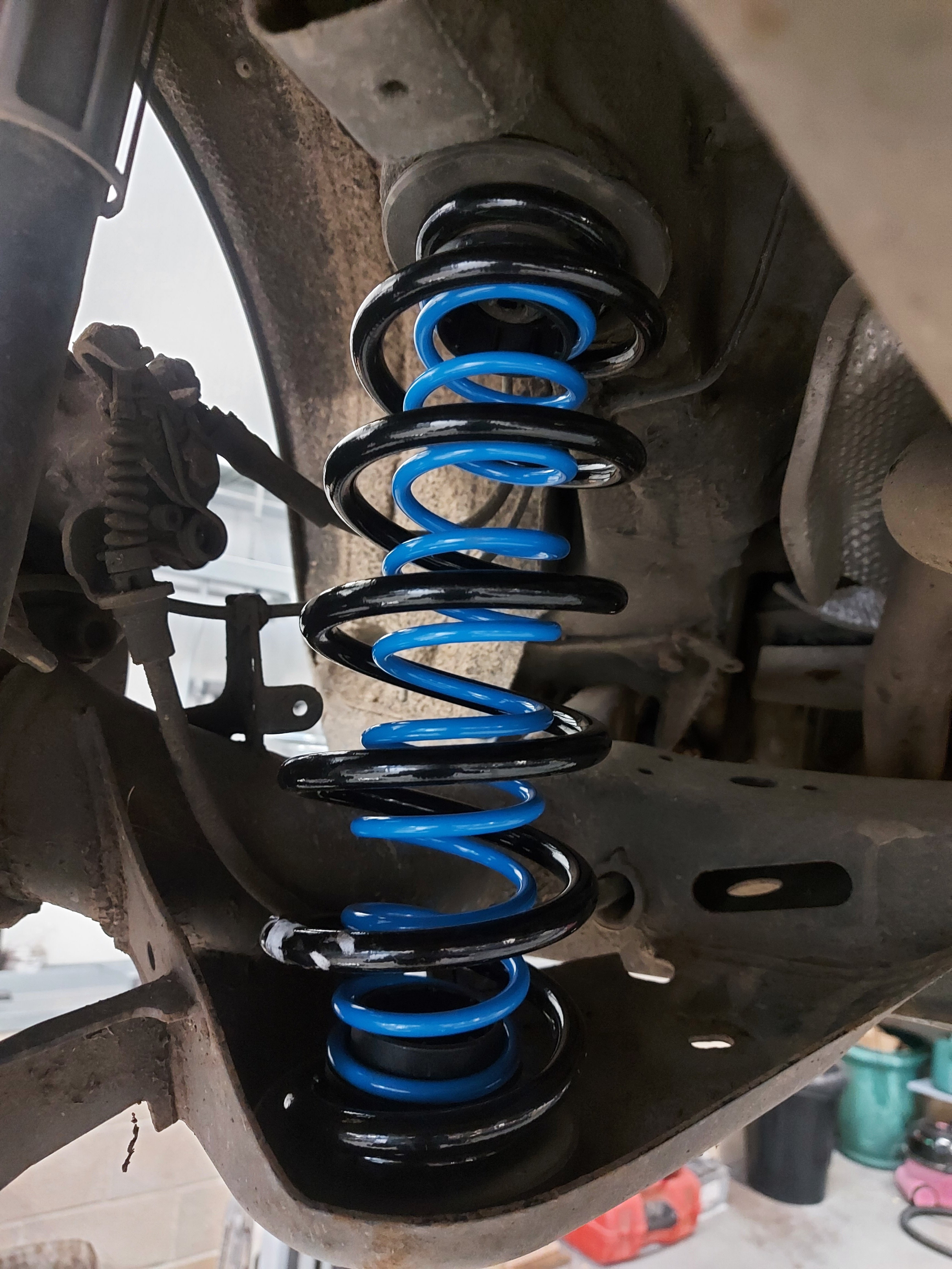

and on the car beautiful, thanks to Jon at Quattro Tech Cambridge for fitting the springs and taking the photographs.

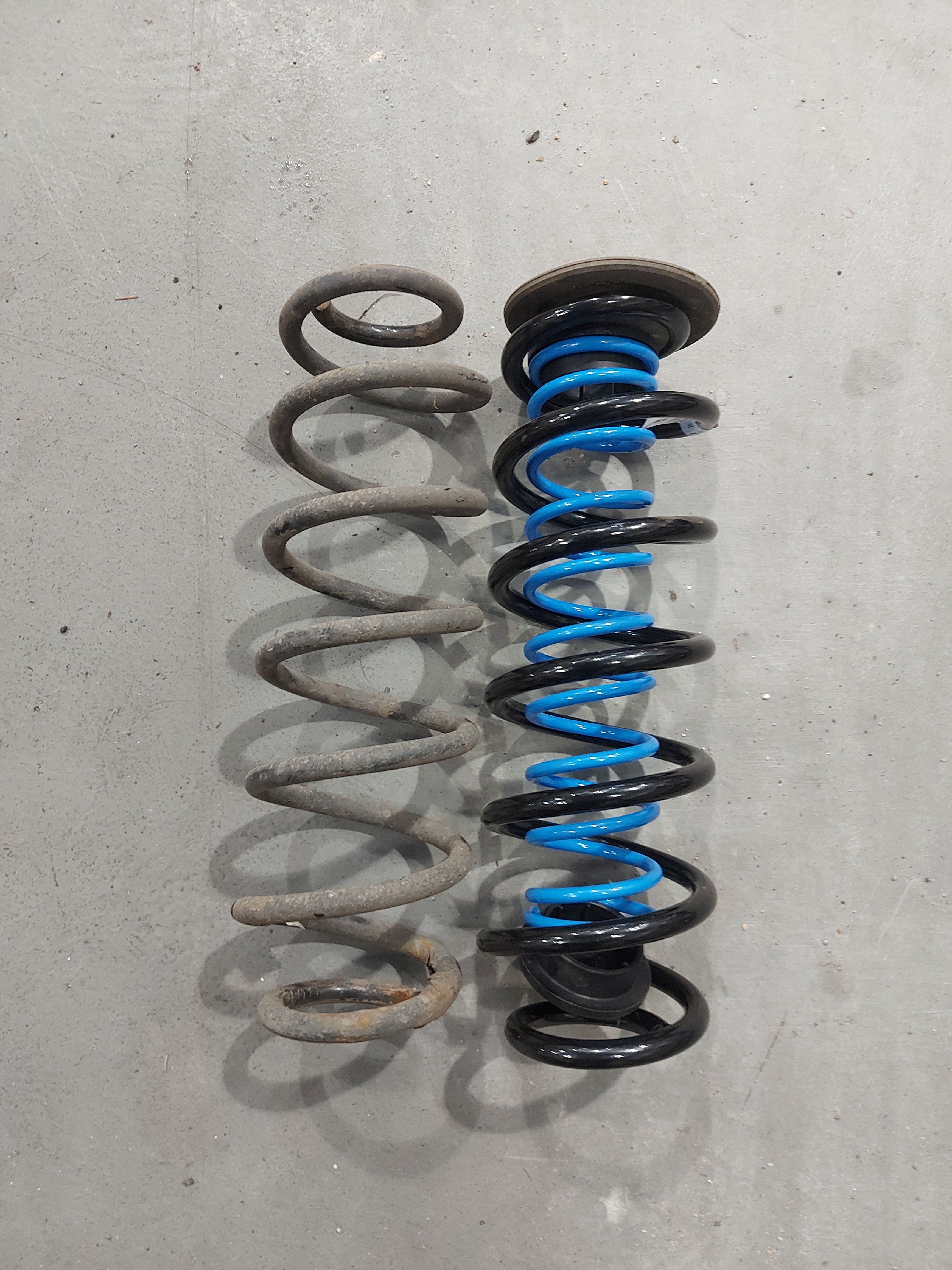

Had the new springs and helpers fitted today image of the old and new spring and the helper inside the spring ready to be fitted

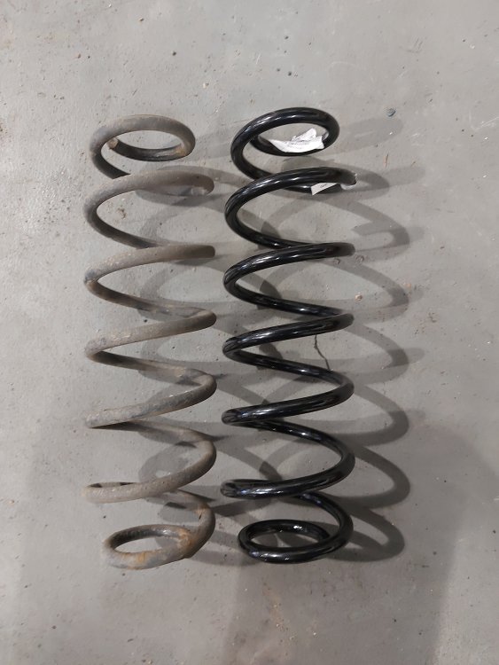

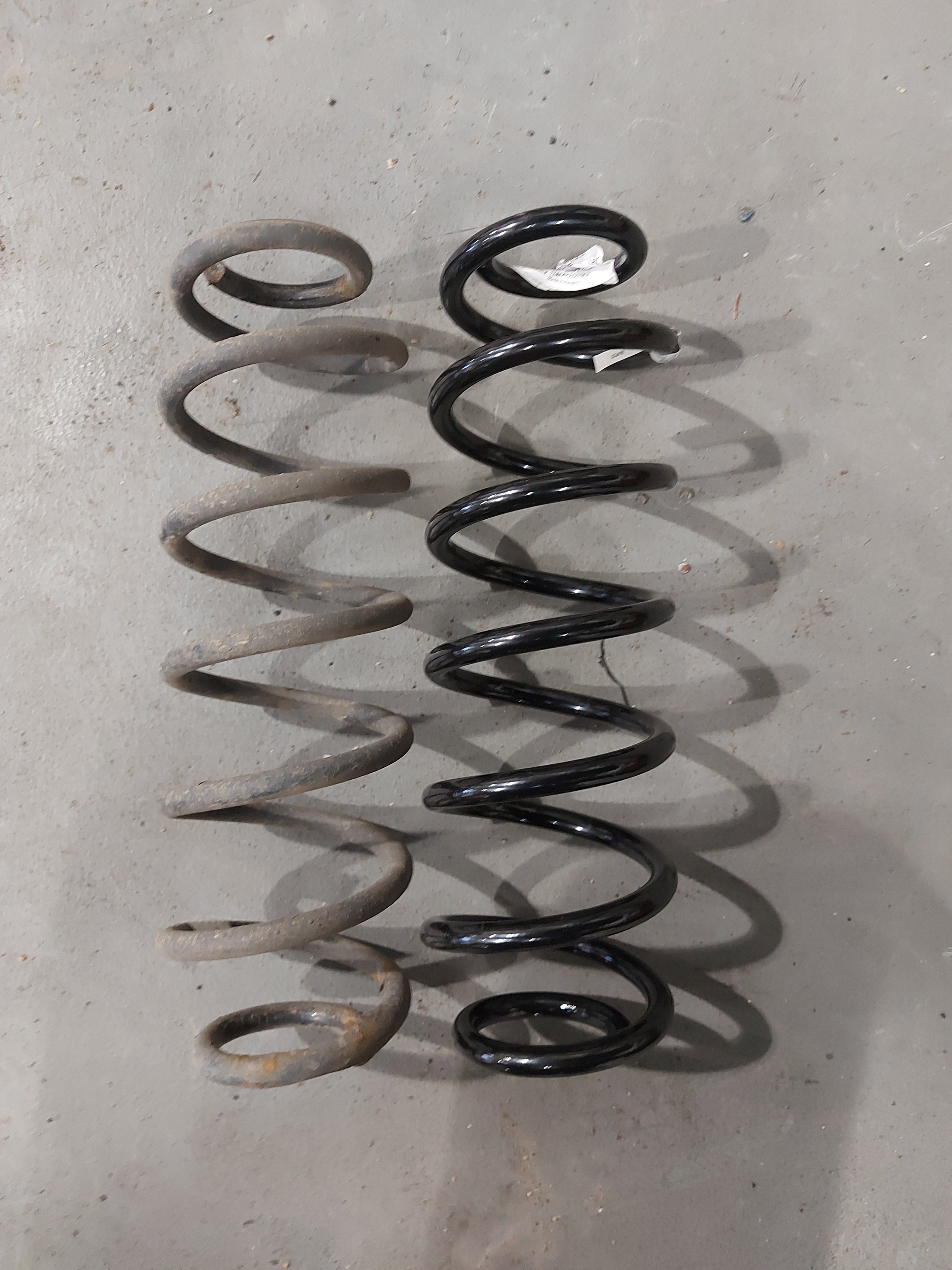

Telephoned Vindis Skoda Service Centre Cambridge yesterday to ask if they would change the rear springs at the service on Wednesday.... no sorry, can only fit the same part number. However, parts were a little more helpful. I have AD's, they are going to order AF's for me to collect at the service. Ordered helper springs from Mad Suspensions and Quattro-tech Cambridge will fit both on Thursday or Friday. Will let everyone know how it goes.
