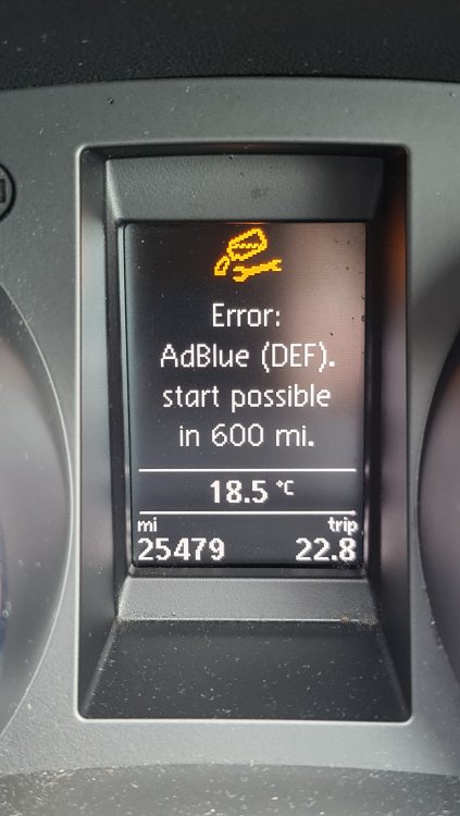

  1. Rich71 replied to Rich71's topic in Skoda Yeti
    Update. Got car back from garage this morning. They dismantle the AdBlue tank cleaned pump and all sensors and filled, all working now and show correct miles left
  2. Rich71 replied to Rich71's topic in Skoda Yeti
    Yes have done over 50 miles.
  3. Rich71 posted a topic in Skoda Yeti
    Hi all Just had the Error: AdBlue (DEF). start possible in 650 miles come up. Topped up adblue and still the same. Going to book it in later. Got a feeling its could be the NOx sensor as all seem to be related. Have tried the rest procedure st the same. Any thoughts on what it could be. Thanks.

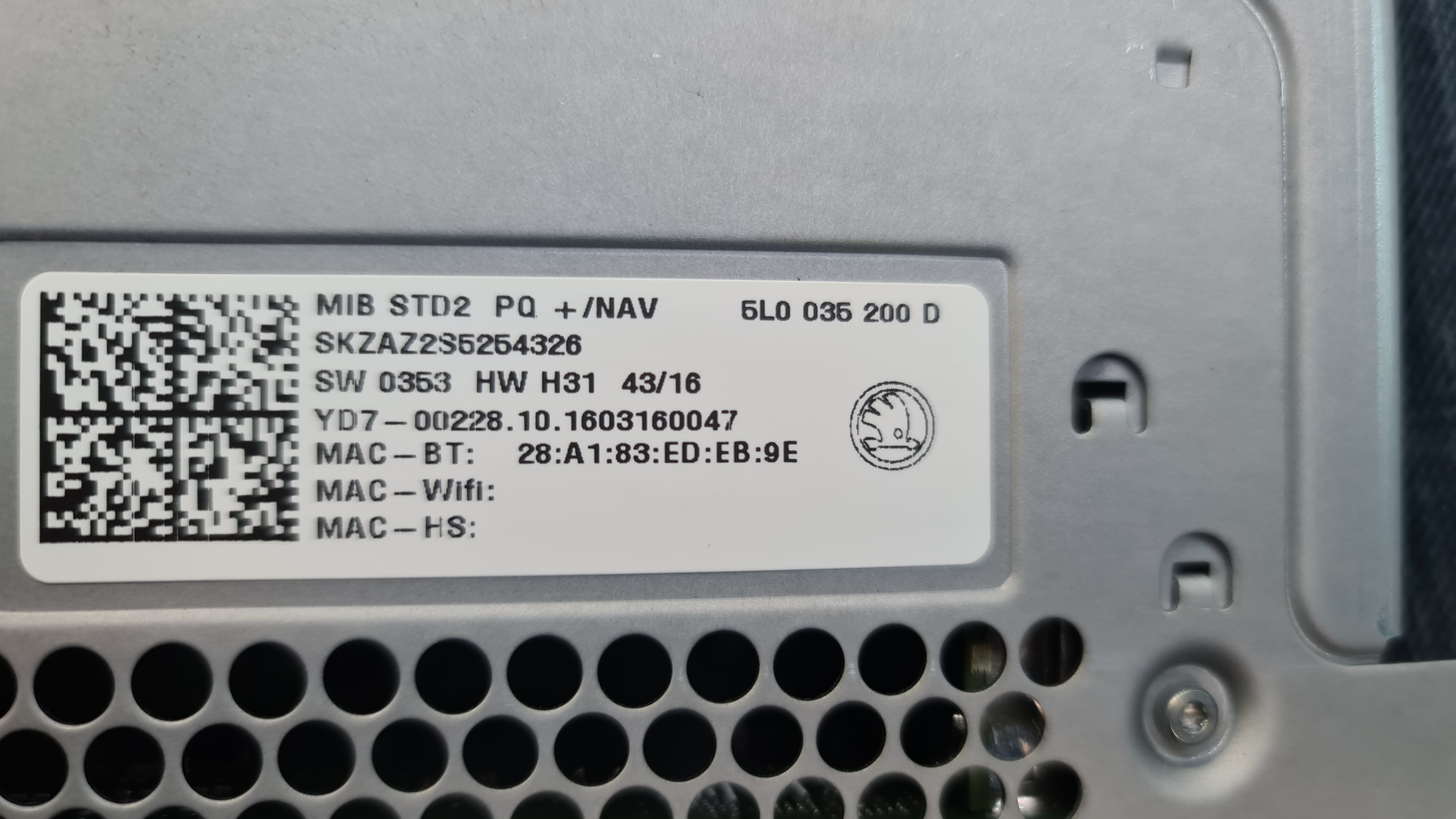

  5. Rich71 replied to Rich71's topic in Skoda Yeti
    @pab567 hope the above is the information you require. Also photo of the front. Thanks again.
  6. Rich71 replied to Rich71's topic in Skoda Yeti
    Hope this helps Thanks
  7. Rich71 replied to Rich71's topic in Skoda Yeti
    @pab567 any advice please on my post above. Was thinking of a firmware update but I don't have the SW version or anything. Would it be possible to force a standard firmware without anything showing on the screen? If so please can you send so I could try. Thanks

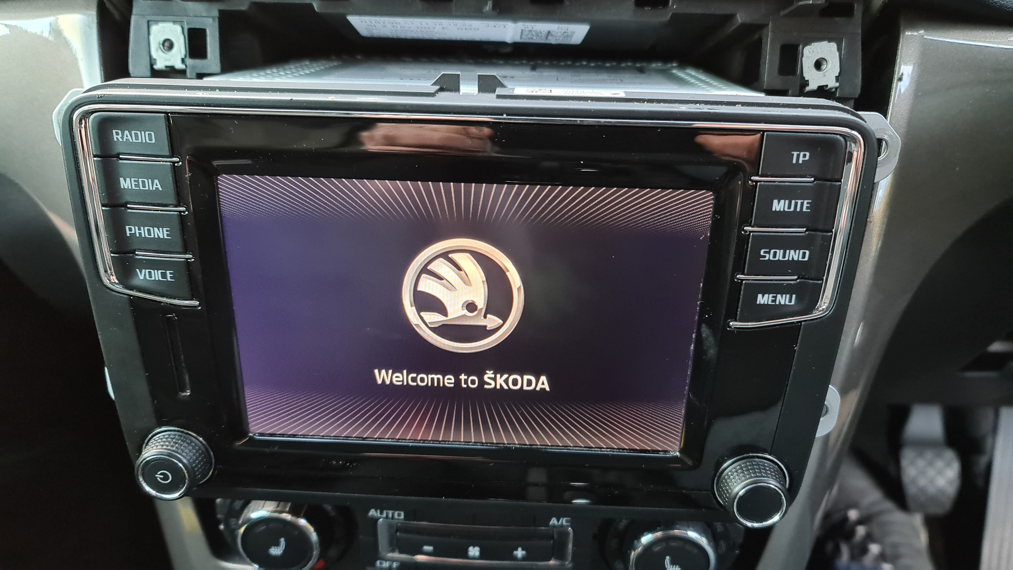

  8. Rich71 posted a topic in Skoda Yeti
    My Bolero has been working fine up until a few weeks ago. Came back to the car and started driving it home and noticed the clock was not showing. Turned unit on and just got start up screen and radio playing I was unable to adjust volume or anything. After about 30 seconds it would reboot (go blank then logo screen appeared) still only showing logo and plays radio . Got home removed fuse 8 and still the same. Disconnected battery still the same. Reversing sensors still work but no display. Now and then I can control the volume (stuck on same station). No Bluetooth connection. No radio display in the matrix. Maybe a forced firmware reset needed @Pab567 any ideas greatly appreciated. Thanks Richard.
  9. I have noticed mine doing the same in the cold weather.
