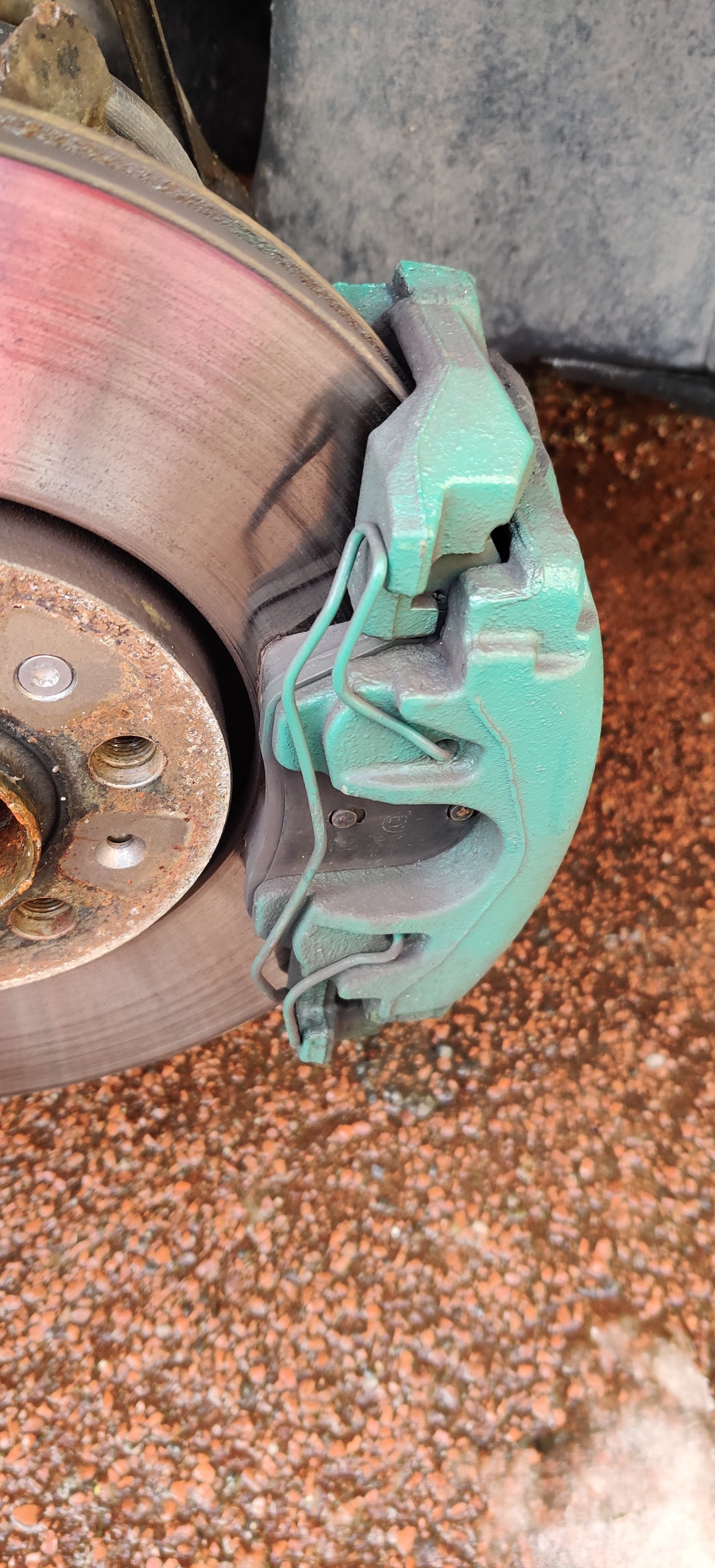

  4. Is there any relation between the LUCAS / TEVES systems and the TRW / ATE that you are aware of? I assume the older models or smaller power engines with smaller brakes use the TRW and therefore the LUCAS. Then newer models or higher power engines use the ATE and therefore TEVES. I am also looking to upgarde my fronts from 288 to 312 and based on info from this thread i am assuming i only need carriers and discs, i.e. same calipers and pads can be used as i have the newer ATE (2013 model) and it looks like my calipers are TEVES. Thanks for info btw, very helpful. Please excuse the bodged and dirty caliper paint.
