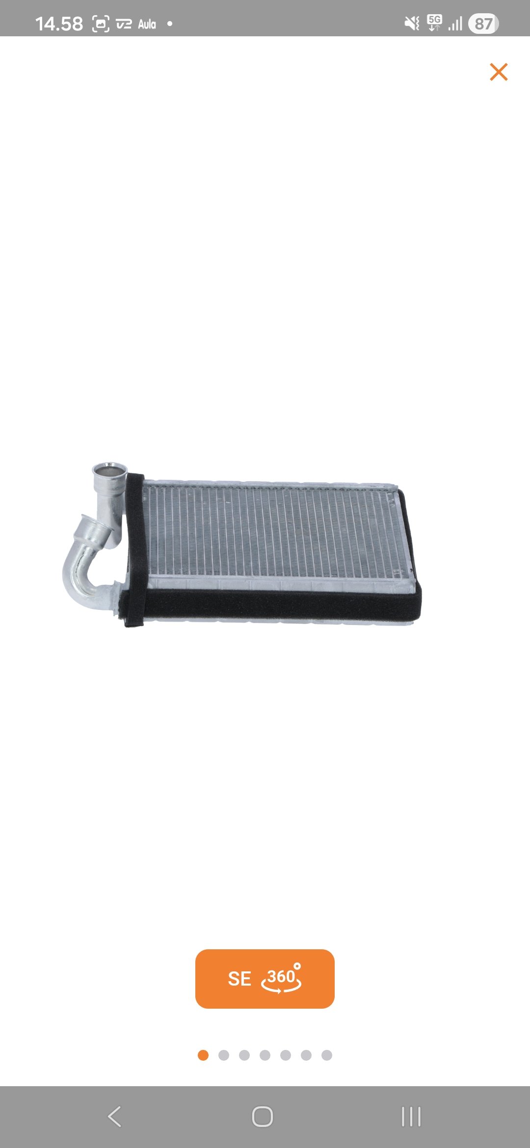

  3. Yeah but the parts is different. Look at the photos.
  4. Hi. But these two parts is different if you look up on Nissens or other companys website. One is Denso and one in Valeo. But both of them will fit my car it says. So i dont really know how. And the heater is also different. I saw brunch of videos and it is different which one the each car have in it. Ok i will order it without silikat. And then i use to G12 evo coolant only right? Because it is without silikat?

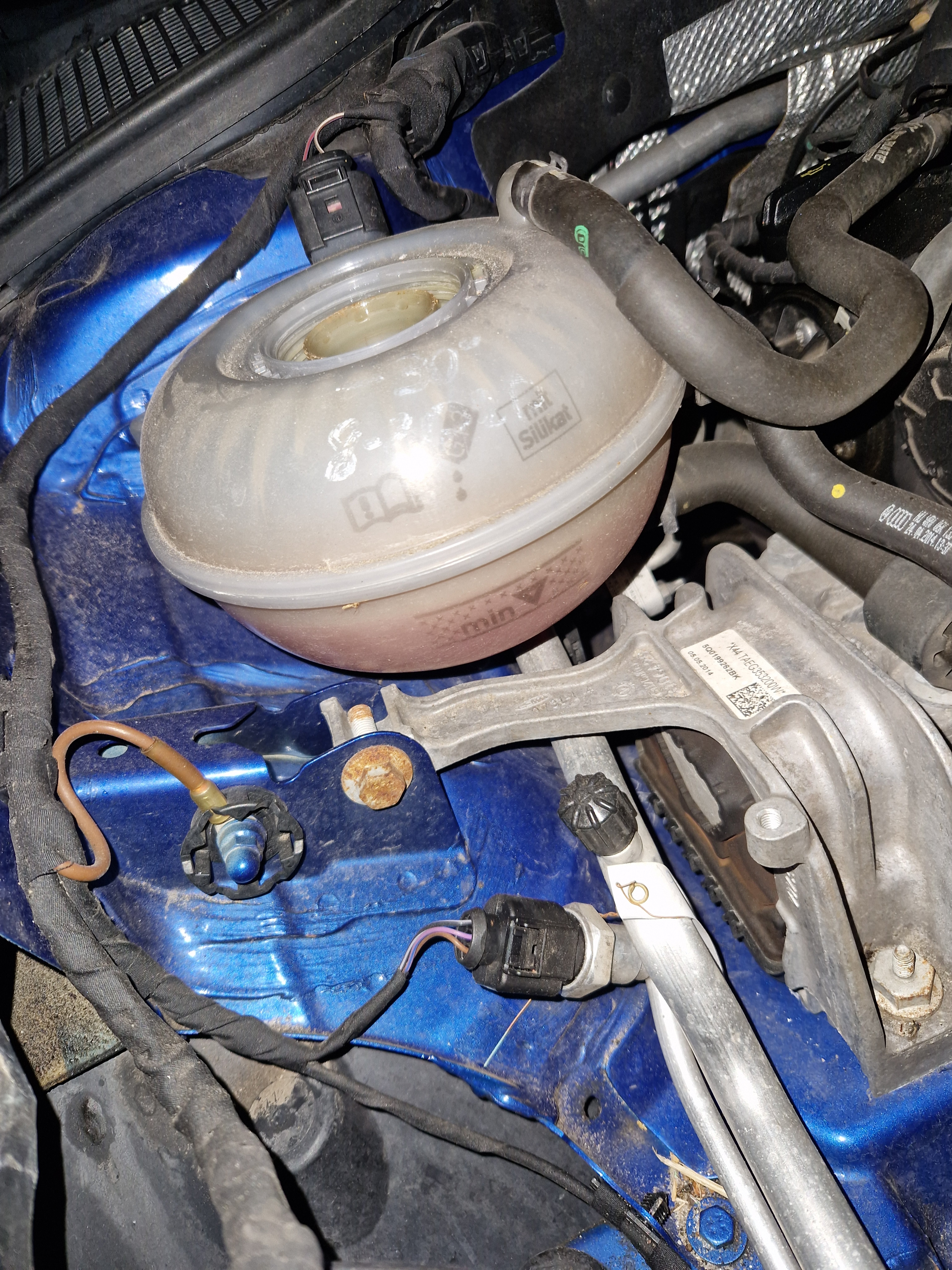

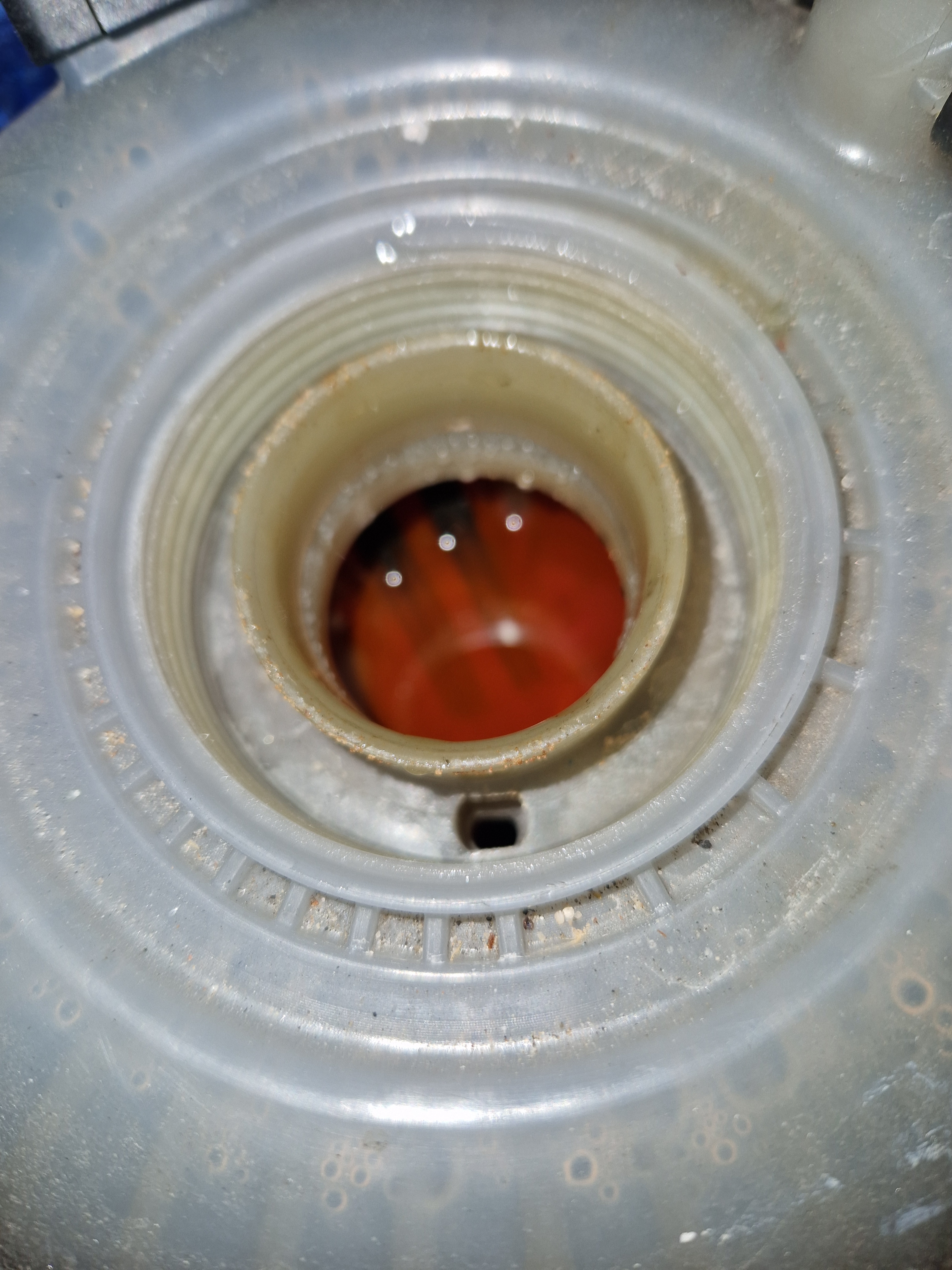

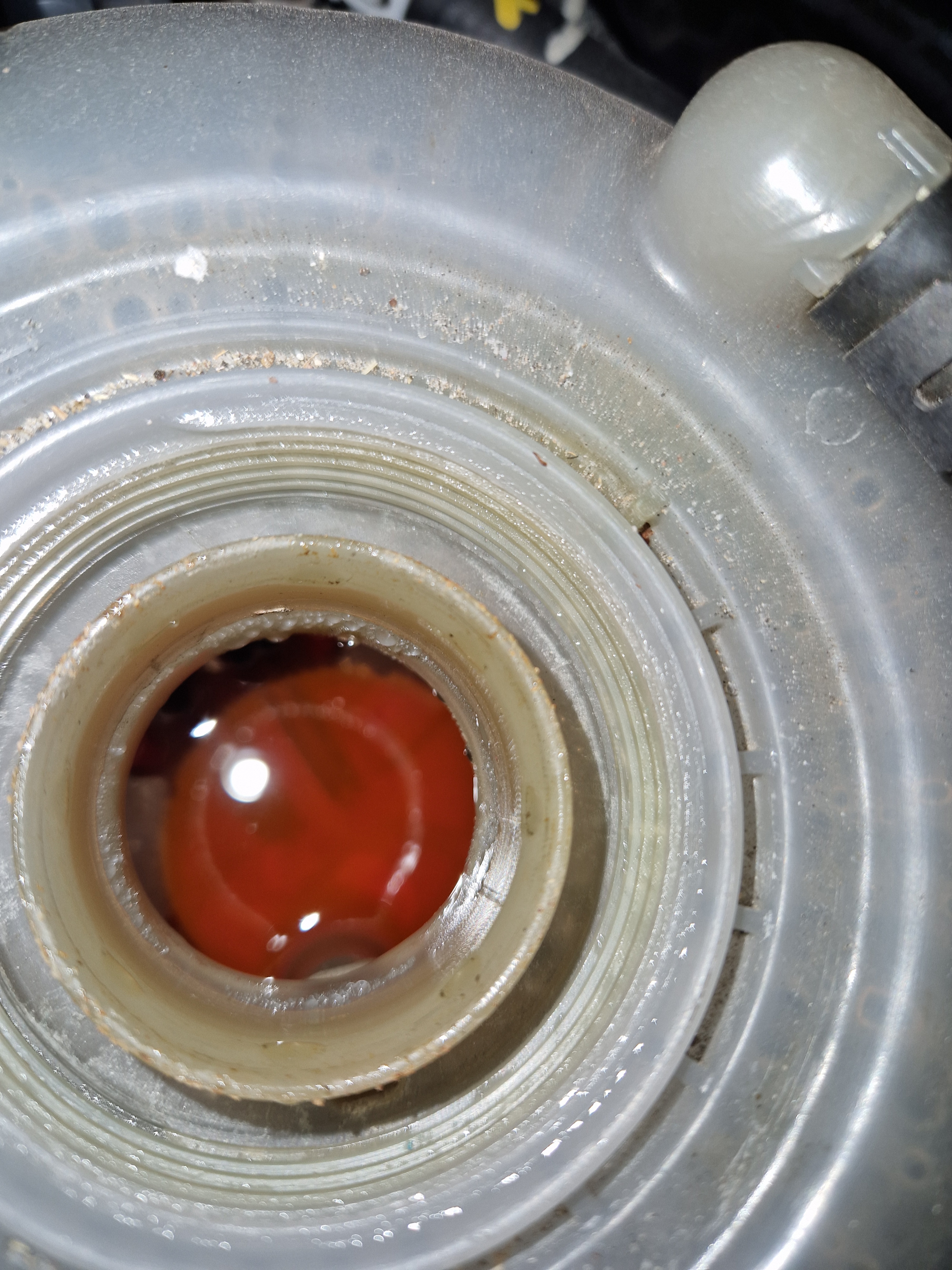

  7. Hi friend. First of all thank you so much for taking your time for answer my questions so good. I checked my header tank to see if the silica is exploded. But i cannot see it. The coolant color look very suspicious. I will upload some photo of it to. How can i know if it is exploded? If it is exploded? Should we flush thw system with this special cleaning product from VW before chaging anything? Or Should we change the header tank and more before flushing? Hope you understand what i mean. And is 5L og this cleaning product enough? I saw several videoclips where people change the heat radiator under the console. Is it necessary? And for my abs problem i think you are right with the abs master cylinder. But to be sure can we check it in a special way ? It is this one for my car right ? Master cylinder : https://m.autodoc.dk/bosch/15086477 Photos of my header tank I could not upload the photos in one so i upload it like this.
