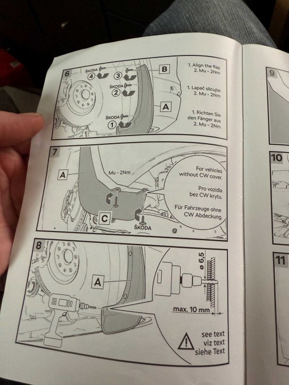

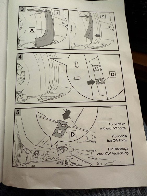

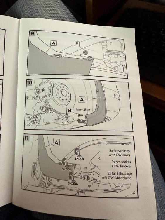

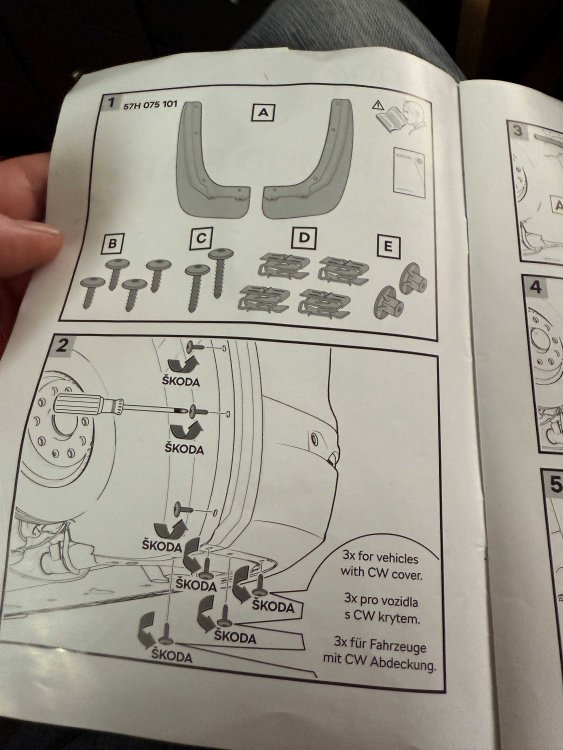

  1. HI, anyone fitted rear mud flaps to their MK2. I have some and cannot seem to work out how to get them to fit, fitted the fronts no problem. I didn't have an issue fitting some to my MK1 but cannot work out how 2 of the fasteners fit. They are the top fastener you need a new clip for, not sure where the clip goes and do you need to drill a hole for it, and the one on the bottom row you need to drill the hole for, cannot work out how to fit the nut , Item E for it. Any help much appreciated Bill
