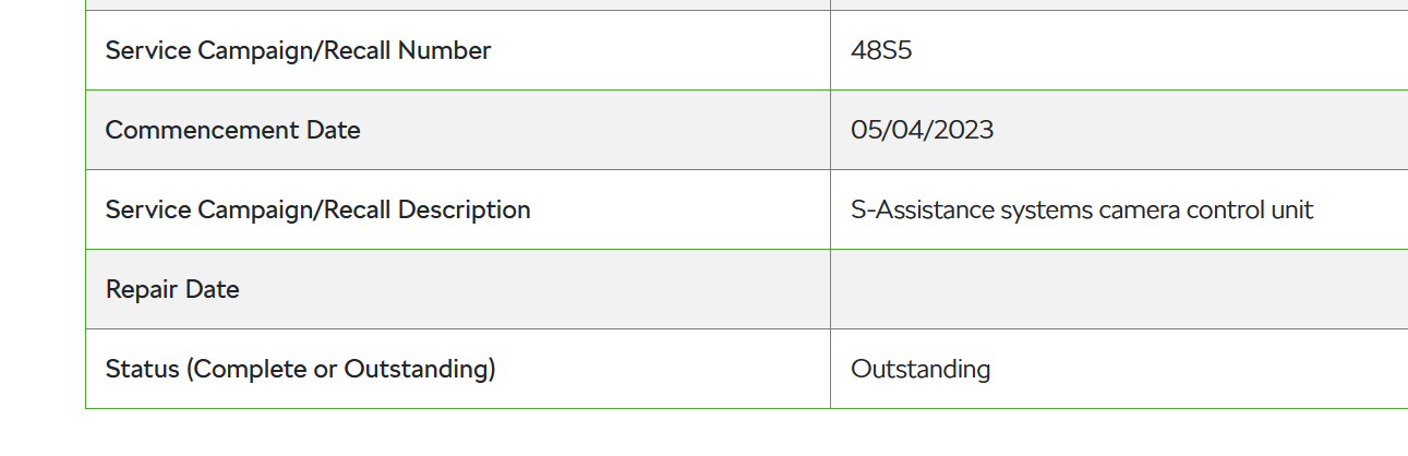

My (now EX) dealership sat on the issue for nearly a year.  Only resolved when they wanted to service my car again (no thanks until this issue is sorted).
On the Karoq forum I found a link to the recall information .
This came up for my car.
Now bringing it up with another dealer to see if I can get it resolved, but does suggest a software solution.........(maybe).
VIN Checker | ŠKODA Australia (skoda.com.au)
