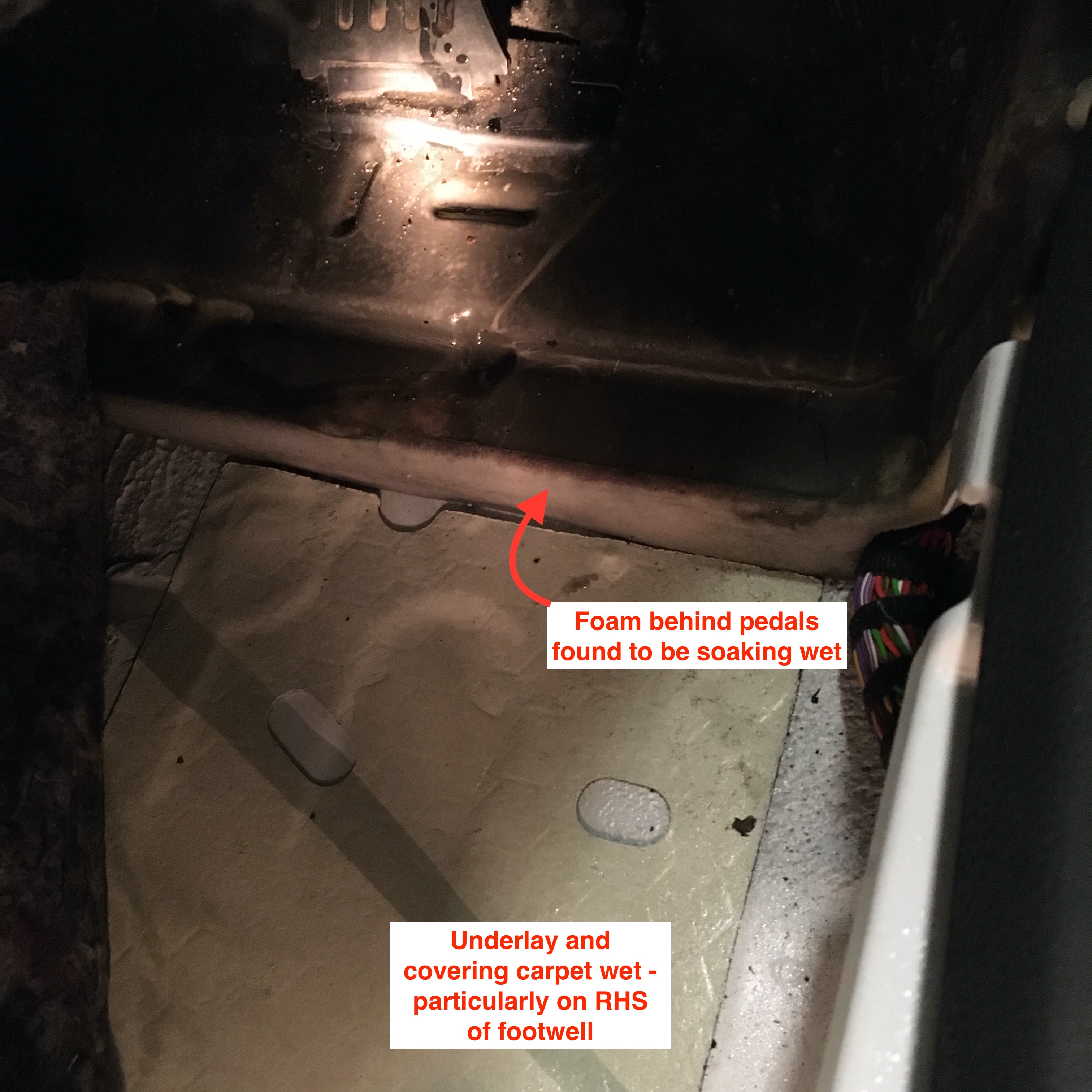

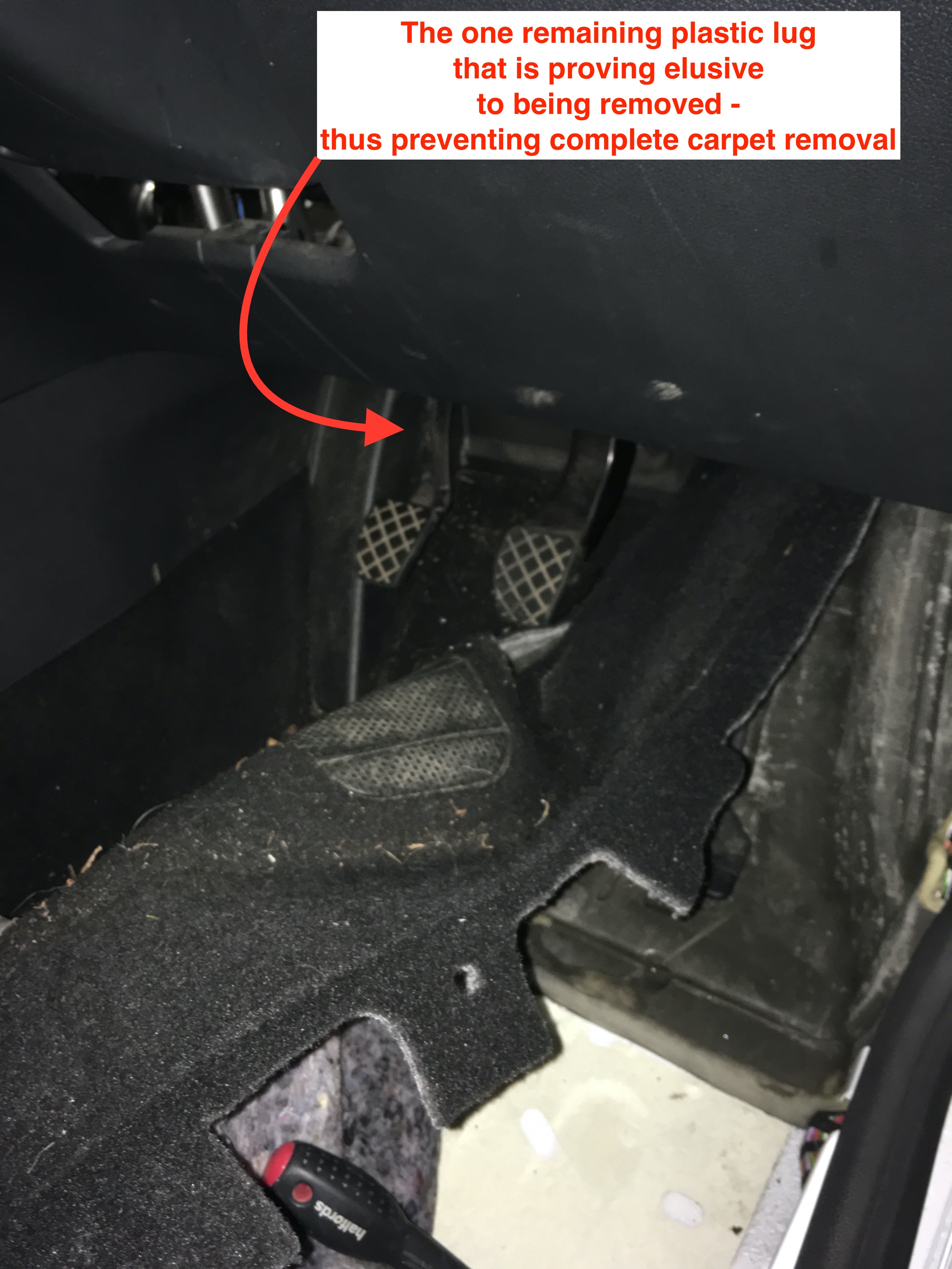

  3. Thank you United232 for your excellent, clear and helpful original 2018 report. I have bought some essential tools! You have given me the courage to DIY this water ingress repair :-) I now have my '64 Yeti in my garage (only just !), the driver's seat removed and all bolts and plugs removed (bar one) in order to dry out carpet, underlay and foam. To recap, there is no evidence (that I can see) of water ingress through the panoramic sun roof.. This was replaced 18 months ago by Skoda for just that issue. No further issues with water ingress until a few weeks ago - same place, driver's footwell, OFS. This time the roof lining is dry, and no drops of water can be seen where before it was obvious. The drain tubes are clear of any blockages, draining water efficiently from a bottle administered into the front cassette corners. So, Question 1: How is the foam beneath the pedals getting soaked? See Image 1: Image 1. Question 2: How is this remaining plastic plug to be removed? See Image 2: Image 2. To fully dry out the carpet, etc, I really should remove it all. So, in summary, I would be grateful for any help, from your good self, United232, or indeed from the noble folk that make this Forum such a breath of fresh air! Many thanks !

  5. A good plan Bexhillian and worth carrying out ! As explained though in an earlier reply I'm tending to the conclusion that the water ingress is seeping INTO the footwell and not dropping ONTO it from above. We'll see (eventually) :-)
  6. Thank you Martinb100 for your reply. Yep, pretty sure it's Not from the sunroof. I've checked inside the roof lining which is dry. [18 months ago there was evidence of leakage from the drain tube junction in the roof lining. Additionally there were tell-tale signs beneath this with water drops on the dashboard and seating. Following much persistence with videos/photographic evidence Skoda renewed the cassette as a goodwill gesture and I paid for 4 new drain tubes. ] We press on... :-)

  8. Thank you Expatman. Appreciate your ongoing interest. The 'bulkhead vent well drains' have been cleared earlier this month when some leafage and detritus was removed. Additionally, the water is collecting in the driver's side only...

  13. Thanks Expatman... I had the drain tubes blown through with an air line recently to rule out blockages. Today I've poured a full pint of water down each of the drain holes at the front of the sunroof cassette and the water has easily drained through the A-pillar grommet, finishing with a characteristic slurp! Are there any other potential points of entry into the driver's footwell?
