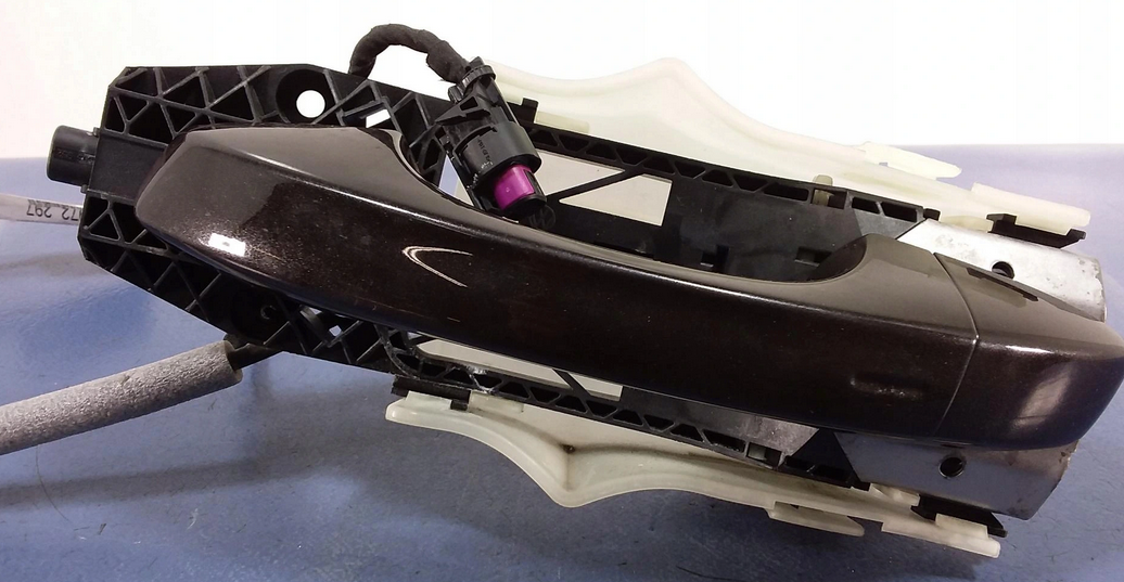

  3. Hi, I was trying to find it, but I gave up. Does anyone has wiring diagram for door modules. My module is: Driver Part No SW: 5Q4 959 593 K HW: 5Q4 959 593 K Component: TSG FS 007 0485 rear Subsystem 1 - Part No SW: 5Q0 959 407 A HW: 5Q0 959 163 Component: FOND_FHSG_DRV 007 0010 Passenger Part No SW: 5Q4 959 592 K HW: 5Q4 959 592 K Component: TSG BFS 007 0485 rear Subsystem 1 - Part No SW: 5Q0 959 408 A HW: 5Q0 959 164 Component: FOND_FHSG_PSG 007 0010 I want to connect kessy handle antena, warning lights and lighting od interior handle. I will be thankful for prividing some schematics, pin-out, whatever...

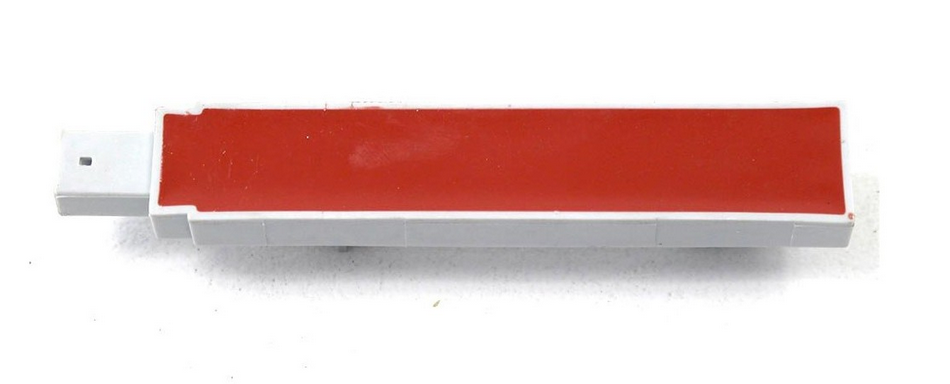

  4. Hi I just want to refresh a bit this topic. As I mentioned before I want to add kessy in driver door and tailgate (don't confuse with touch less opening - I want to open door by touch, but not using key). It seems It is possble to buy handle with antena: and antena to tailgate + wire harness: I have few questions: 1. I need to know where to connect them to door and tailgate drivers (pin numbers). 2. Additionally maybe someone knows where is antena placed in tailgate ? Where it is mounted ? 3. Is it enough to code it in door / tailgate drivers only or somewhere else also. (I have keyless start already) ?
  5. Hi I'm suffering lack of keyless access especially on driver door and tailgate. Has anyone manual how to add it ? Is it enought to add only handle with antenna to door and antenna to tailgate and do some coding or adaptation ?
