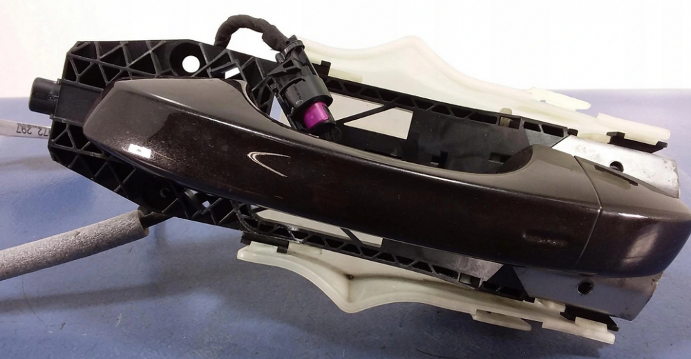

Hi I just want to refresh a bit this topic. As I mentioned before I want to add kessy in driver door and tailgate (don't confuse with touch less opening - I want to open door by touch, but not using key). It seems It is possble to buy handle with antena: and antena to tailgate + wire harness: I have few questions: 1. I need to know where to connect them to door and tailgate drivers (pin numbers). 2. Additionally maybe someone knows where is antena placed in tailgate ? Where it is mounted ? 3. Is it enough to code it in door / tailgate drivers only or somewhere else also. (I have keyless start already) ?

Thanks mfizz, looks quite complicated, but this passat is from 2015. I'm still hoping that my car has at least electronics able to support this system. I have start engine button, so interior antenna should be already installed, I'm not sure if my door controler is able to support handles with antenna, if yes it will be only a matter of connecting such a handle or antenna to it. I will send soon my auto scan by VCDS, there are all controlers listed. Maybe somebody can check...
