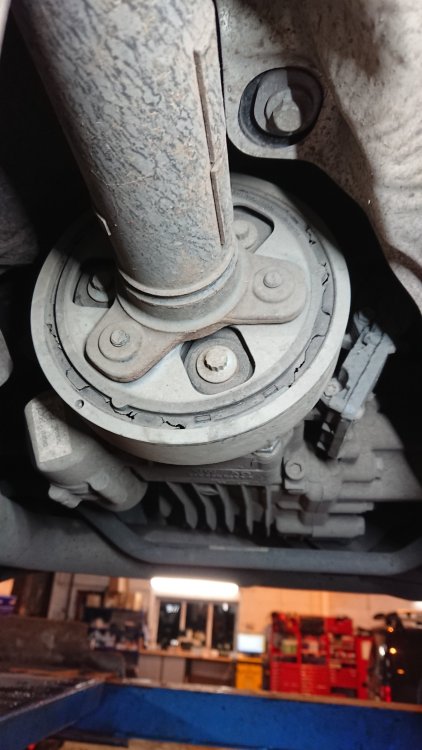

Car is back from my local garage and they couldn't find anything wrong with it. The mechanic said the prop shaft coupler looks fine, and i had a look too and it does look ok (photo attached). There are some tears but otherwise looks fine. It's booked in for a haldex service in Jan. Hopefully that will resolve it. For the past two weeks the car has been driving fine with no juddering or issues moving from stationary.

Its done 113K miles.

Right-o, in that case I'll pop into my local garage this week and see if they'll jack it up to have a quick look. Haldex oil and filter was last done in Jan 2020, just after i bought the car. I've done about 20K miles since then.
