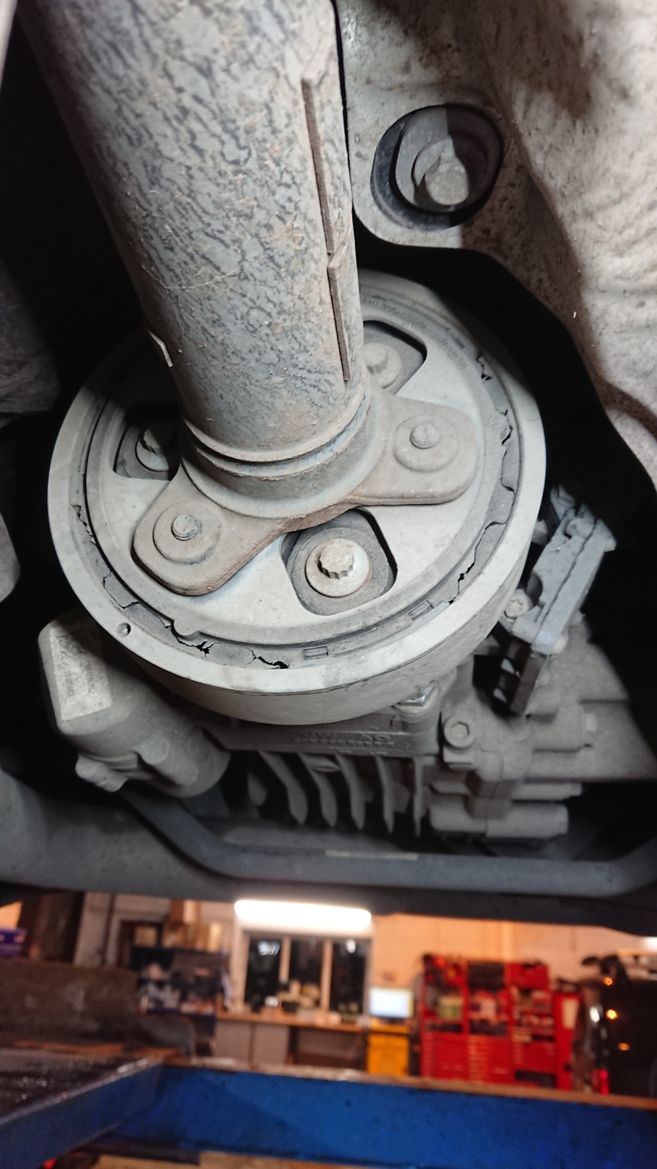

Octavia Scout 2015 - vibration at high speed and juddering on acceleration, when heavily loaded
Car is back from my local garage and they couldn't find anything wrong with it. The mechanic said the prop shaft coupler looks fine, and i had a look too and it does look ok (photo attached). There are some tears but otherwise looks fine. It's booked in for a haldex service in Jan. Hopefully that will resolve it. For the past two weeks the car has been driving fine with no juddering or issues moving from stationary.
