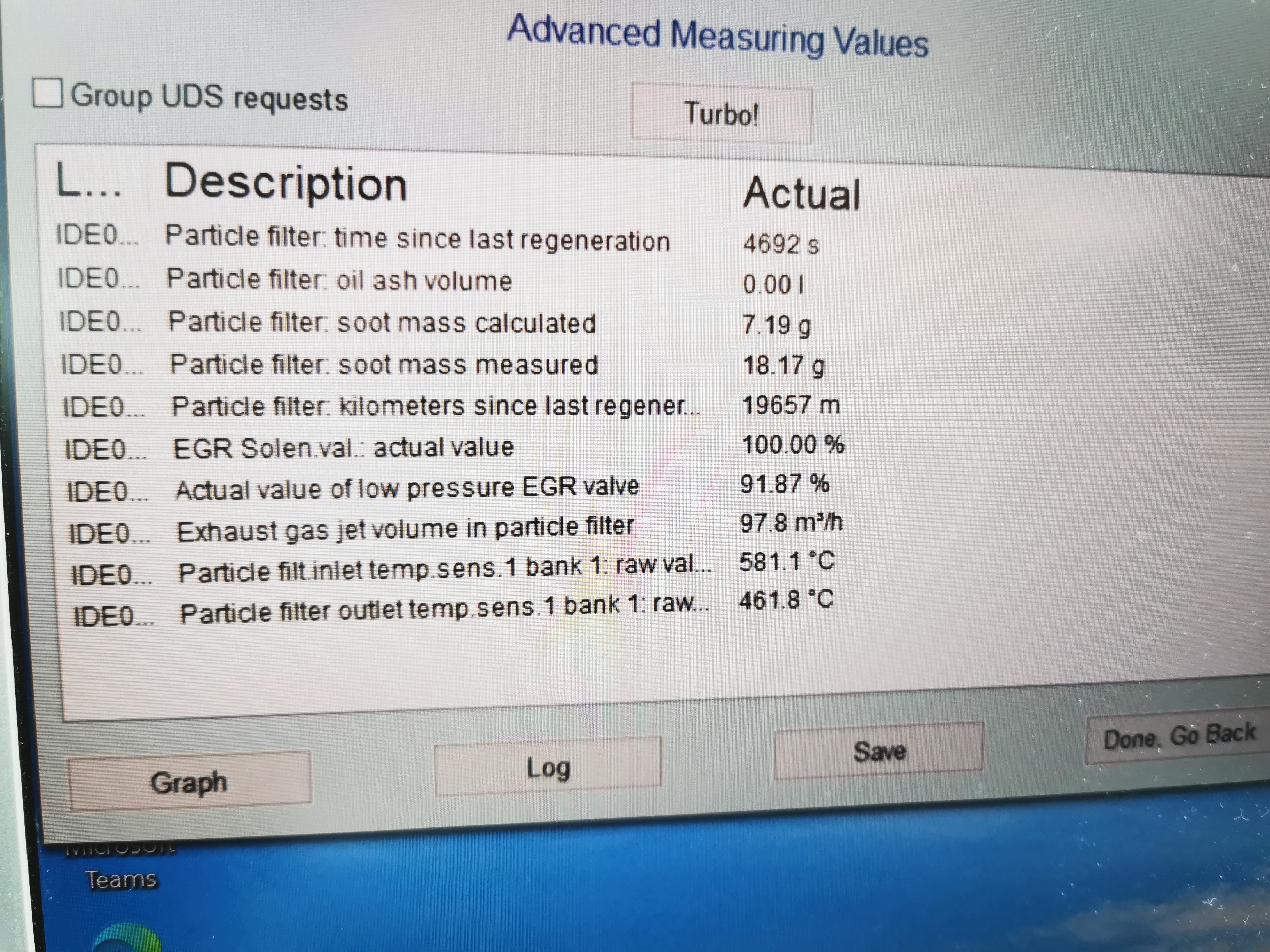

That value ( oil ash volume) hasnt changed since i have the car. Tested a vw tiguan 2020 2.0 tdi 150 twice and first time vcds mesured the oil ash volume 3.8665427 and the second time 0.00. I thing in certain conditions that part is showned... I don't know. My car has 227.000 km with full service history.

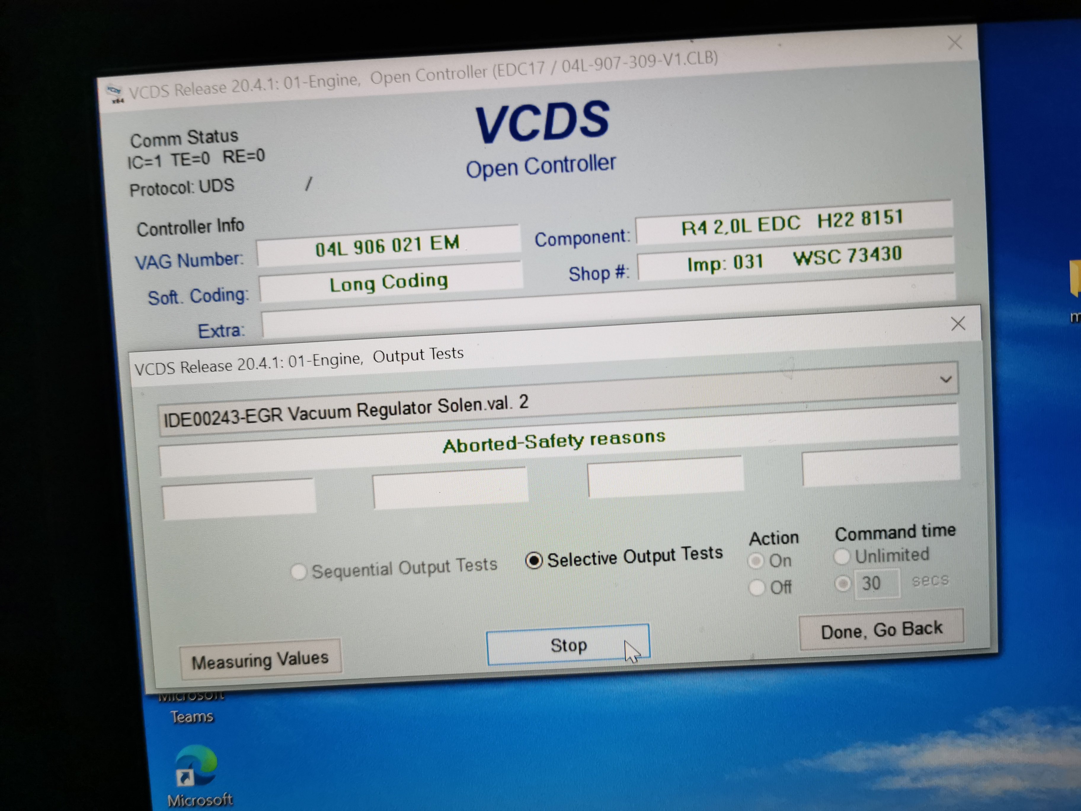

i did. the car has 2 egrs. one is low pressure and the other high pressure. the low pressures test was sucsesfull and the othe u can see the result in the upper picture.

Al regens stops each time at 0.50g,

hello i have a octavia 3 2.0 tdi vrs 2015 and the car have some problems... It's doing lots of regens. For example i go for groceries (5km road) the car is in regeneration... I always wait the car to finish the regen. When i return home the car is in regen again... I bought the car 2 weeks ago. I have a vcds and no errors. The regen starts at 24g. No oil lose... I' ve noticed something strange with the egr vacuum regulator solen.val.2 when i try to do an output test with vcds (aborted safety - reasons) The actual value of the egr solen val. is always 100% The value of the low pressure egr valve fluctuates depending of the acceleration, and the test is ok with it. In 2 weeks i drove it for aprox 3000 km, and first thing i've changed the motor oil... Now with vcds the oil has poor quality. Did anyone had this issue? Any advices? I went at the loval dealer and told me the car is fine ðŸ˜
