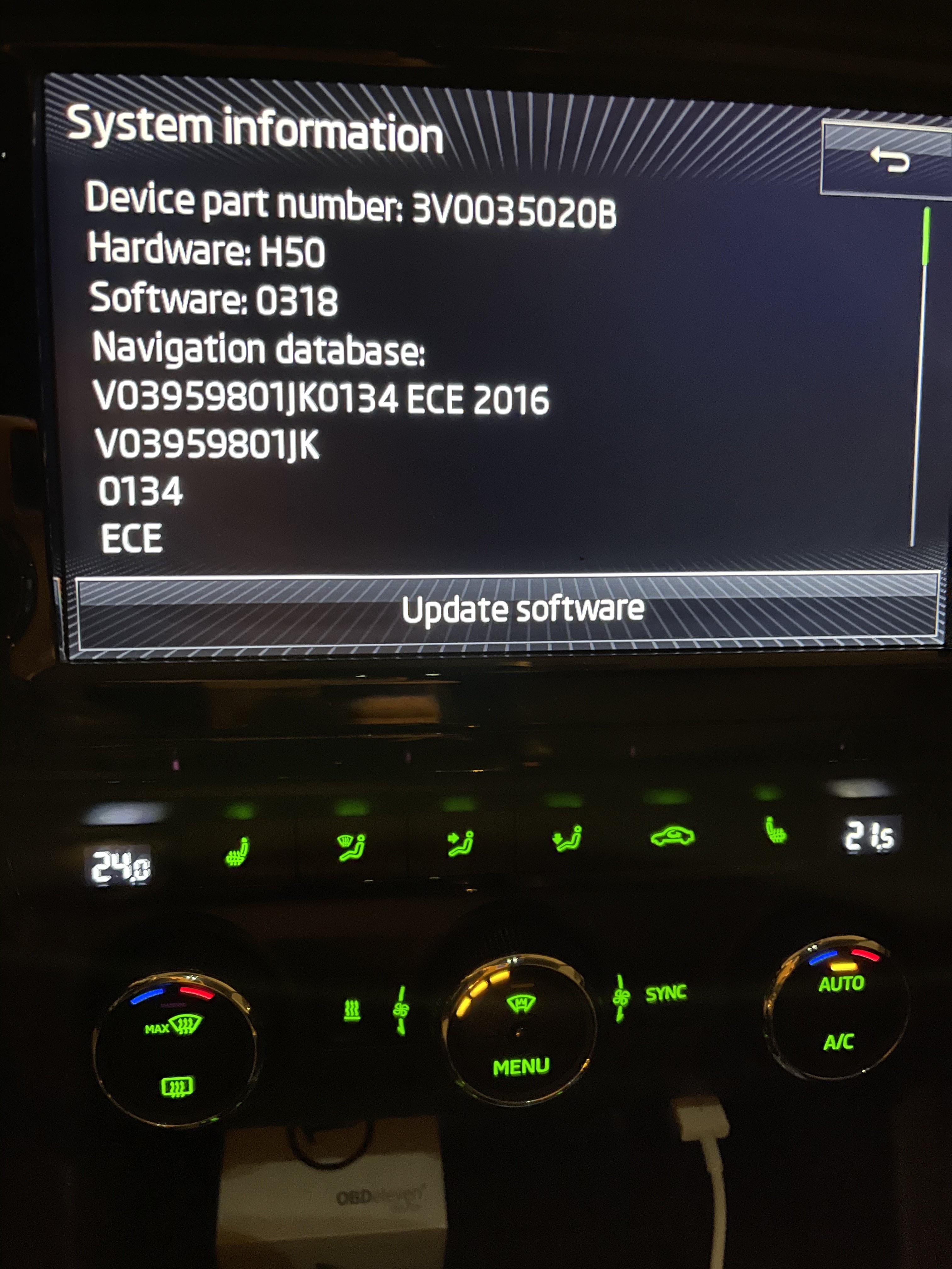

  2. Hi guys, I have a question regarding this firmware update. A friend of mine did something similar for a bolero head unit and the main reason he did the update was because he was told that the sound quality would be greatly improved. And so it did. I asked around and from the feedback I received, if I do this update, it will greatly improve the sound quality of my Columbus Mib2 to even sound better that the basic Canton unit. It's something regarding some parameters update or so. Do you know from your experience if these 2 aspects (firmware update and sound quality) are related?

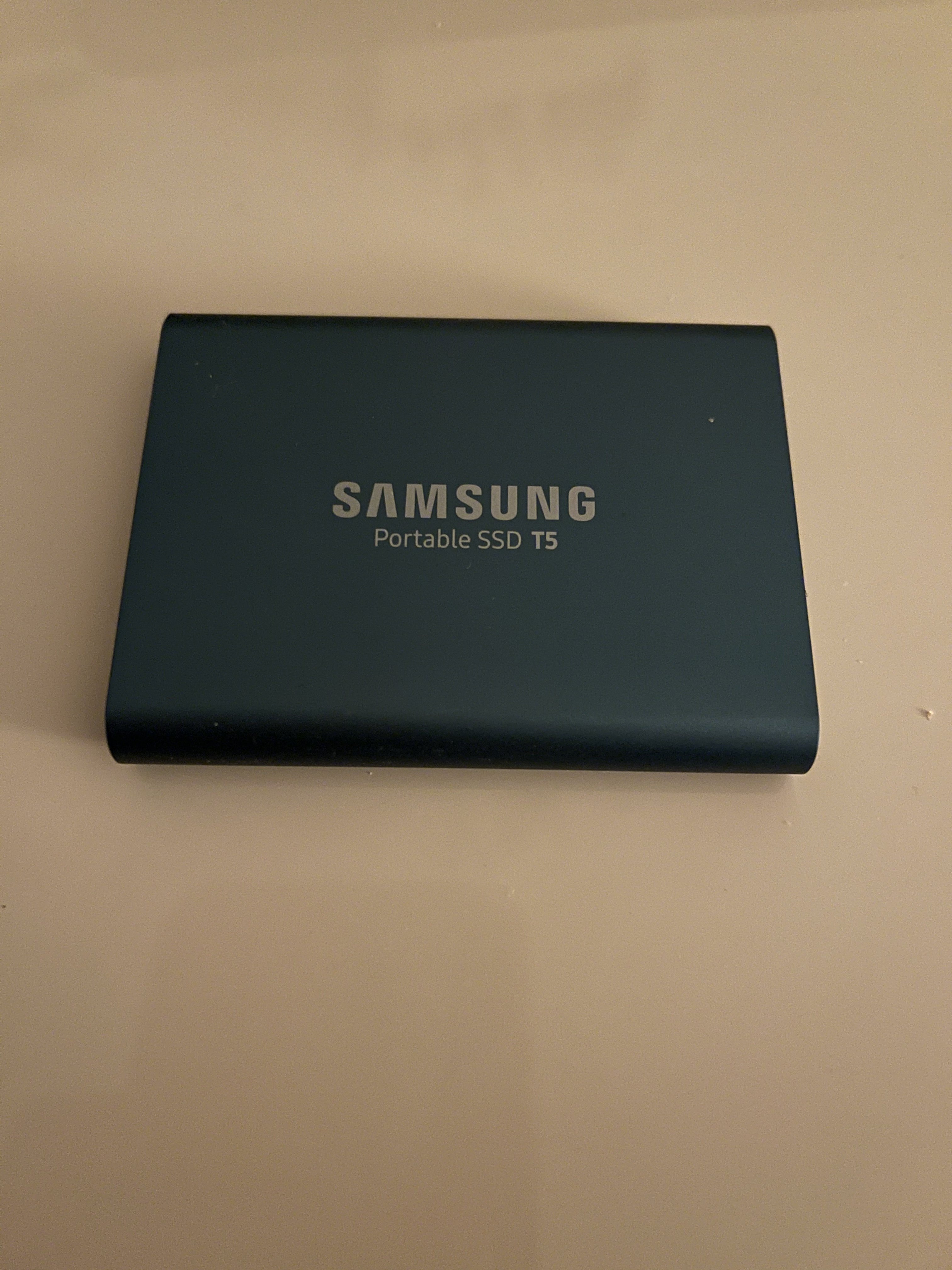

  3. Yes, 128GB is more than enough, I think I'm going to use this setup after all.
  4. What's the maximum capacity for an SD card that the unit will accept? I just updated the navigation using a 32gb card, any higher will still work?

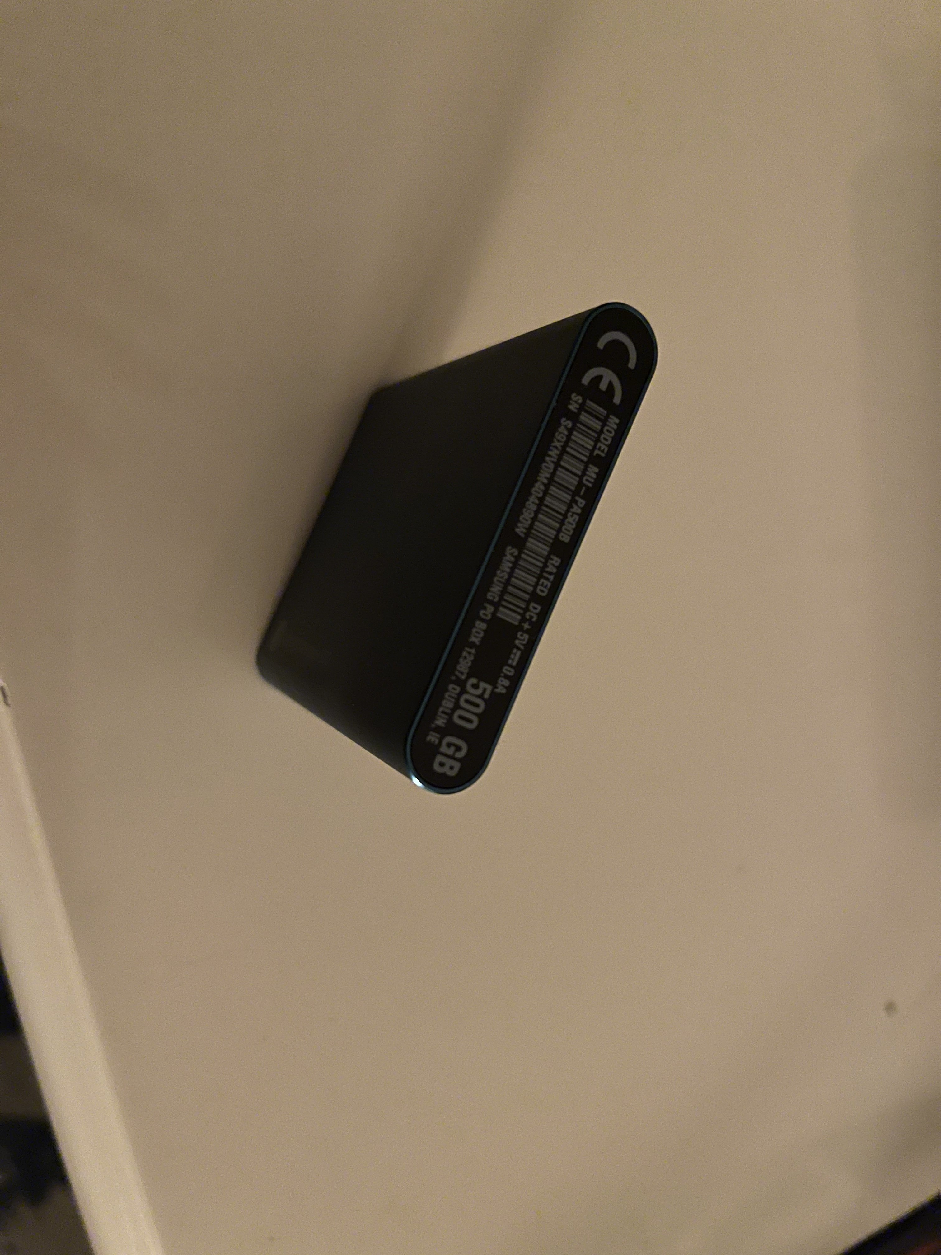

  6. Hey Octavia 3 owners. Any ideas if I can successfully connect and play media from this 500 GB SSD I have from Samsung? Sadly I won't be able to benefit the carplay apps in the same time, but still I would like to know if possible. Thanks for your opinion

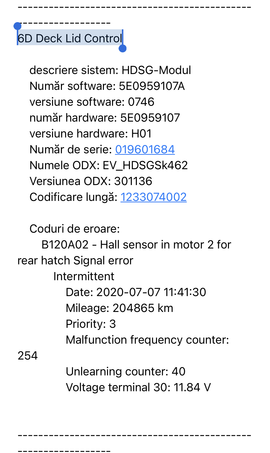

  7. Frank, very good observation. With kessy, key ÃŪn my pocket, pressning the boot Lid button, the trunk opens normally, without any issues what so ever. I activated from obd11 the trunk closing from the key button and it also works flawlessly. The only problem remains while trying to open from the key button.

  10. I even have an error ÃŪn obd11. Any ideas?

  12. Hi guys, I didn't want to open a new topic since my query is somehow also regarding the trunk / boot lid. How do you guys open the trunk using the remote control? If I press once short, nothing happens. If I press once longthe lid opens, maybe 10 cm and then closes afterwards and I have to keep pressing a second time to have it opened full. I don't think if this is the way to open it, am I missing something, or its a faulty unit somewhere? I did a video on it for you to see: Thank you in advance for your opinion
  13. Yes, most probably. Meanwhile, I contacted the Skoda dealer and they've told me that there was an issue at some point with these buttons and they were replaced under the warranty. They told me I have to bring the car and they will replace it with another button. I feel better now, knowing that this is not a single user issue, so to say.
