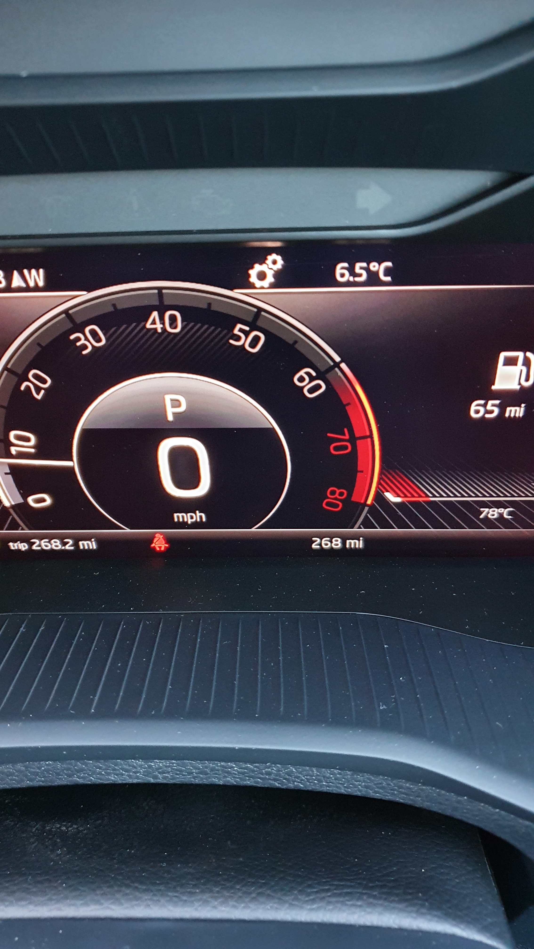

  9. Good evening All, probably something and nothing but does anyone know plse what that symbol in the pic means? I can only think it resembles 2 cogs of a wheel (1 smaller than other)! I've scoured tinterweb but nowt coming up.. As I said, probably nothing but thought I'd check with you wise folk first.. Cheers Andrew
