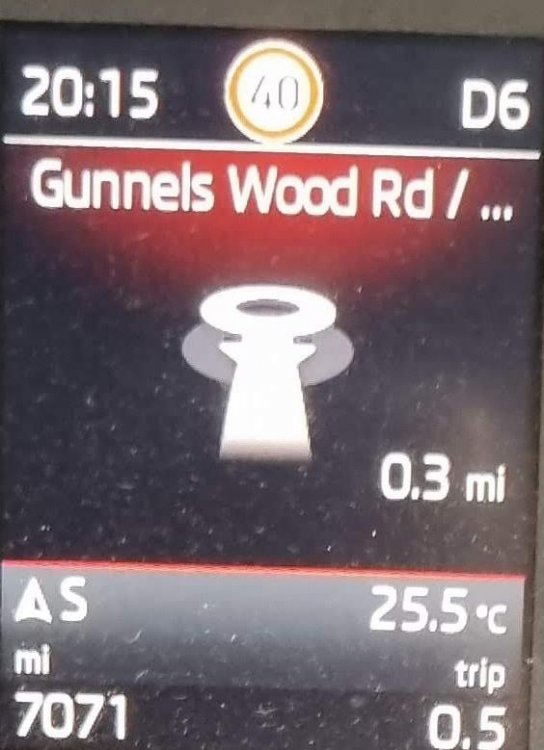

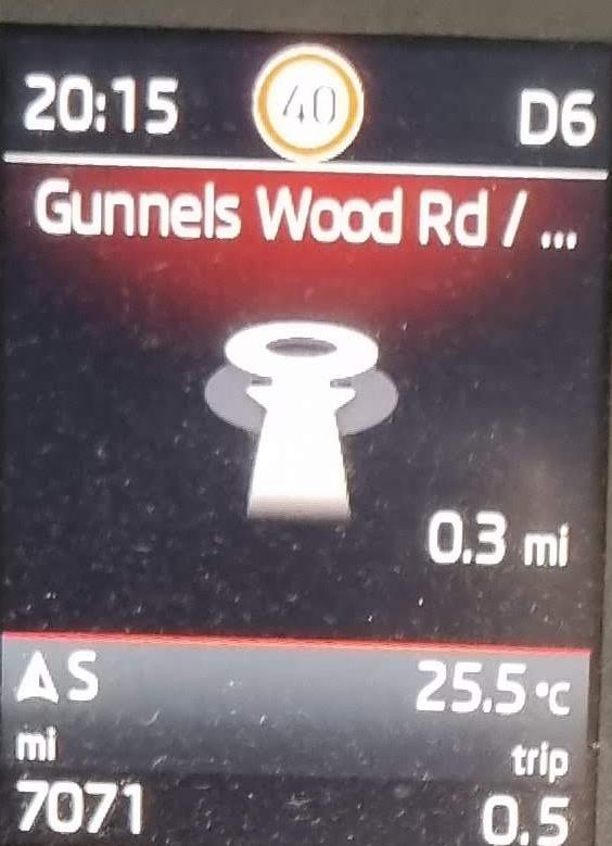

When using Android Auto and the Columbus system in my MY21 Kodiak to navigate with Google Maps, the maxidot display has started displaying a strange "next turn" instruction when the next junction is a roundabout. Until a couple of weeks ago it had worked fine for months with roundabout junctions displayed correctly but I'm guessing a Google Maps update has broken things. Now, every time the next junction is a roundabout I get the symbol on the attached displayed. If I uninstall all Google Maps updates and revert to the version that came pre-installed on my Galaxy S21 then the roundabout exit is displayed correctly, but as soon as I update maps to the latest version then the maxidot starts playing up again. Anyone else seen this, or know of a fix? Other navigation instructions on the maxidot are fine otherwise, it's just anything involving a roundabout that has an issue.
