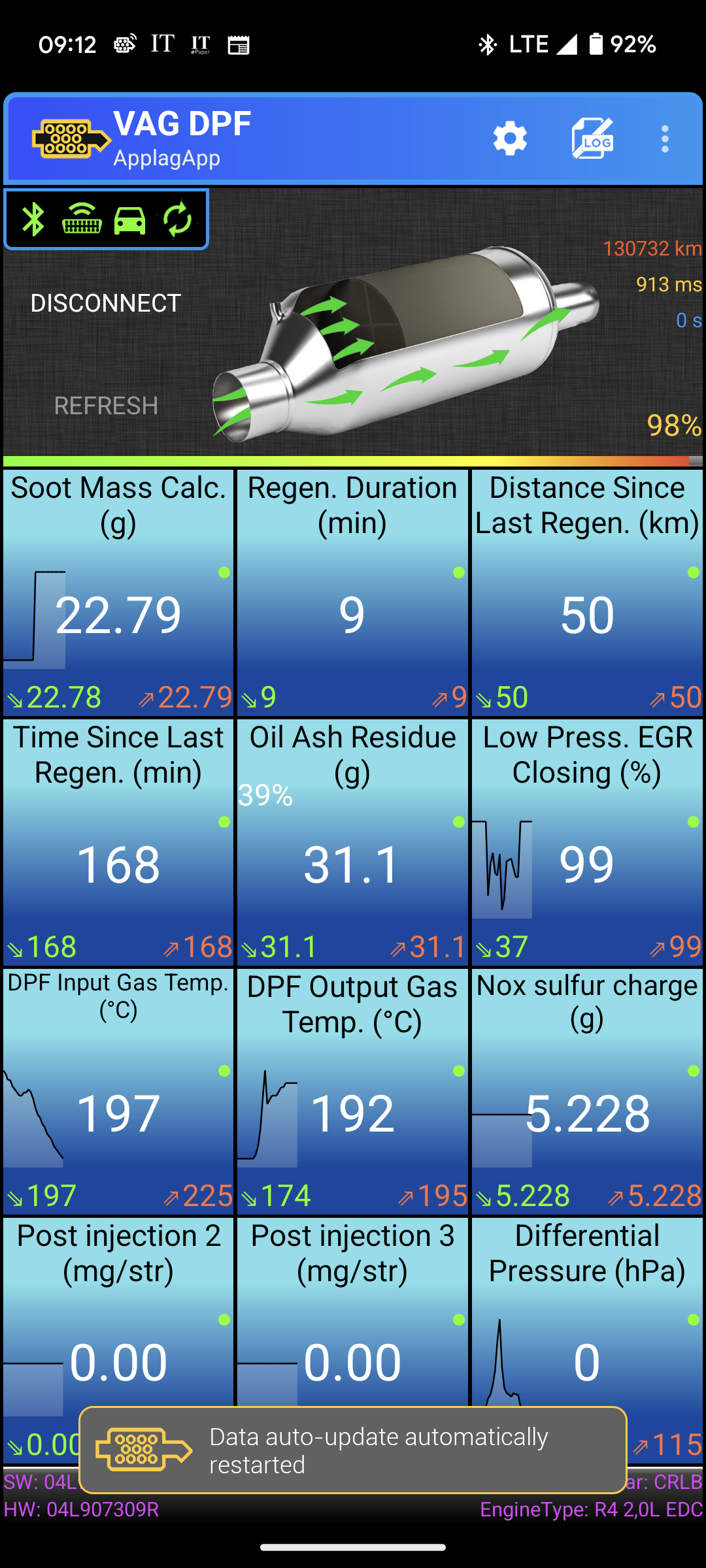

  11. Another update I did a 400km trip and it just re gened once at the start and then the day after on a short trip. There seems to be a pattern when doing a few short trips that vagdpf reports that its @c.50% full and then it just jumps up to 100% and regens. I'm wondering if that might be a sensor? Also I feel that with a similar amount of driving as before it's reporting higher amounts of soot. Any suggestions would be appreciated

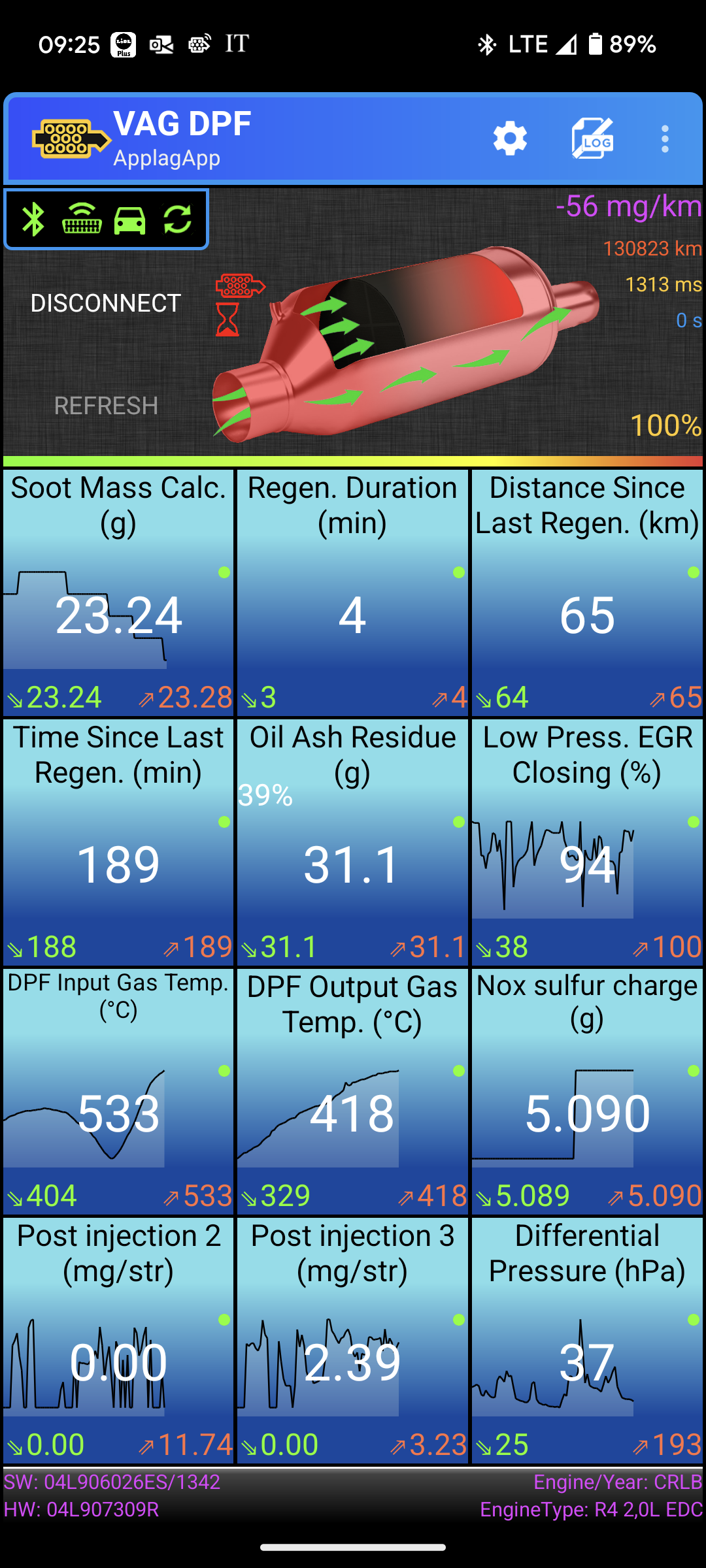

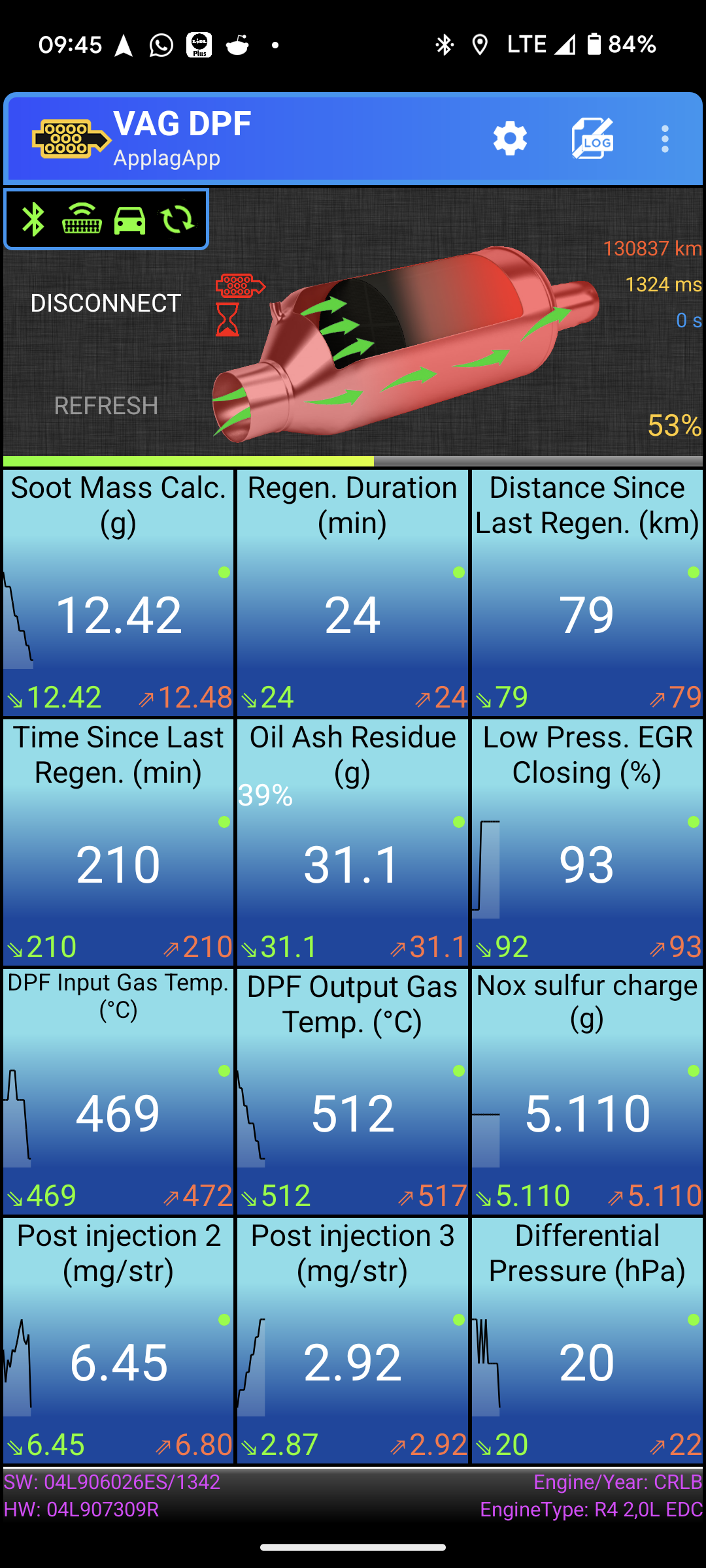

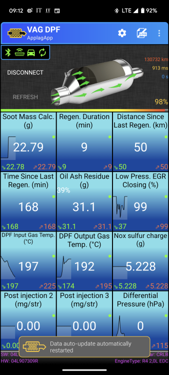

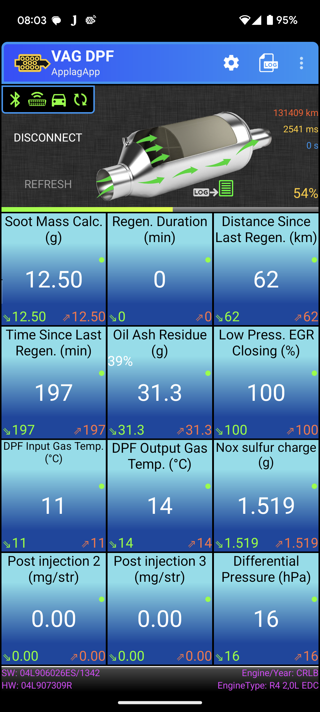

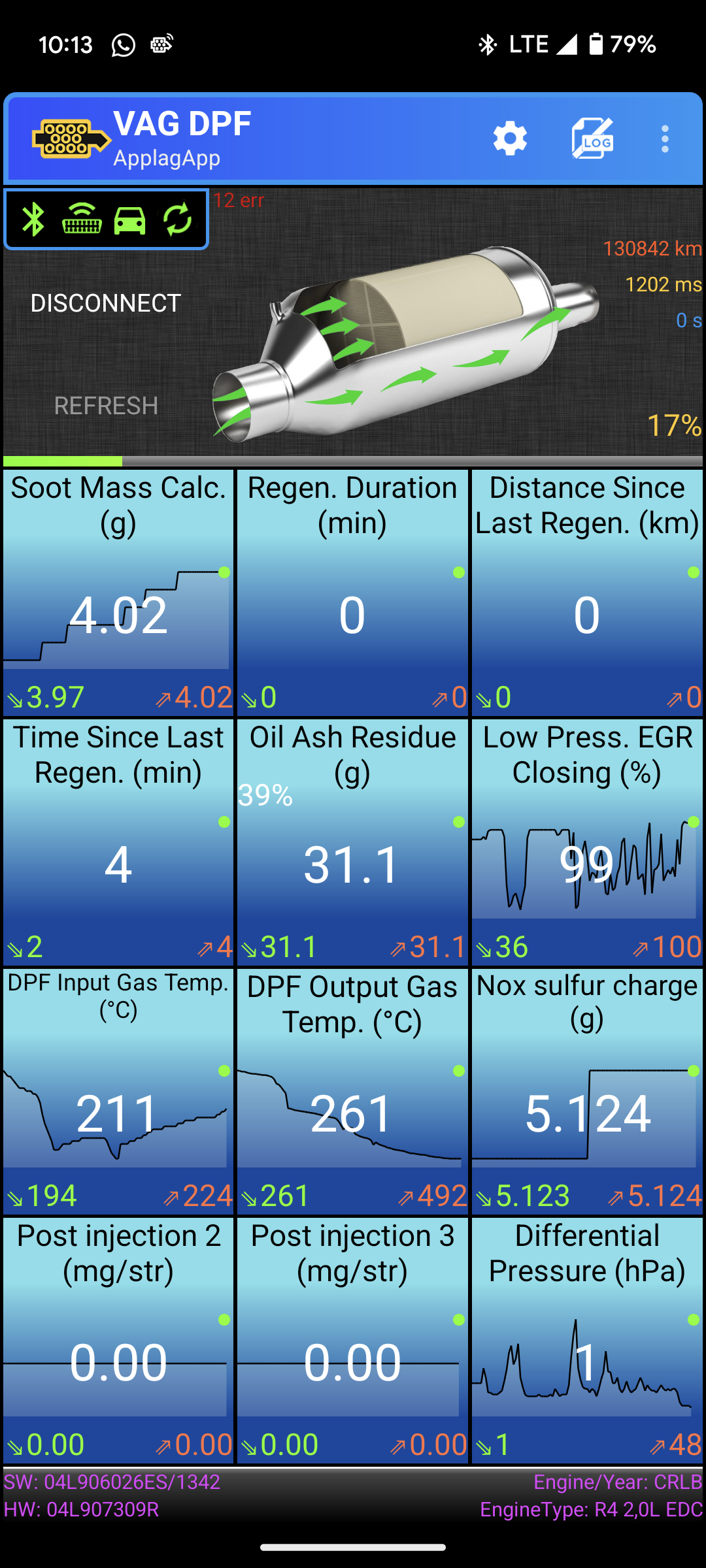

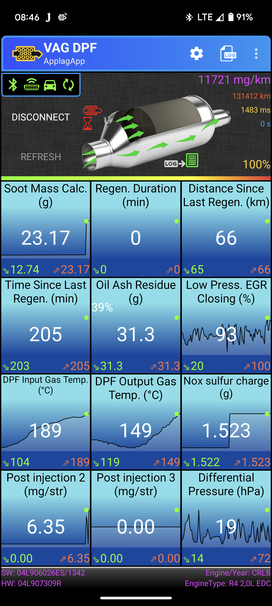

  13. Iv do a few 20-30km motorway trips, but it was after a regen. I'm going to take it on a 400km spin at the weekend and I picked up some ecomotive drive clean so I'll see how that goes. Regens are taking 45mins which is a bit of a pain. Some screenshots from this mornings one
  14. Just driving a bit longer or in some cases letting it idle and Keeping an eye on vag dpf. I was thinking 39% wouldnt be an issue. I'm wondering would a few hours motorway driving and/or some dpf cleaning fuel additive help?
