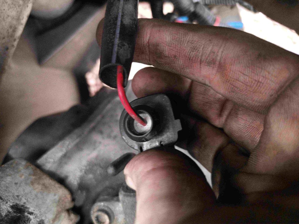

  1. Wire and plug look good? Braided copper wire and contacts on top of solonoid are showing corrosion and fraying to the braided wire. Am I likley to see much benefit/ difference between a Lucas and a RTX starter, (both BME fitment)? Circa £20 difference at Halfords.

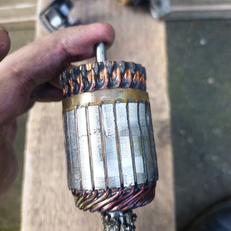

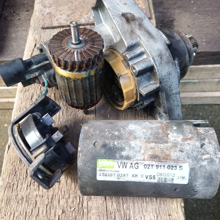

  2. Well a lot of swearing later and the starter is off. As the nuts looked a damn sight easier to undo, thought I'd have it apart out of curiosity. Still some meat on the brushes. But commutator looks a bit oddly worn to me, but I'm neight an electrician nor a mechanic.

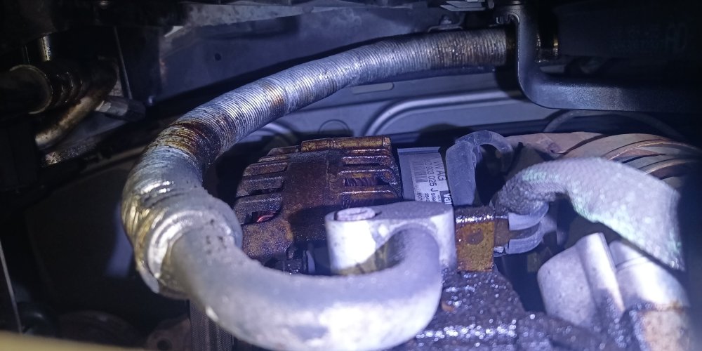

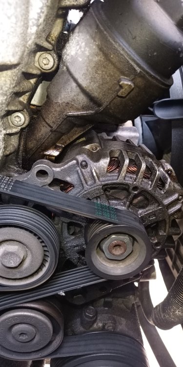

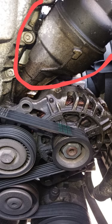

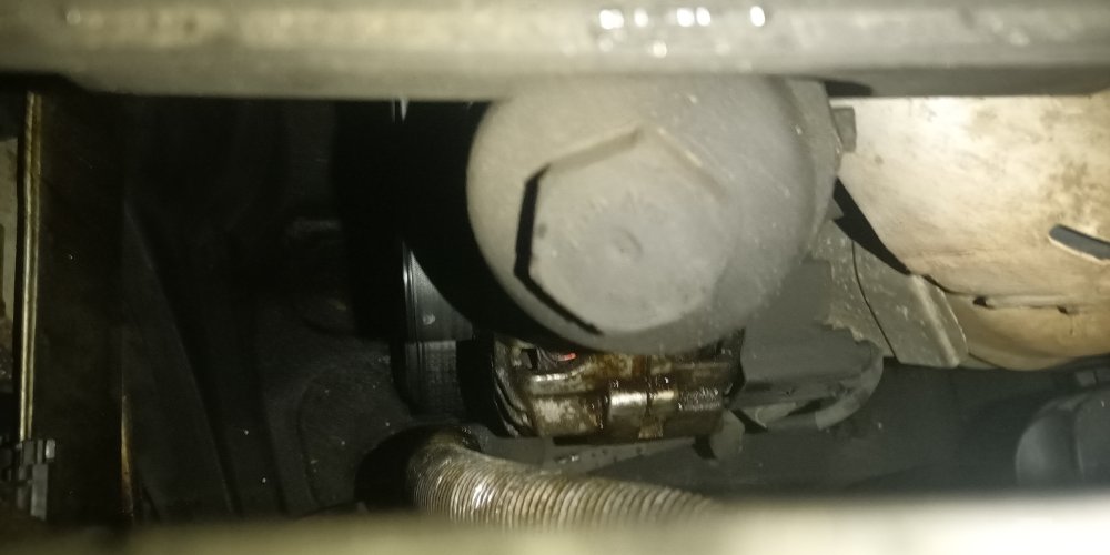

  4. Hi JR, thanks for your reply. I did top her up with oil as she seemed a bit low about a month ago. But no oil change and, nothing else has been loosened or tightened. Oil is localised to the components around the area photographed. Hadn't noticed any dripping when I'd been parked up, but the plastic tray I've taken off the bottom did have quite a lot of oil residue in, not sloshing about or a pourable quantity though. Daft question but what part am I looking at in the picture below, oil marks only appear below its black cap with a MN rating on the nut. Not sure whether it could be the source of the leak or oil has just been thrown against it.

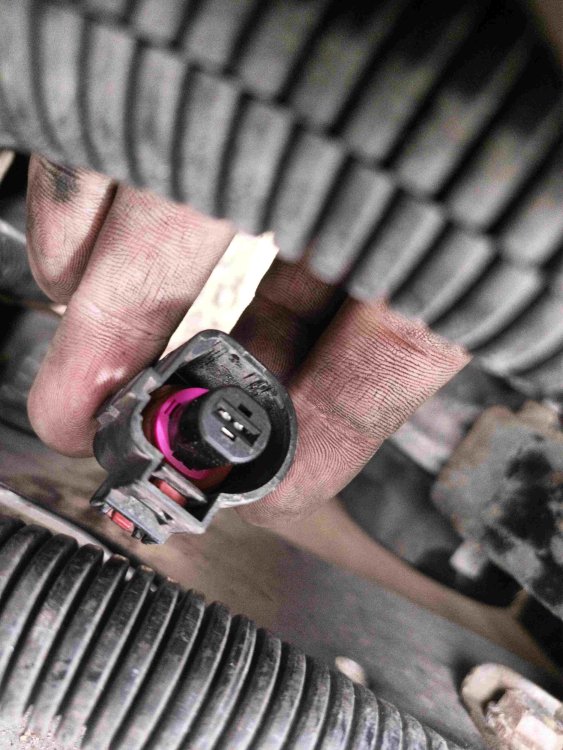

  5. Hi All, Long time lurker here usually benefiting from others existing solutions. Today however I think I've chased as far as my skill level/annoyance levels and think I need a new alternator. Has anyone had one done at a garage recently? If so can you remember the costs parts and labour? Why? Had the battery light flicker on evening, and come on solid part way through a journey the following day, eventually other warning lights came on and as I pulled into a cul-de-sac, lost power steering and ABS. Left it running, hoping the batter would recharge instead it conked out completely, couldn't even open the boot. A lucky 10 minutes walk to Halfords for new battery and adjustable spanner got me back home, with the battery light permanently on. Ended up on this thread:, (https://www.briskoda.net/forums/topic/287467-load-signal-alternator-cable/?do=findComment&comment=4357084) but unless I missed something no dice, I have continuity from the plug referred to on the brown wire back to the battery. Managed to scrape the insulation off the wires near the alternator to make a connection (no room or visibility to get multimeter clips onto male side of the plug) when running shows the same volts as across the battery: 10.7v ish, when not running a small negative voltage (0.11v.) (n.b. battery was charged up out of the vehicle to a happy 12.5v but work and back has taken some out of it) I also note the belt is turning the alternator, but it is also covered in oil source unknown. Any other advice or assistance welcomed 🤗 Also, if ive broken any forum etiquette my apologies in advance. Geoff Fabia Estate MK1 Bohemia 07
